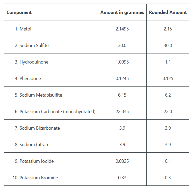

That would cost a fortune. Also note there is an important difference between a number of digits and accuracy. For example, for not very much money you can have a scale that reads to hundredths of a gram, but it will likely only be accurate to something like +/- a few tenths of a gram.
Realistically you don't need anything more than one decimal place for photographic formulas.
Now, back to debating the merits of crap processes 🙃
Yes, I round off. You can buy a very accurate scale from Amazon or other retailers for $20.
