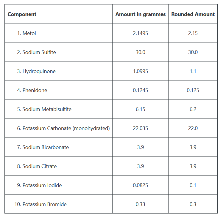

Augustus, can I also ask how much the scales cost that will weigh to 4 decimal places if that is what is required or do you round up to the nearest 3 decimal places?

For those of you who do not possess a scale that can measure so precisely, there is this rounded formula:
(Edit: I forgot Sodium Hydroxide 5g. Thank you, Caesar)

That would cost a fortune. Also note there is an important difference between a number of digits and accuracy. For example, for not very much money you can have a scale that reads to hundredths of a gram, but it will likely only be accurate to something like +/- a few tenths of a gram.
Realistically you don't need anything more than one decimal place for photographic formulas.
Most of the rounded numbers indicate that a scale which is precise to 1/10th gram would be adequate. But the rounded weights shown for phenidone and metol indicate those need to be weighed with greater precision. Am I interpreting this correctly?
Precision is always best for the sake of consistency, but I've used rounded up formulas for years without issue.
