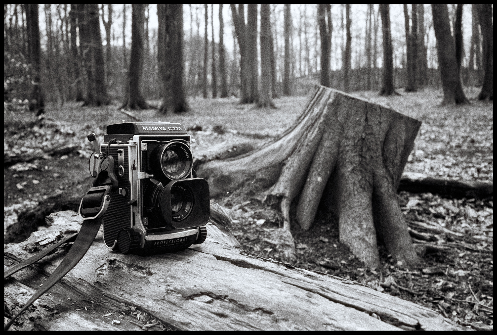

I uploaded a couple of my favorite slow pictures under the standard Gallery here.
