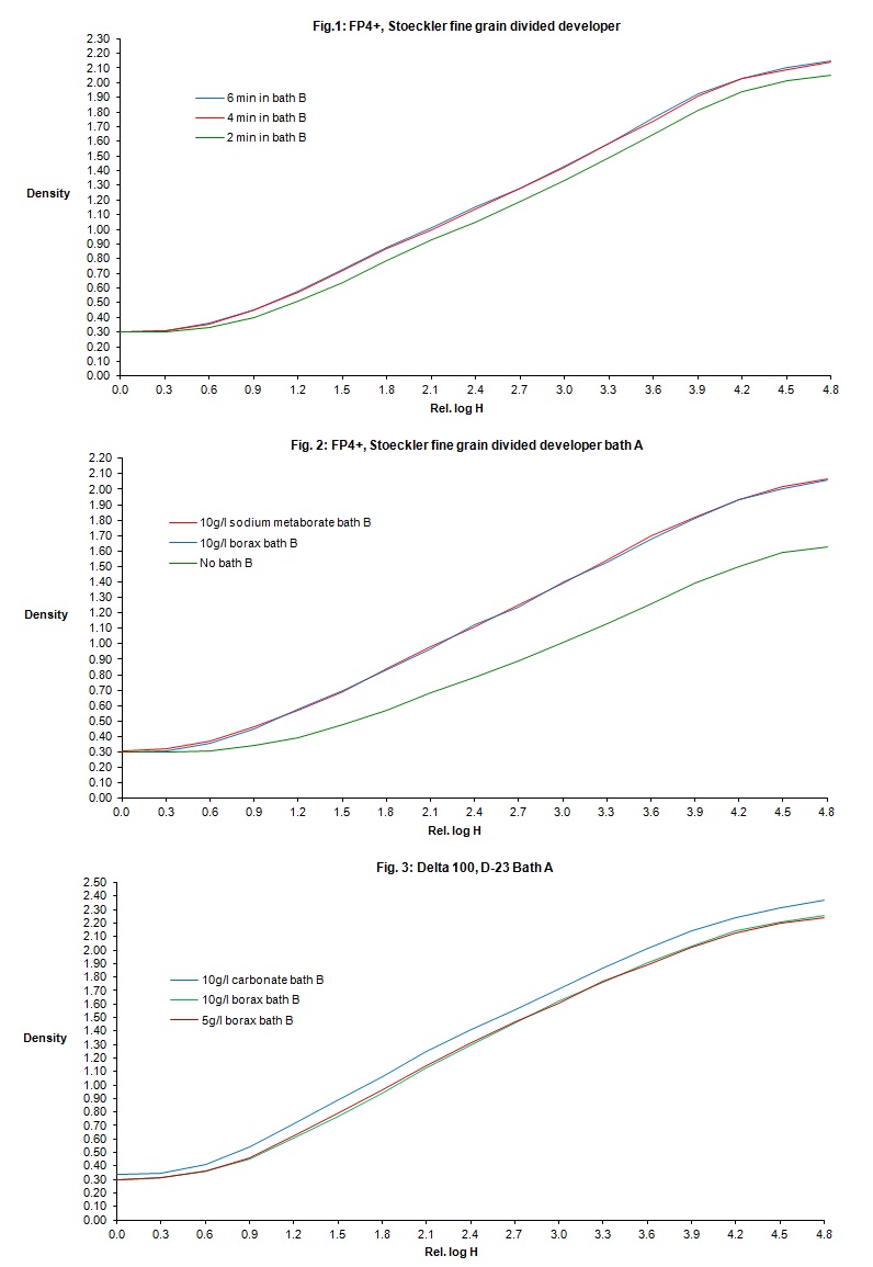

Regarding two-solution/divided development, below are some curves. Some of it is for Stoeckler's two-bath (which was one of the first of these) but the D-23 version(s) including Thornton are only trivially different. Some general results:
-Full emulsion speed (ISO or "box") is reached
-pH and concentration of second bath is largely irrelevant in the context of macro-sensitometry, borax being as effective as metaborate. Carbonate can increase emulsion speed very slightly but also increases fog
-Since the first bath is a fully functioning developer, development time in the first bath is how you control contrast
-Divided development tends to straighten the characteristic curve, and shortens the toe/shoulder
@Milpool: I, for one, found that exceptionally helpful. Many thanks!
Thank you Milpool. That was most informative. I have actually been using Metaborate and not Borax, but it seems that this does not make much difference.
I went to back to the source of my Thornton recipe (“The Edge of darkness”). In that book he mentions Phenidone as the main ingredient in DD-X, FX39, Microphen and T-max developers. For various reasons, these developers are not suited for stand development. Thornton praises Metol, and suggests either (a) dilute development in Perceptol or (b) Stoeckler 2-bath, which he has altered slightly.
In his book, Thornton suggests using various amounts of Metaborate in bath B as a way to handle high and/or low contrast. But it seems that the development in Bath A is more significant.

For now, I will expose Ilford films at half-speed and develop in the Metol-based 2-bath. I like the very straight curves that Milpool demonstrated.
