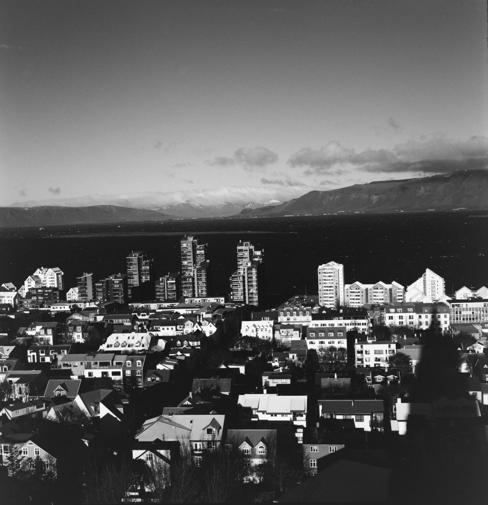

Man, I posted this 1.5 years ago! Several folders have come and gone since then, and I can definitely say that the Super Fujica Six has been the best overall. Definitely the most straightforward to use, and the lens is very impressive when it wants to be. Sadly, just a week after a trip to Iceland, mine fell onto a carpet from about 3 feet up and was mangled beyond repair. Served me well for that trip, though!
I think mine had a bit of an issue with the front standard, which perhaps brought the lens just a tiny bit too close to the film plane at 'infinity.' Lots of my landscape shots ended up a smidge soft, almost as though they were stopped down into diffraction territory (which they weren't). However, sometimes I'd end up with a very satisfactorily sharp image like this one. Sharpness is sadly the only thing it has going for it (boring subject matter aside, it's badly exposed, badly developed, and hastily camera-scanned), but it's still a useful example! XP2 @800, HC-110.

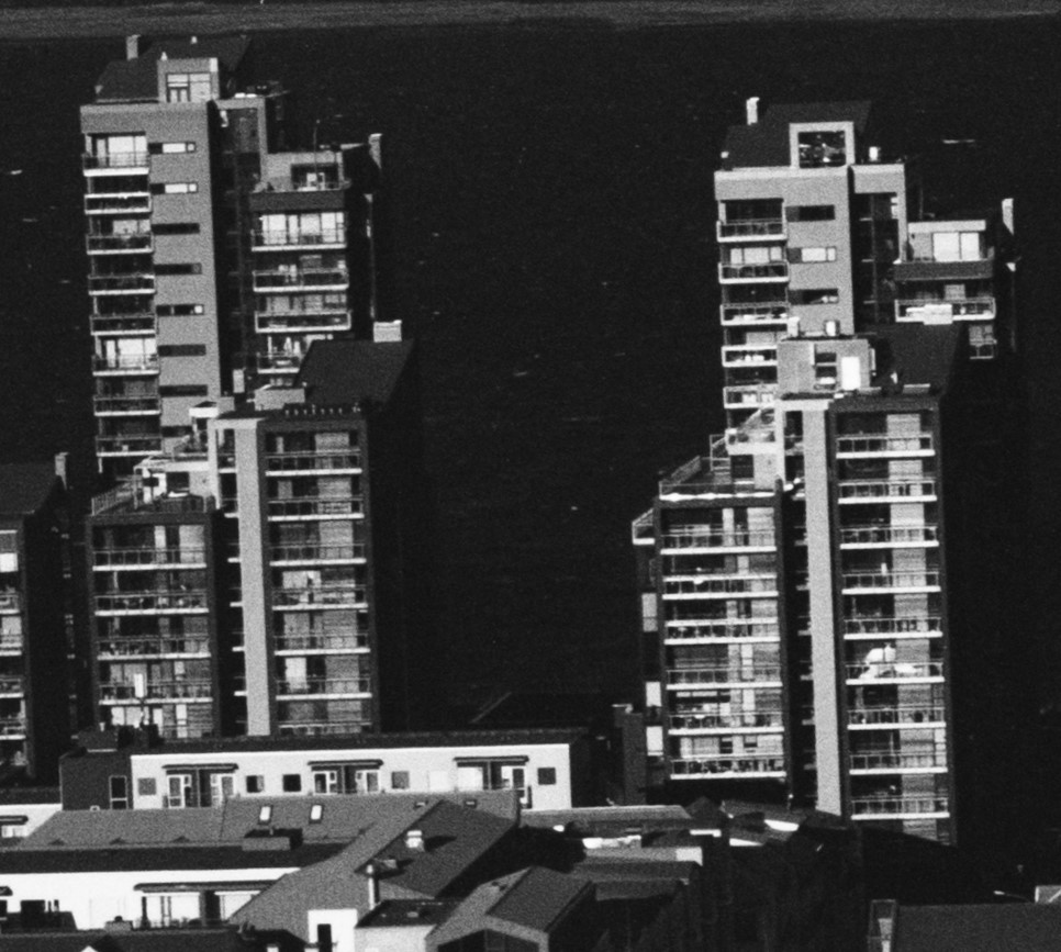

Here's a center crop at 5000x5000 resolution:

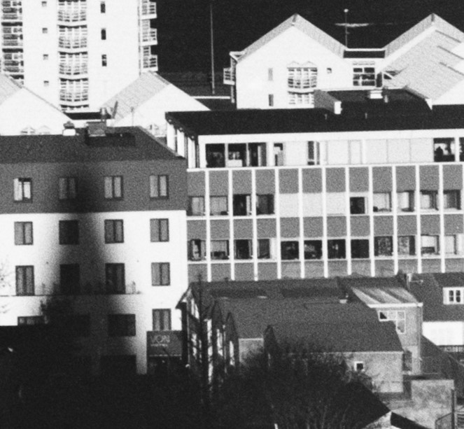

And from the right edge:
I also wouldn't say the lens is overly clinical, either. A really nice all-rounder. Two issues, though: 1. The edges of the film frame were on the shiny side, so I got some internal reflections that I fixed with some strips of black Shurtape. 2. No strap lugs!

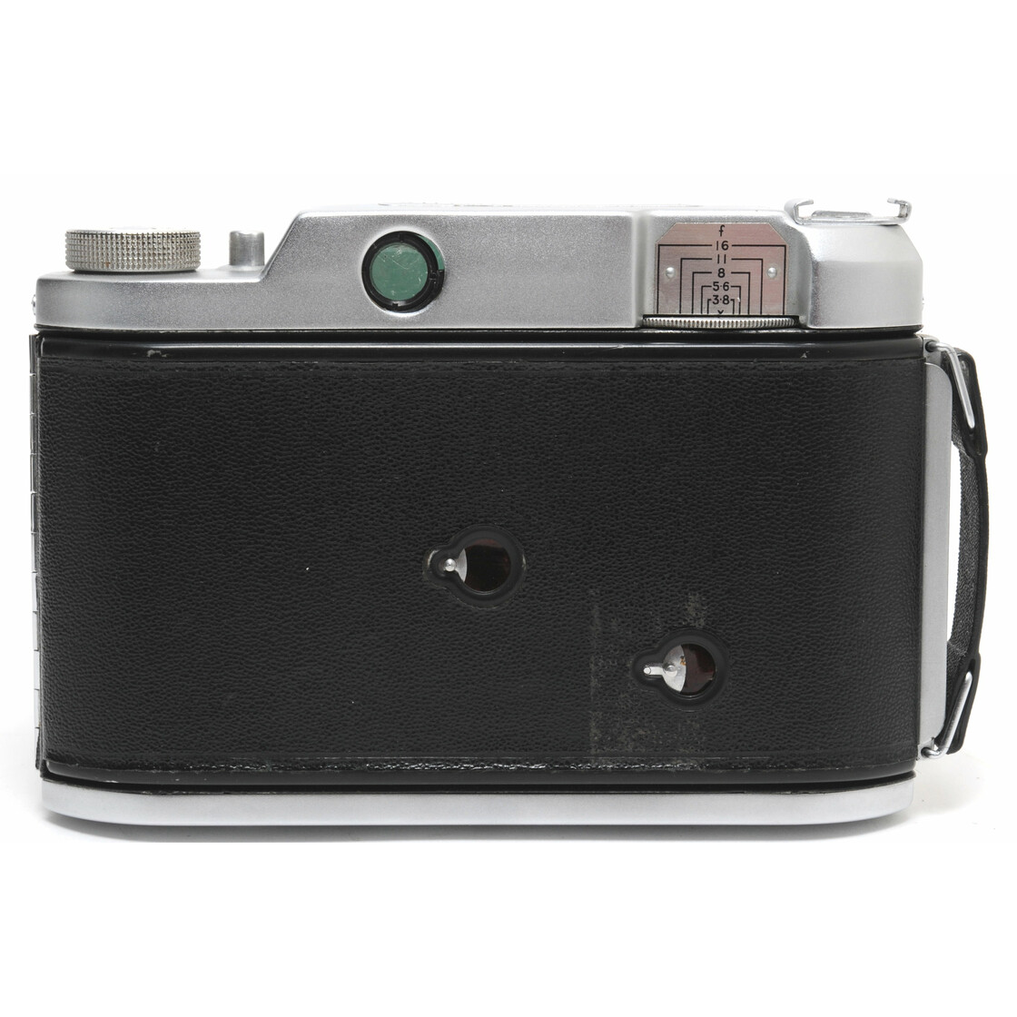

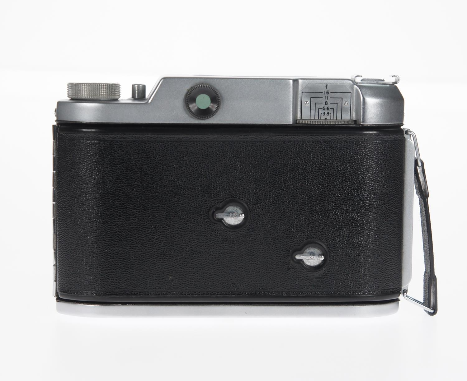

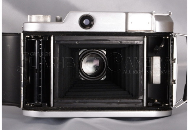

This is autorange 820's back. You can look at the thumb wheel for focus.
Do you have a pic of the focusing mechanism inside the camera?
Hmm...
I don't own the machine
There are some pics on the internet and they suggest that there is NO moving film plane, contrary to what I've claimed. Lol.
So it's a bit strange. Perhaps the front standard moves?
No pic (and not flavio either), but in my recollection that thumbwheel moved the whole 'light-box' assembly behind the bellows, of which the film guide rollers were the rearmost part. The equivalent of focusing a view camera by moving the rear standard, rather than the front one. The old Mamiya 6 did this as well IIRC.
Seems about right.

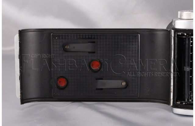

The Mamiya has you threading the film through a special pressure plate.
The Ross system is not necessarily better though, as the pressure on the film varies and the pentagraph mechanism (?) is probably much the same, with the same hysteresis and inaccuracies.
That last photo pair shows a camera that seems to be missing the actual pressure plate (should be mounted on the buttons on the two leaf springs. With that present, and enough travel in the springs, it ought to do an okay job of keeping the film against the rollers, though I'd suspect your results would be better if you focus before advancing film (which wouldn't fit with my half-century habit of advancing immediately after exposing).

I think the Autorange 820 shown does have its pressure plate, it's just a little hard to see in that photo-- the spring tabs are cut out of the plate and then bent and drilled for the mount screws. It doesn't squeeze very hard because it has to travel with the roller assembly. I had to take the PP off of mine because when I got it the red windows were completely shot- loose and barely transparent. I was able to find a leaky lesser Ensign so could replace with correct parts-- this sort of attention to non-functional detail is painful to me now.
