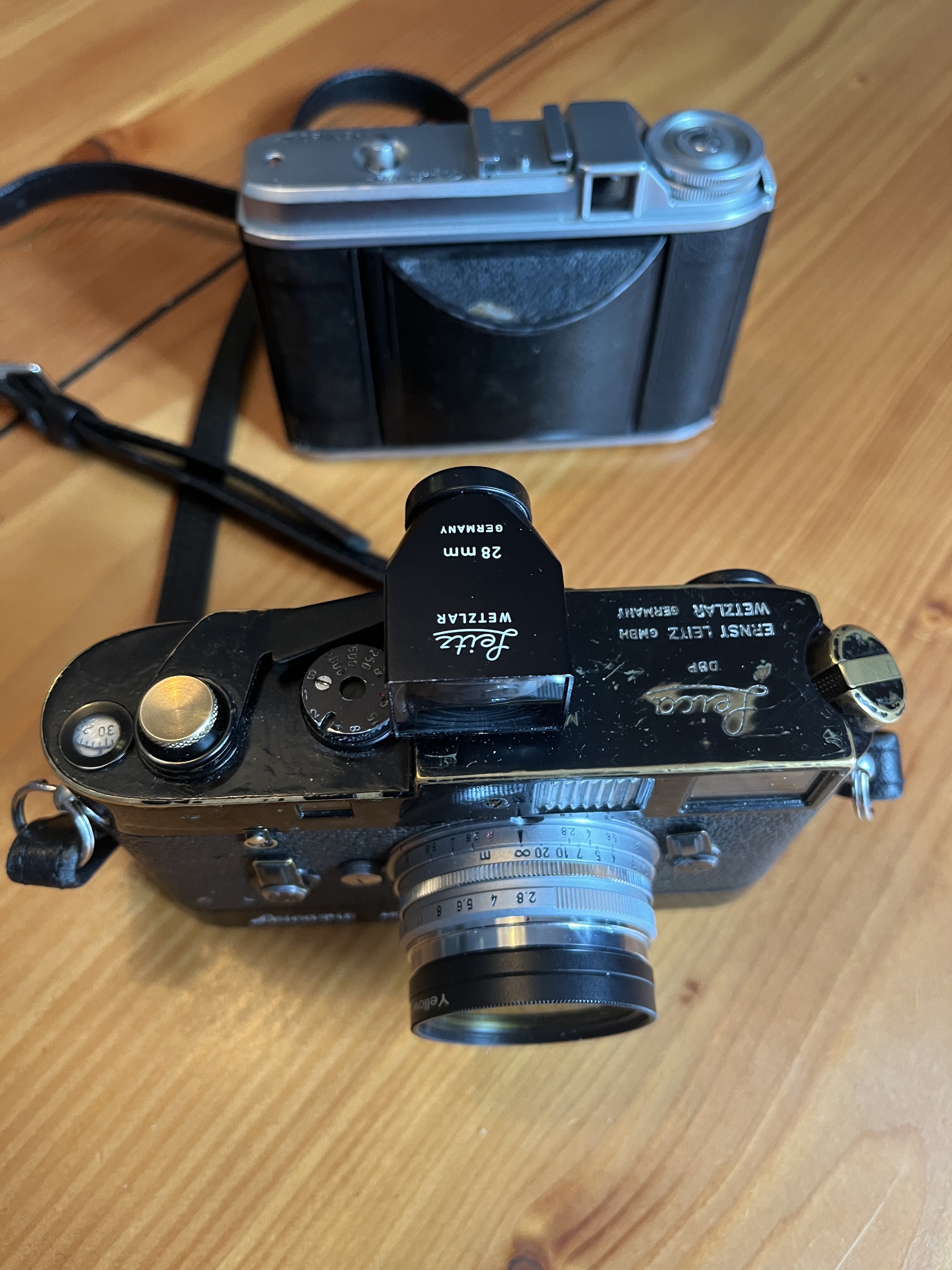

I only read the first 4 pages. Is anyone using a Voightlander Perkeo? I had ordered one about 6 years ago, but porch pirates got it. I've been wondering if I was missing out ever since.
I love my Perkeo II. After i got it i sold my Plaubel, It's such a perfect tiny 6x6 that travels well alongside a Leica. The Color Skopar lens is a gem. Photo @ minimum focus off the test roll & the Pll alongside the Leica.
