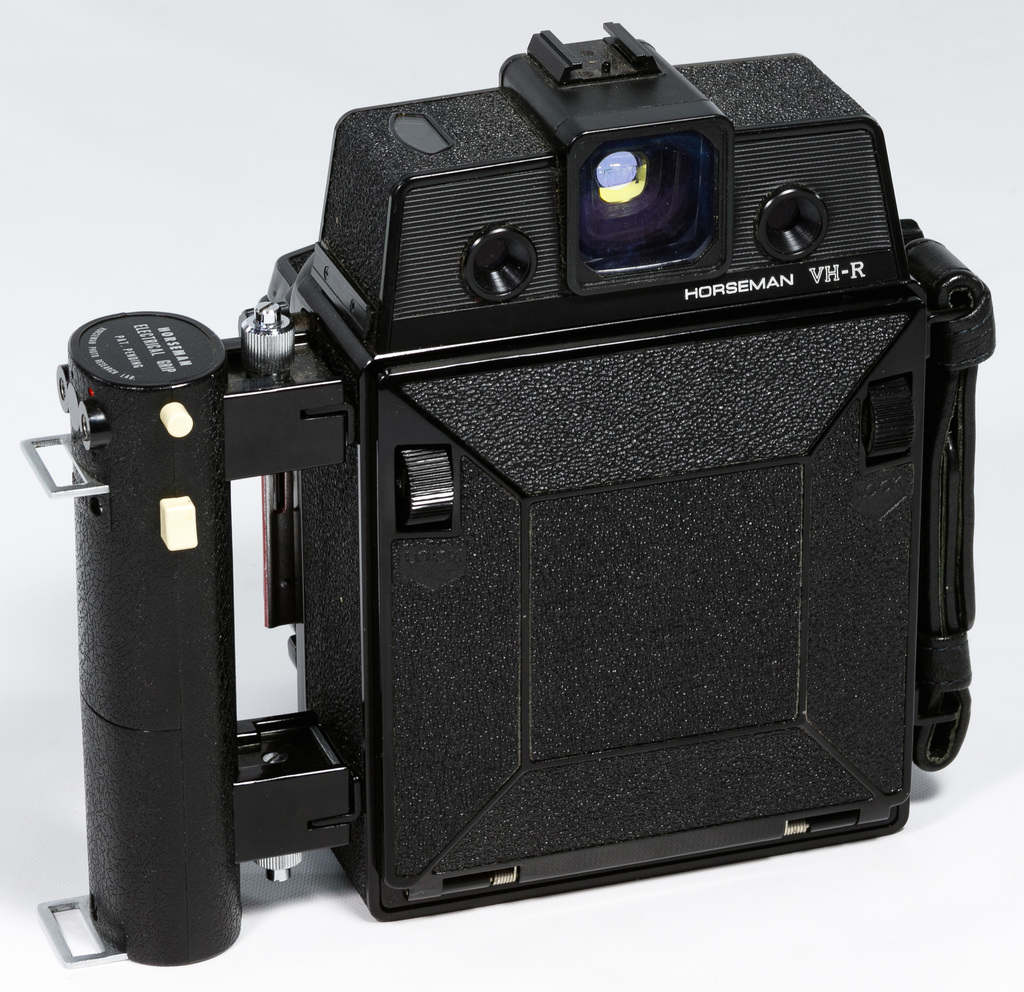

Depending on your definition of 'folder' but the Linhof and Horseman medium format technical cameras do fold up. I actually got my Horseman because I wanted better lenses and a way to focus, compared to my Kodak Tourist.
