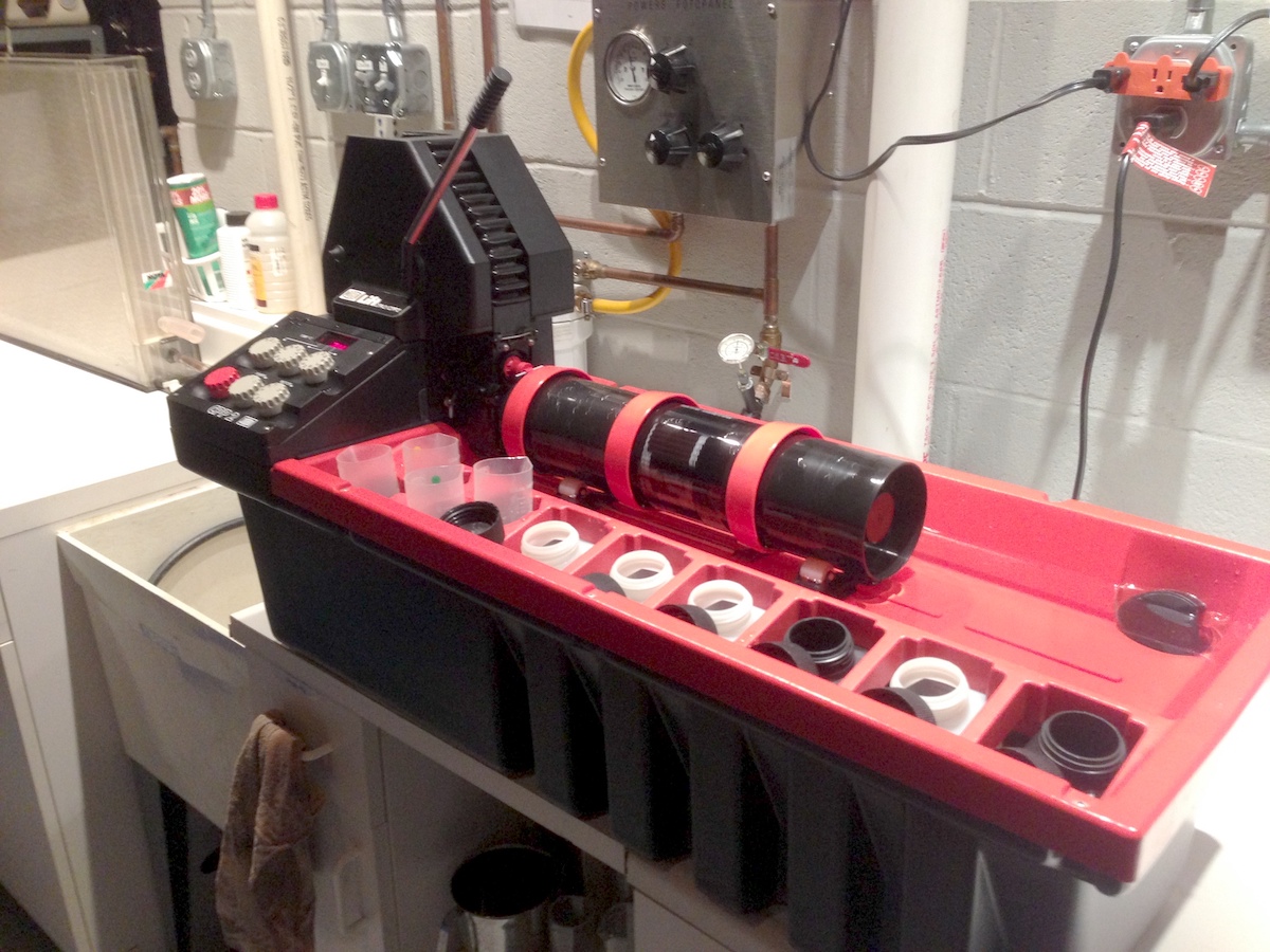

I started rotary processing 120 film in 1987. In 2000 I got a Jobo and have been using that same Jobo ever since. Thousands of rolls of film through it and it still looks and runs like new.
Even though I only do B&W, temperature control is a key requirement. The temperature in my darkroom changes dramatically depending on the season.
I specifically wanted the CPP2 because I need to process many 120 at once, and the CPP2 allows one to process 10 rolls at a time in the tank configuration shown.
I use the plastic reels and have never had any issue with improper development at the edges or any other development issue. I have never had streaking and don't know how that would happen as the developer is constantly swirling around at the recommended settings.
I think it is important to use a developer that is designed for rotary processing. I have been using Tmax developer since 1987. I hope they still keep making it.

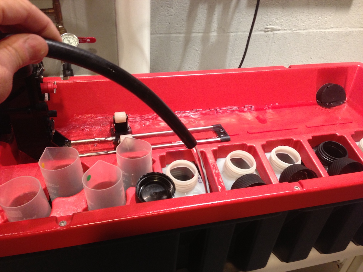

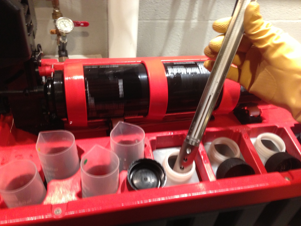

I fill the Jobo with 24C water and I fill all the bottles with 24C water also. I use the 24C water in the bottles to mix the chemistry. All liquid, one-shot.
That way the unit is ready almost immediately. By the time I load the tank with film, the developer is already at correct working temperature.
View attachment 354385View attachment 354386View attachment 354384
