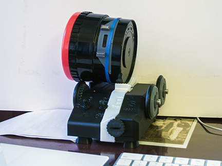

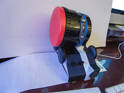

Look into B's rotary film processor. This guy has been developing versions of the processor for years and I just bought his latest version. I haven't used it yet, but I ran some rotary tests and I see no reason why ot shouldn't do the job. It starts, stops, rotates
bi-directionally, has three speeds and is well made. It ran me $165 and took me 1/2 hour to set up once I understood how it worked. See: https://www.bounetphoto.com/bounet-shop/processor-new
You should find some write-ups on You Tube on some of his earlier versions.
Good luck,
lenspeeper
