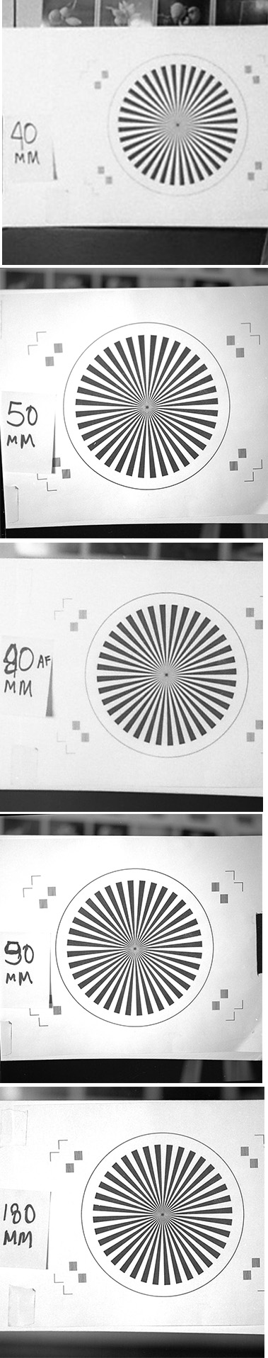

This is a focus test I did with the camera a while ago. This is a contact scan, the 40mm looks softer than it is because the image was enlarged to match the others. Note that the focus screen should be matte, fresnel side up. That side should be clearly marked "OBEN" along the edge.

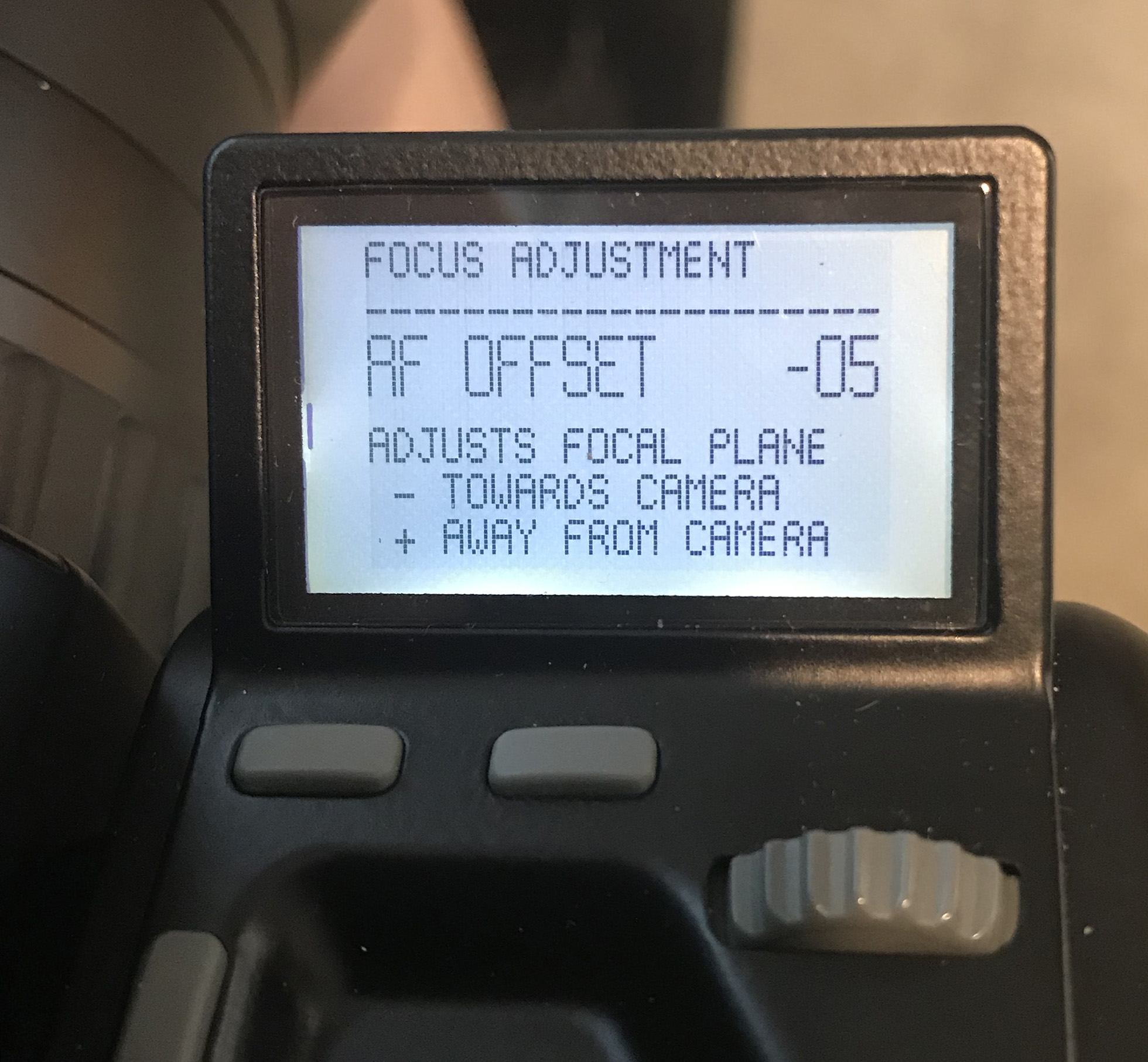

I think the term focal plane or focus plane, is confusing. A lens has a plane of focus on both sides of the lens. As you shorten the distance on one, you increase the distance of the other. That's why I autofocused with the offset set to -30, then re-autofocused with the offset set to +30, and watched the way the focusing ring turned on the lens. Upon refocusing with the positive offset, the focusing ring turns in the direction of infinity focus (moving the lens elements closer to the film and screen).
Basically, all the offset does is add a correction to whatever the default "in-focus" position would be. If the offset is negative, it moves the lens further from the film plane by a small amount. If the offset is positive, it moves the lens closer to the film plane be a small amount. But, my negatives show that the lens, even with an offset of +30, is still focusing at a point closer than the target. Maybe if would focus correctly with an offset of +40, but offsets don't go that high. Also, it seems like the lens has a hard mechanical stop at infinity focus, so it's possible that a positive offset wouldn't work at infinity (probably not a big deal with a very small offset value).
And, to be clear, with the offset set to +30 on my Hy6, the split image in the viewfinder indicates "in focus" after the camera executes an autofocus. If I reset the offset down to zero, the split image in the finder will not show the image to be in focus after the autofocus occurs. In other words, if I manually focus strictly using the viewfinder image and ignore the arrows, it will not necessarily be in focus on the film plane. I suspect that autofocus can, in many circumstances, be more precise than focusing manually (ignoring the arrows) even using the pop-up magnifier.

This shifts the image plane (rear of camera) toward the front. Closer to the camera body and rear of lens.

All motion is relative. As the lens moves forward, away from the camera body, the focal plane (in the back of the camera) follows and moves closer to the camera body.

I have another bit of info. I am focusing on a target that is 12 feet (3.6 m) away. The camera Status II screen lists "focus" and 'target". After focusing, they are the same. When I set the offset to +30, it says 5.1. After changing it to -30, it says 3.5. That seems to suggest that the camera is focusing closer as the offset goes negative. Assuming the units are in meters, the 3.5 value is a lot closer to reality than the 5.1 value. At offset 0, it reads 3.9. It indicates the "target" value in real time without actually activating autofocus button, but the "focus" value only updates after autofocus activation.

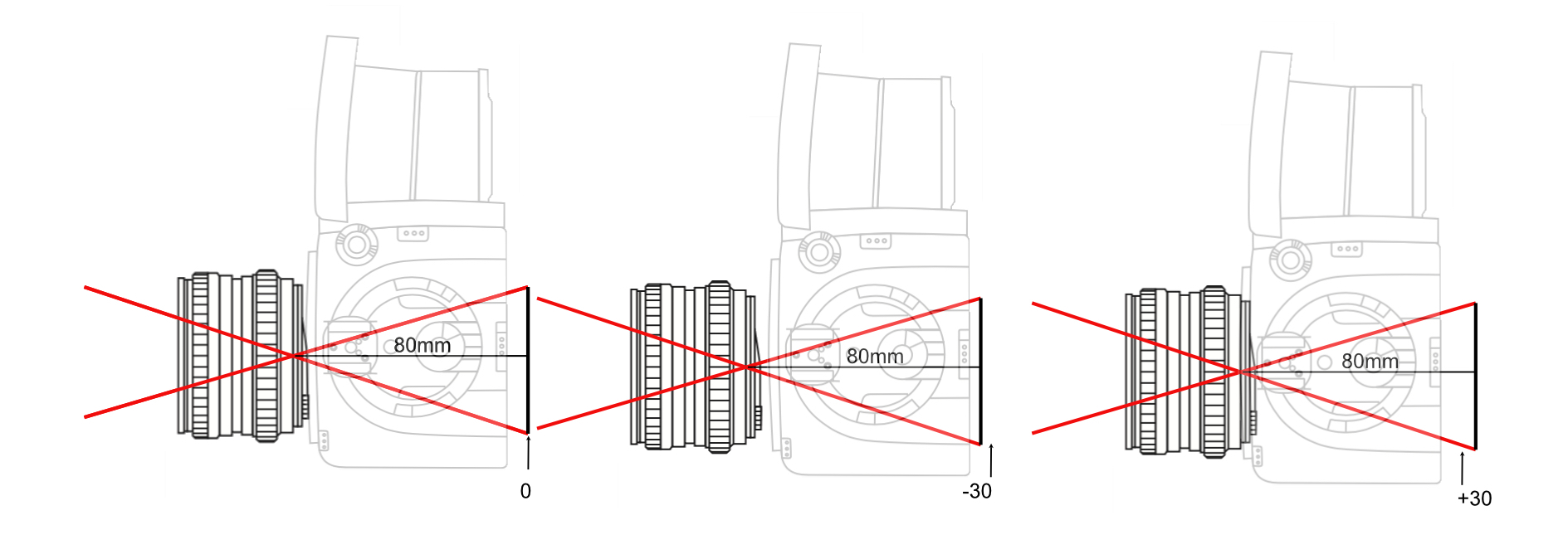

Here is a diagram of how the focus offset behaves on my camera (small upward arrow is film plane).
Here is a diagram of how the focus offset behaves on my camera:
Okay, here is how I'm interpreting your diagram for a given subject distance where a perfect camera and zero offset results in perfect focus on a sensor perfectly positioned.
If the sensor plane is too far forward, the -30 offset moves the lens further forward to compensate. If the sensor plane is too far rearward, the +30 offset moves the lens further rearward to compensate. In both cases the subject distance is the same, but the sensor position changed, so the lens was moved in the same direction by the same amount to compensate. The movement of the lens is accomplished by effectively changing the angle of the focus ring slightly.
If the sensor plane is constant (as the film is in my camera), moving the lens further forward is the same as focusing closer and moving the lens further rearward is the same as focusing further away. Which is what I've been describing. With a zero offset, by camera focuses too close. Setting the offset to +30, moves the lens further rearward by moving the focus in the direction of infinity. The film plane hasn't moved, so this improves the focus. The problem is that the focus is so far off on my camera, that the improvement isn't quite enough.
In my case, instead of the sensor being in the wrong place, I believe the lens elements are too far forward, so compensation is accomplished by moving the lens slightly more rearwards during autofocus (positive offset). This is supported by the fact that when I manually focus the lens (using the screen only) on a target 3.6 m away, the distance info from the lens says the focus is set at 5.0 m. The distance value from the lens doesn't change with the offset. It's hard coded into the lens based on the position of the focusing ring. But, a 5 m focusing distance puts the lens elements slightly closer to the film, just like the +30 offset does for autofocus.
So, I guess we're explaining the same thing from two different points of view.
In any case, with the offset set at +30, the focus was still slightly too close, But, since it goes up to +33, there's a possibility that the extra 3 points might just be enough to bring it in the last few inches. I plan to test that...
