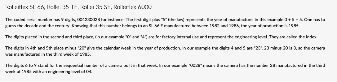

If the new factory is still using the old serial number system, you can determine the manufacturing date. https://rolleigraphy.org/codednumbers.php

The reason I am interested in the manufacturing date is because some materials (plastics, lubricants, lens cements, adhesives, etc) can age and change properties over time even if the cameras has never been taken out of the box. Aside from speculation, assumption, and hearsay, I don't really know how much manufacturing is going on inside DW Photo. I just know I'd rather own a camera that was assembled recently rather than years ago. I don't have any reason to believe this camera has been sitting on the shelf for years, but that was a factor I thought about before I bought it.

You might find different manufacturer designations. DW Photo only exists since 2015
