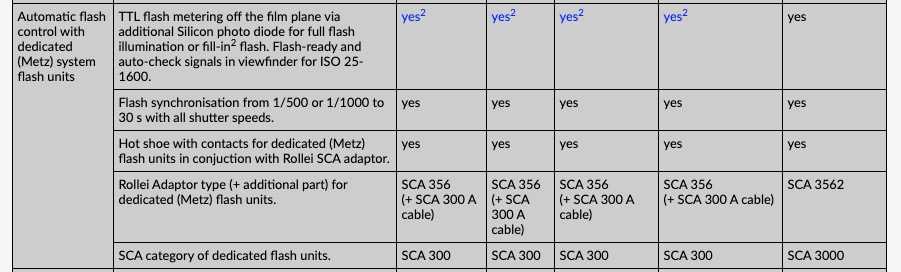

My HP5 order arrived today, so I can get back to using my Hy6 and doing more TTL metered flash photography. I have literally spent the last two weeks going over all the fill-flash options of my main 5 TTL cameras. Nikon f100, Nikon N75, Rollei 3003, Rollei 6008 and Hy6. All five of those do fill-flash differently, somewhat un-intuitively and with poor documentation.
Interesting information about fill flash with the Rollei 6000 series, from https://rolleigraphy.org/system6000chart.php

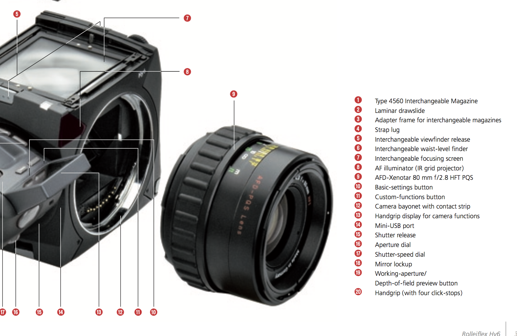

I have seen photos of the Mod2 with the black ring, maybe it was a prototype of sorts. They might be building the cameras with what they have on hand, most of the Hy6 cameras I have seen in photos have the silver ring and panel. One question for all the Hy6 owners out there: what is the red plastic unit on the front upper left corner (some sort of low-light AF aid, maybe)? and the small clear plastic on the top right of the body, just ahead of the finder release (maybe related to the red unit on the front--maybe related to the viewfinder display)? No indication in the manual of those.
The little clear sensor to the right of the viewfinder, I believe, is the stray-light sensor for the waist-level viewfinder.
The red beam on the front is an AF illuminator (#8 in the picture below).
