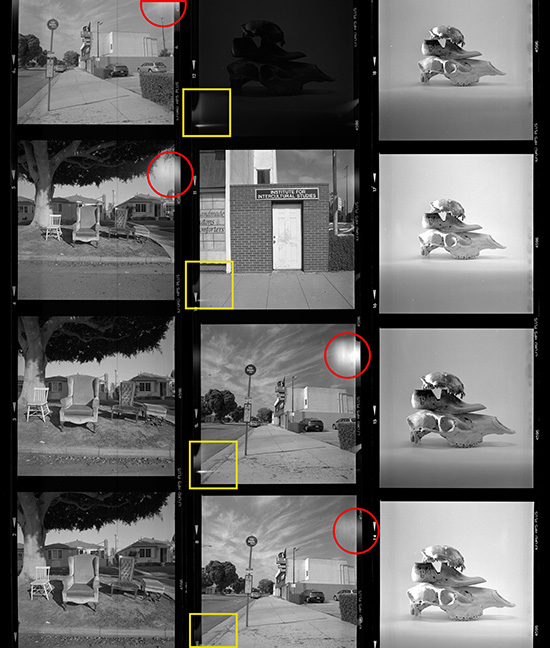

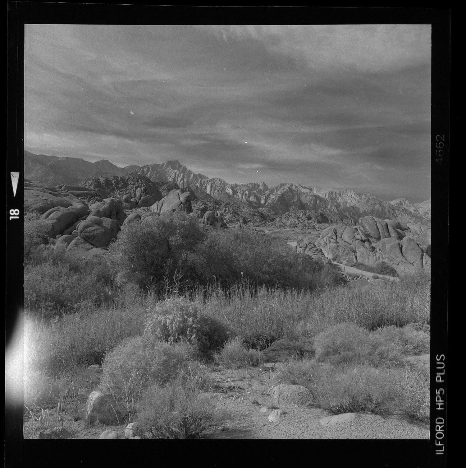

Just a guess, but your light leak looks very similar to one that just recently popped up in a second (don't ask), older, 6060 back that I have. One with the red release buttons, too. I spoke to Dave about it and he suggested it was coming from the dark slide mechanism, specifically the slots in the back that the bar moves along. I believe he thought the fix would be simple as he said the light seal uses shutter curtain material that would be easily obtained, no need to get parts from Germany. Give him a shout and see if he can check out that part of your film back. Best of luck and let me know it it works out, I need to send my back to him for that repair. Meanwhile, I have put a strip of gaffer's tape on the back and I hope it's working, I haven't processed anything since I discovered the problem, although I keep shooting with the camera. Despite all the setbacks I have had with it, I just love it. BTW, as far as I know the spacing problems were caused by the film inserts, not the back. And I heard that Rolf is doing the Hy6 repair work for Paepke, probably why you haven't had any response from them.
I am still willing to send my newer (grey buttons) back to Dave if it is still needed.
Pieter -- Looks like Dave @ Key Camera has tken some vacation until the 15th. You hear
anything from him ?
Sent the attached image to Dave .. looks like a light smear in lower right & maybe a similar (but less so) on the lower left.
FWIW --
Serge

Unfortunately, I don't have a photo of the back with the tape. I just put a 1/2" wide strip of gaffer's tape horizontally across the back just above the bar that moves the dark slide. I discovered where the leak was coming from by shining a small, bright flashlight into the back (attached to the body, no film insert, no lens, shutter set to B so the interior of the back was exposed) and saw a pinpoint of light coming through the lower right side by the dark slide bar. The bit of tape solved the problem until Dave can fix it.
