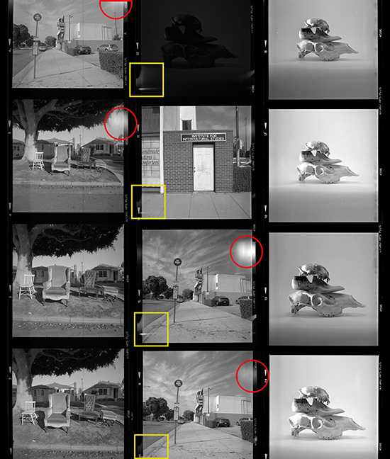

But back to your film back. I experienced light leaks and transport issues with a brand new one from Eric at Rolleiflex USA. It went back to Germany under warranty, the issues were not completely fixed. Do you have any examples of your light leak? if it is not the same as what I had, I would be willing to send mine to Dave for a comparison. Here is what the light leaks from my back looked like:
The leaks were fixed by the folks in Germany, but the back is still suspect--I get unexplained spacing issues with some of the inserts, which have been to the factory, too. Sometimes I wonder if I should just give up and go back to the 6008i.
