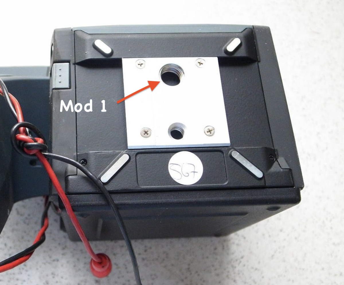

A wild stab, but earlier Hy6 models apparently had an issue with the AF being damaged by overtightening the tripod mounting screw. Could that be something to check?

I think I saw something about that somewhere but can't remember where. Do you know what the symptoms were that the autofocus was broken in that case? As I understand it, this camera is not an early updated Mod1 Hy6 and was originally built as a Mod2. Also, my initial experiments were conducted with the camera sitting on the edge of a table rather than on a tripod, but I have since started using a tripod.

Since your early experiments did not use a tripod and the camera is certainly a late model, I doubt that the tripod mount is causing the problem. If you had been using a tripod and the screw was particularly long, I thought --a long shot-- it could have deformed the body enough to affect the AF.

Okay, thanks for the extra details. In that case I should be safe. I don't know that the screws on my Bogen tripods are particularly long, but I never screw them in all the way in any case. Not sure what made me adopt that precaution, but that's the way I've been doing it for years. I probably read on a forum somewhere decades ago that it's a good idea. :D
Without the autofocus, did you tests show the film plane and focus screen agree or don't agree? If they don't agree, that would be grounds to send the camera back.
Mod 2 should have a thicker plate, not drilled all the way through, to protect the camera from a long tripod screw.

Pretty sure this was fixed on the Mod2. With the earlier version, if one had a "too long" tripod mounting screw, it could put pressure on the mother board at the bottom of the camera.
