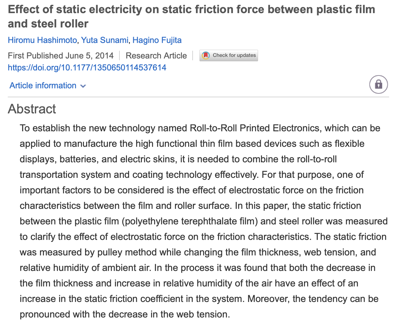

I have started to think 'outside the box' for the source. Of course the source can't be on the paper side, but wait. X-rays can pass through the paper, so it is not IMPOSSIBLE. Perhaps a static discharge can originate behind the paper. Also, I had a Rolleiflex 2000F with some contaminant on the roller. It made a series of black spots (on the the print) with every revolution of the roller.
This paper, however, uses "static" in two meanings, and uses "film" differently than used here on PhotoTrio.
Well, I think we've exhausted all the inside-the-box options, so outside is all that's left. The scratch seems to be too fine for a light or ESD source, though. I did have a look inside the back of camera last night though, just to see of there was a gremlin in there reaching out to scratch the film. I think you mentioned doing something similar in an earlier post.

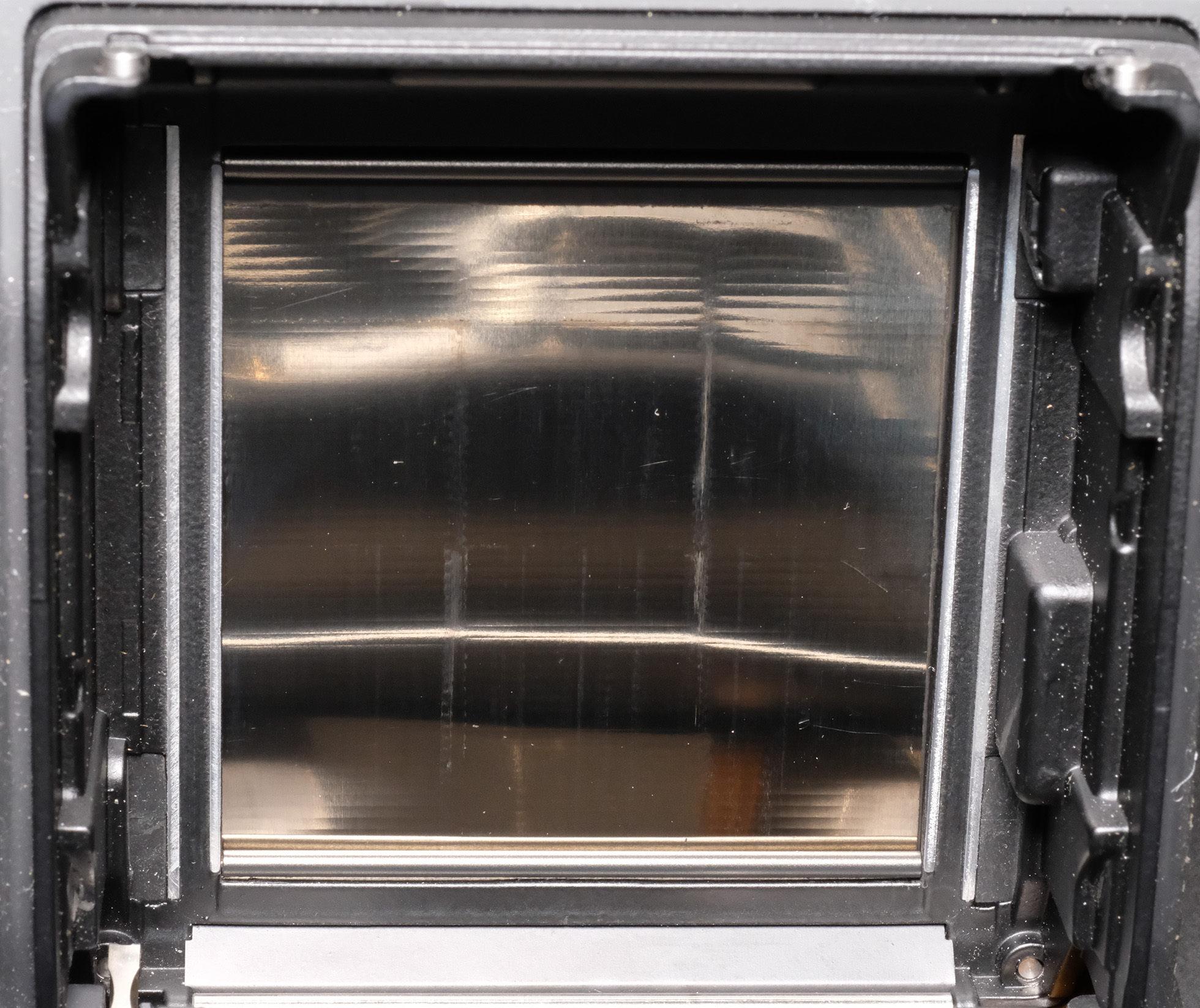

It would be interesting to compare a one of our film backs against one that we know doesn't have this problem, presumably an older one. Maybe something has changed in the materials, machining, or fabrication that could help identify the source of the scratch.
I have an older 6060 film back, with the rubbery coating. I will try to take some shots of the interior--let me know if there are particular details you want. I know there are difference with the current model.
That would be great! Thanks. I would suggest starting with the film path areas at the top and bottom (hinge end) in the area of the small rollers with the insert not installed. If you see anything that seems like it might have a bearing on the problem, please let us know your thoughts. Are there also differences between the older and newer inserts?

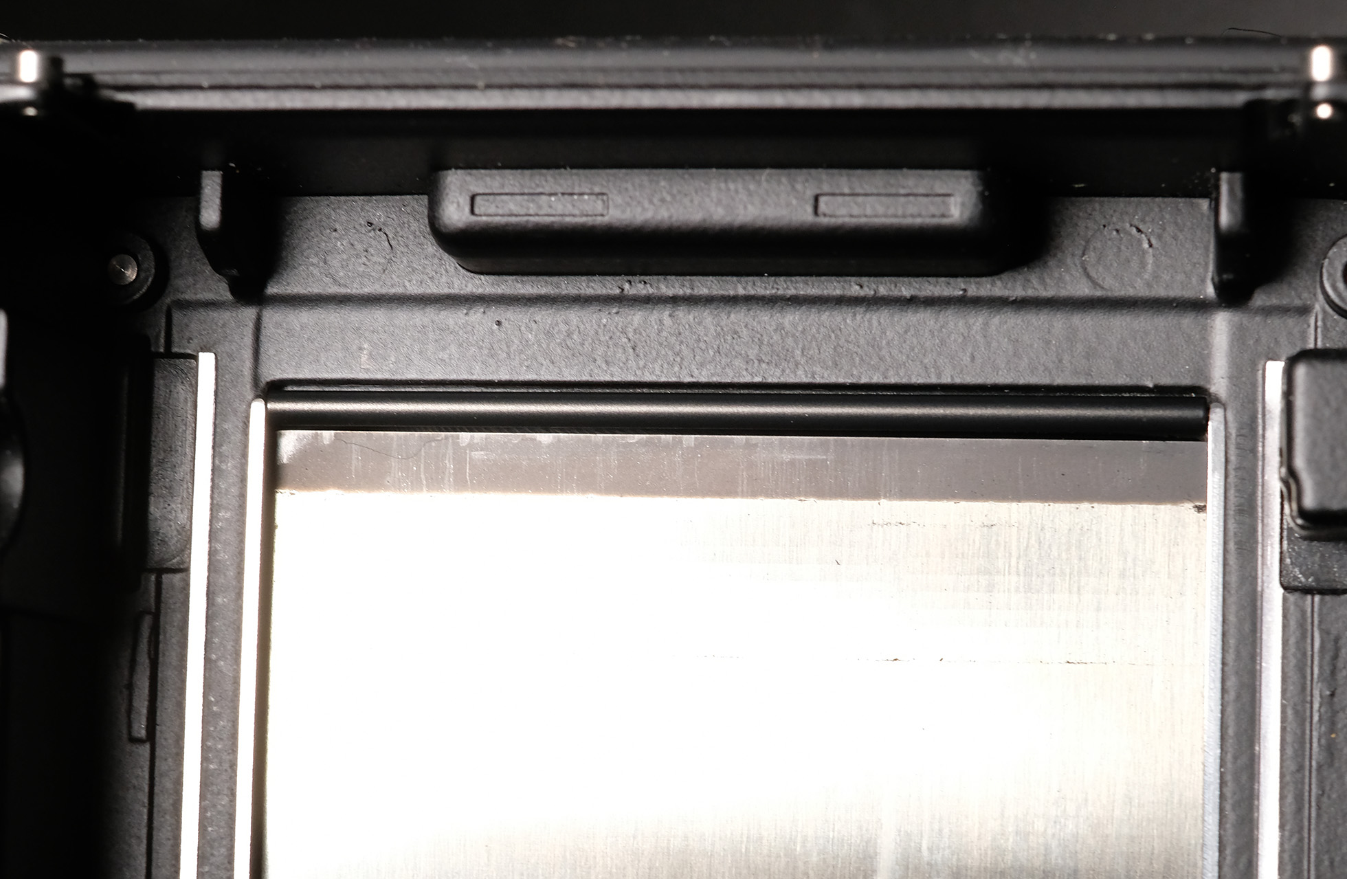

Here you go. I hope this shows what you want. Note that both the top and bottom rollers are black, but smooth so they reflect and look polished. Also, there is no tape anywhere. The flange (?) below the bottom roller is also reflecting light so it looks lighter. It is black metal. There is no tape at the top, but two indents cast into that part. Also, a quick examination with a 4x loupe of the only roll that has been run through this back by me shows no scratches. The inserts all look the same to me.
View attachment 278179 View attachment 278180 View attachment 278181
Thanks for the pictures. I don't see any differences that might explain why newer film backs would create scratches. It does look like the casting is different, but I don't see any significant differences in features.

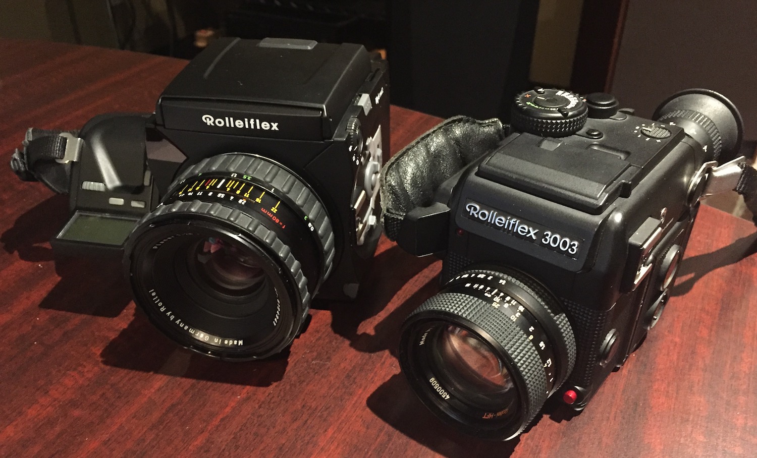

I have wanted one a Hy6 ever since I first heard of it. I was kind of waiting for my Rolleiflex 6008i to break down or wear out but that never happened. With COVID I was concerned DW Photo (current manufacturer of Hy6) would go under. So, when I found out that new 2020 cameras were available I snatched one up.
I remember 30 years ago when I got my Rolleiflex 3003, it was a little bigger than I thought (based on pictures and never seeing one in person).
It's a shame the medium format cameras and I have more popular. To me, seem to be the afternoon compromise between the flexibility of 35mm cameras and the image quality of large format cameras. Well, as long as I keep my Hasselblads and their Carl Zeiss lenses well-maintained, I should be OK for the rest of my life time.
The Hy6 was the opposite. It was SMAlLER than I expected based on the pictures!
For those not familiar with these cameras, the Hy6 is on the LEFT and it is 6x6cm format. The 3003 is on the right and it is 35mm format.

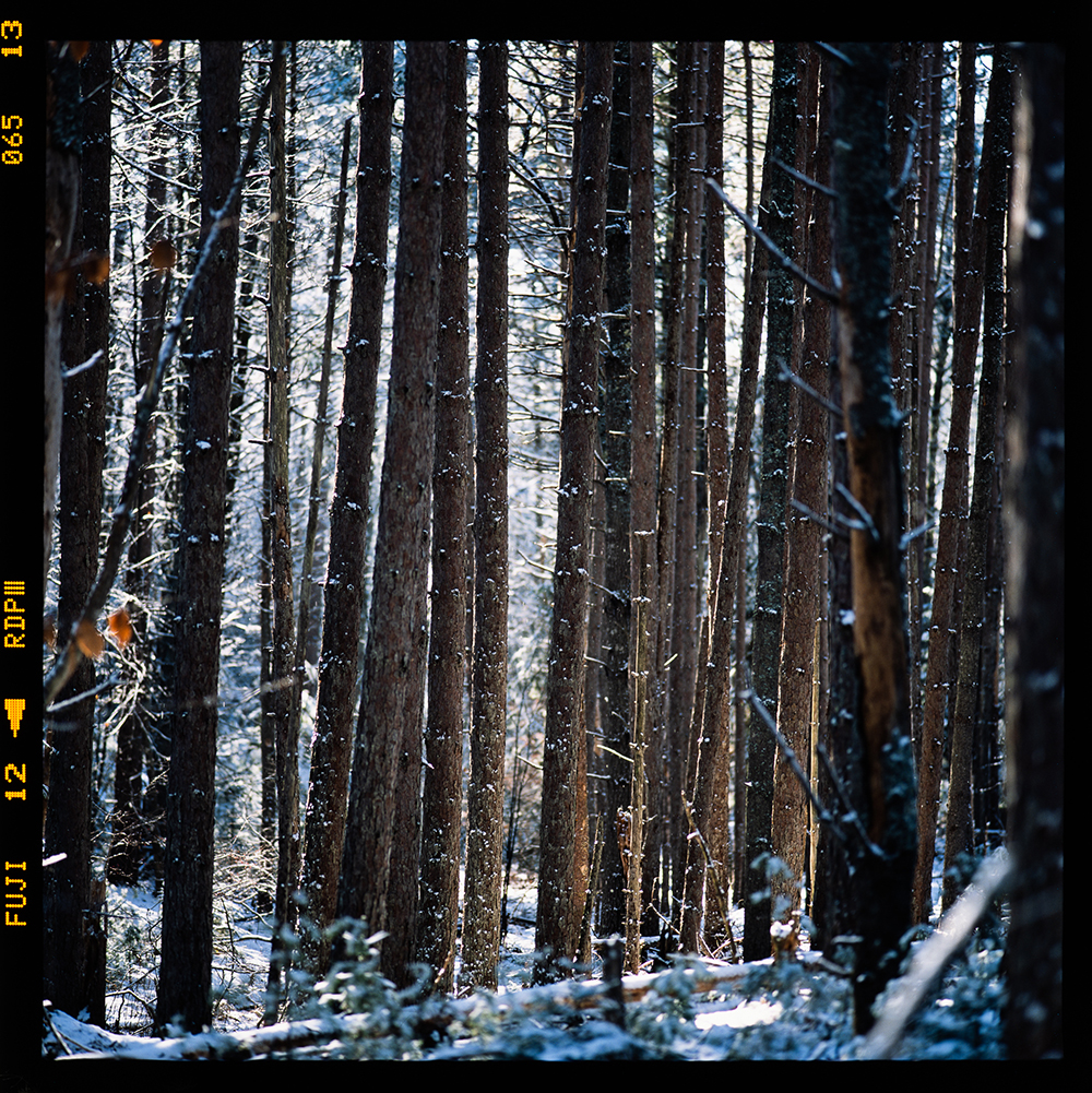

Here are some images I made with the amazing 180mm 2.8 PQ on RDP100. If I recall correctly I just used aperture program and shot away. The camera tends to nail exposures on chrome even in difficult lighting. The Schneider lenses are IMHO the reason to get into a 600x or Hy6 camera.
View attachment 293177 View attachment 293178
