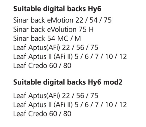

I also saw this in my Hy6 Mod 2 user manual. It looks like the Sinar back does not work with the Mod2. You might want to contact Eric at Rolleiflex USA or DW photo to see if there is a work-around.

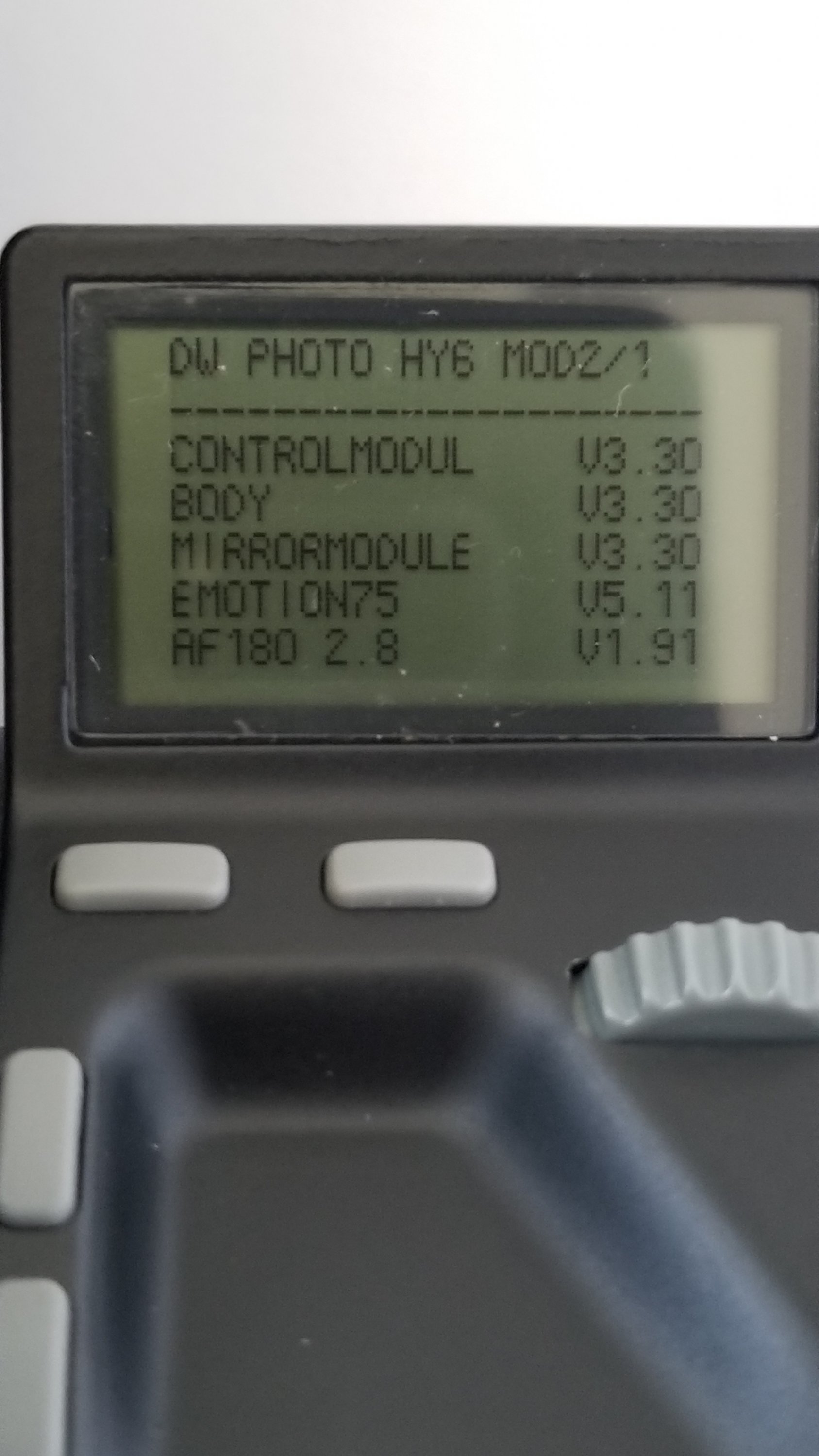

Schneider-Kreuznach AF-Xenotar 2.8/80 - the firmware lens level not detected by body. Fails to boot and showing message "Starting app"...
Schneider-Kreuznach Xenotar 2.8/80 - the firmware lens level not detected by body. Fails to boot and showing message "Starting app"...
Schneider-Kreuznach AF Tele-Xenar 2.8/180 - the firmware lens level detected by body and shown in options menu V1.91. Body boots with no issues. I am not sure, if it will function with no film magazine or DB attached.

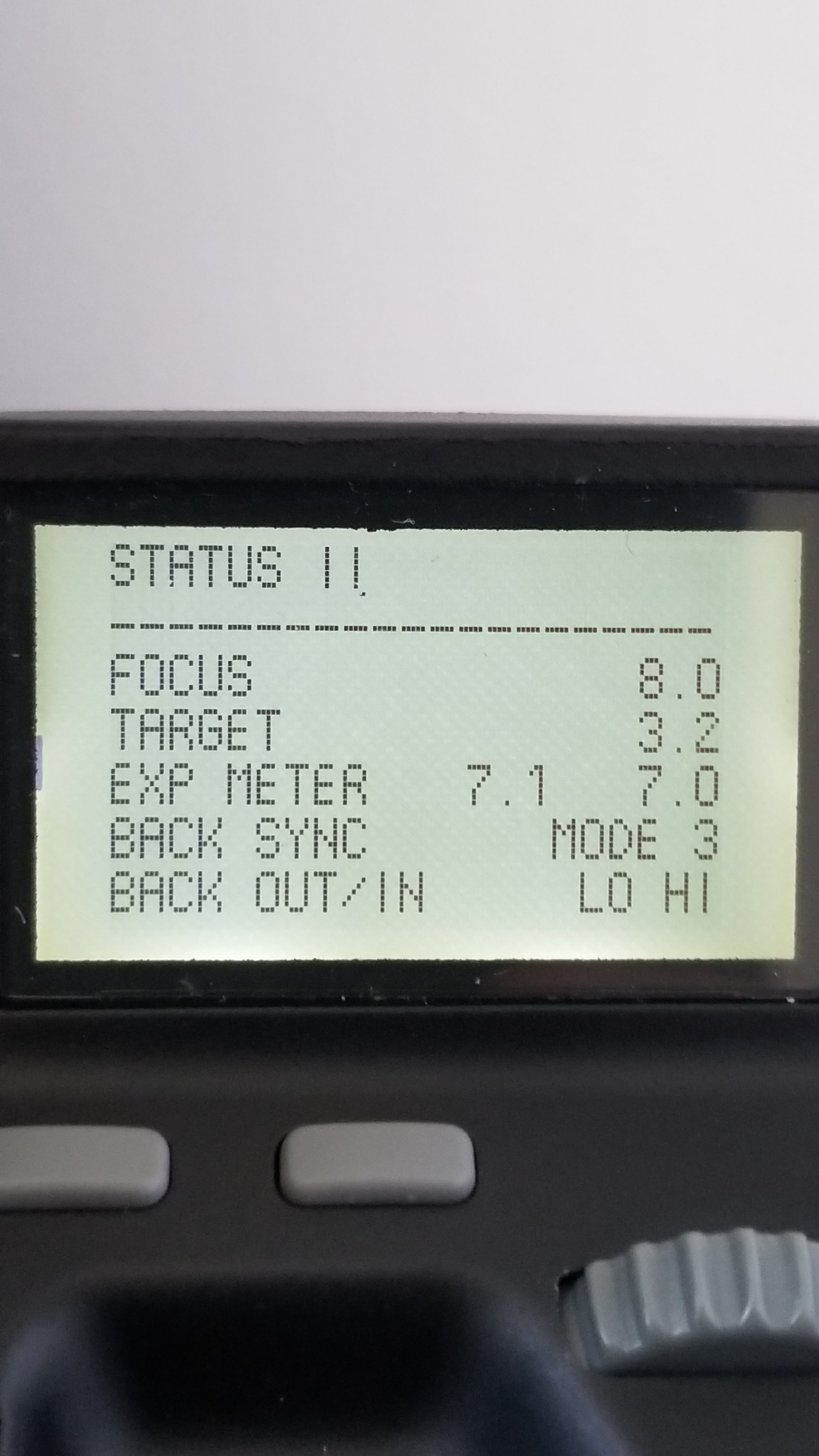

I may be mistaken, but I don't think the MF lenses display a firmware version. Does the body detect the digital back in the Status II screen?

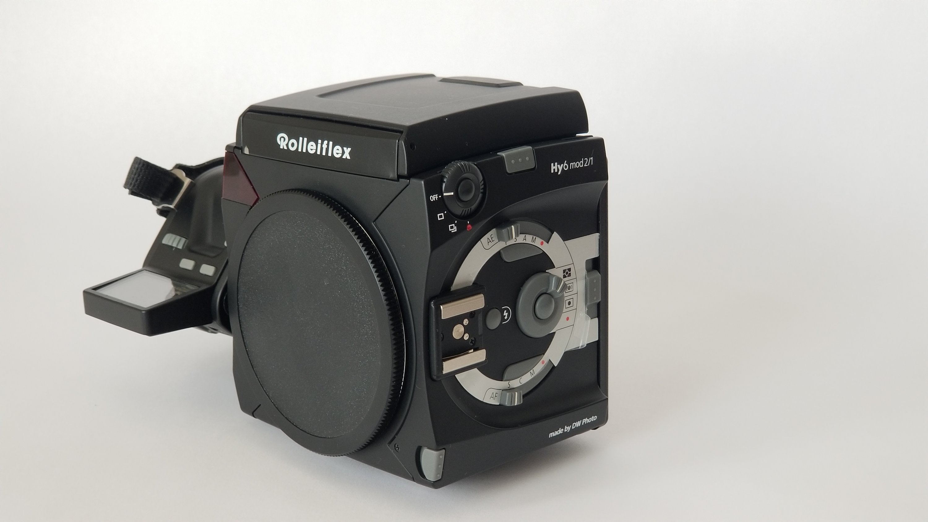

I have recorded a short videos of the camera body with no lenses attached and two Schneider lenses Xenotar 2.8/80 and AF-Xenotar 2.8/80. The eMotion 75 LV was not attached. Both lenses works on Rolleiflex 6008 AF body with no issues.
Below are the links to the clips. With both lenses attached the body will not boot and makes the clicking sound once turned on.

I have my Hy6 in front of me. I have the back removed and a Planar 80/2.8 non-AF lens.
When I turn it on it gets that same click but only ONCE, and otherwise works fine.
I do not think I have other options, than shipping the Hy6 body along with the AF and manual focus lenses back to DW Photo. This would be the second time, after the upgrade to mod2.
