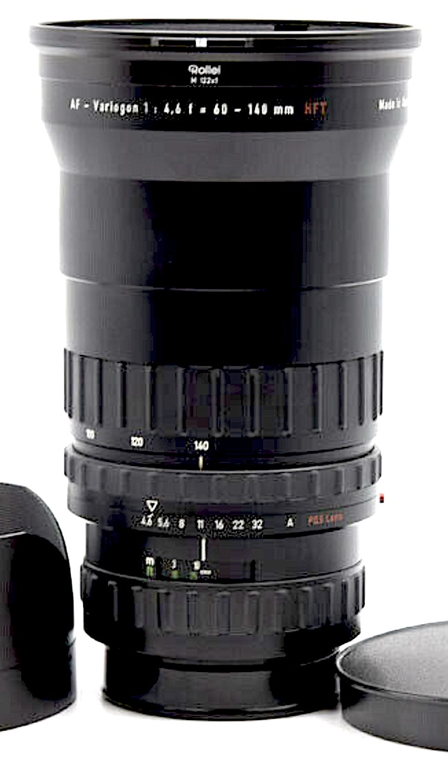

Anyone using the Variogon Zoom? I don't have an autofocus lens with an aperture ring for my 6008AF and have seen AF Variogons with aperture rings. I wonder if a 'tripod' lens is worthwhile to use autofocus. Would it even be possible to hand-hold that thing?
Yes it is, with the left hand below the lens. The picture I put on the "post your urban landscapes" thread was shot handheld with the AF-Variogon on the Hy6 (ISO200 setting for the digital back); 1/80s at f/5, 60mm focal length. AF quite useless for that kind of shot where focus is close to infinity, but handheld is perfectly possible. Between shots when not using the camera nor lens, I do have to carry it like a baby though, on top of my crossed arms..

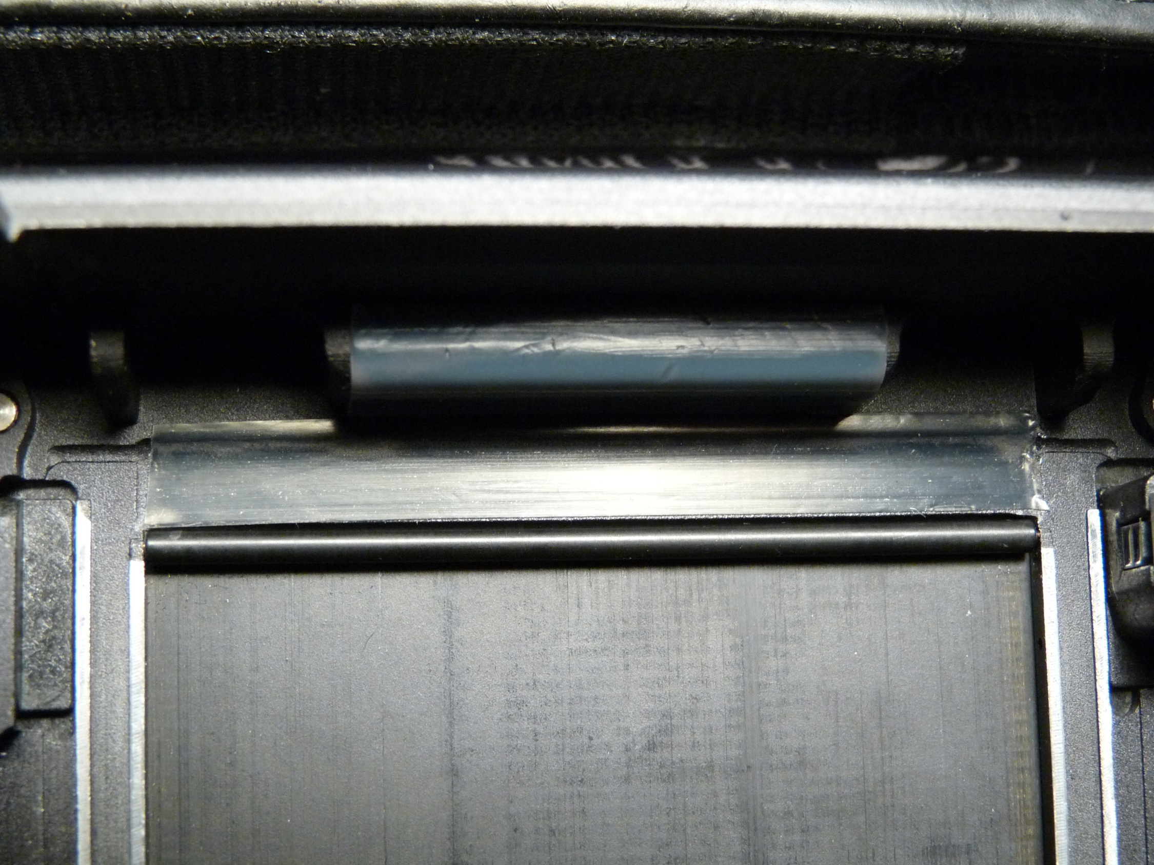

This shows the Teflon tape covering the upper roller. This was the only configuration of tape that eliminated the scratch. I don't want to leave the tape on there permanently, as you can see the film passing through is lifting the tape up at the upper corner.
Previous tests by removing and processing the film prior to exposing frame #12 showed the scratch was never on that un-exposed frame. So the scratch must be coming from the upper portion of the Magazine.
I have now taped both rollers (one at a time) with the Teflon tape from McMaster, but still have the scratch in both cases. To reiterate, I get the scratch on several (but not every) frame and it is faint -- not easy to spot (at least for me) without a magnifier. The scratch is about 19.5 mm from the edge of the film on the emulsion side. I'll link pictures of the tape and one frame scanned in on my Epson V600 at 4800 dpi. Ignore the dust spots. I rarely use my scanner so it's not the most dust free part of the house. In any case, I'm ruling out the rollers in my case. But, I still haven't identified any other possible cause, but I have lots of tape left...
I have shot the 60-140 zoom a fair bit both in the field and in the studio. The autofocus is decent considering it has to move a lot of heavy glass. Will be faster with the Hy6 than the 6008AF. Never tried it with film, but only with the AFi-ii 12 (80mp). I can say it's the better or equal to all prime lenses mid range to 140mm. At 100mm it's amazingly sharp. It will write to the EXIF on digital files the approx focal length it was set to on the Hy6. One reason for taking it into the field is that you don't have to change lenses and if you were going to carry three prime lenses to cover that range it's about the same weight or less. I shot hand held with one hand under the lens supporting most of the weight. Have done the same in the studio. Other quirks about the 60-140mm - it will not work with extension rings. The reason I learned that is that the closest focus distance is pretty far out for portraits. It does have a tripod foot, and I would think for most people they will be more comfortable using this on a tripod than hand held. It's really heavy to hand hold for longer periods of time. In the studio I would shoot for a few minutes and then set it on the table. Using this lens hand held is like going to the gym.
There are two older zooms which are significantly lighter, both Schneider. The 75-150PQ and the 140-280 PQ. These lenses have small maximum aperture of f/5.6 and can be hard to focus in dim light. The 140-280 really makes a nice portrait lens and the rendering is old school LF film lens like. Not as sharp as the 60-140, but very nice rendering and a ton easier to carry and hold.
Eric, thank you for your contributing you knowledge of these lenses to this forum.
The other option for an "all purpose" lens for my 6008AF is an 80mm AF! (see your PM).

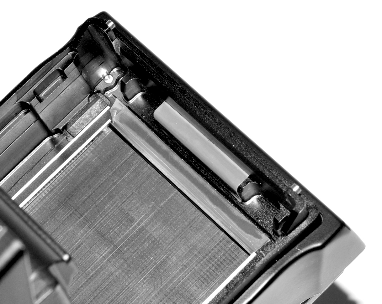

Links (sorry, they are all large, full size, files).

Welp, in case anyone is still following this scratch issue, I tried something different. I noticed that the film that I shot with the upper roller taped had significantly less of the 19mm scratch than the one with the lower roller taped. So, I went back to my theory that the insert may shift slightly upward inside the clamshell when the film advances. In my imaginary world, that could be the reason for the blue teflon tape over the center feature of the upper end of the clamshell. So, maybe the film is being pushed against the upper edge of the trough during film advance. To test this, I put tape over the upper edge of the trough (picture attached), but did not cover the roller. I can no longer find any trace of 19mm scratch (although I only shot one roll). I think I am just doing a variation on what ic-racer did, but this seems to work a bit better for my film back.
If you guys have already definitively solved this issue, please share. This is the first time I've seen the tape solution work for me, so I'm happy, although this may not be the final answer. I don't see anything on the upper edge of the trough that could cause a scratch and this doesn't explain how the scratch can be happening on the opposite side of of Pieter's film. If I can get past this scratch problem, the light leaks are my only remaining issue and that should be an easy fix.

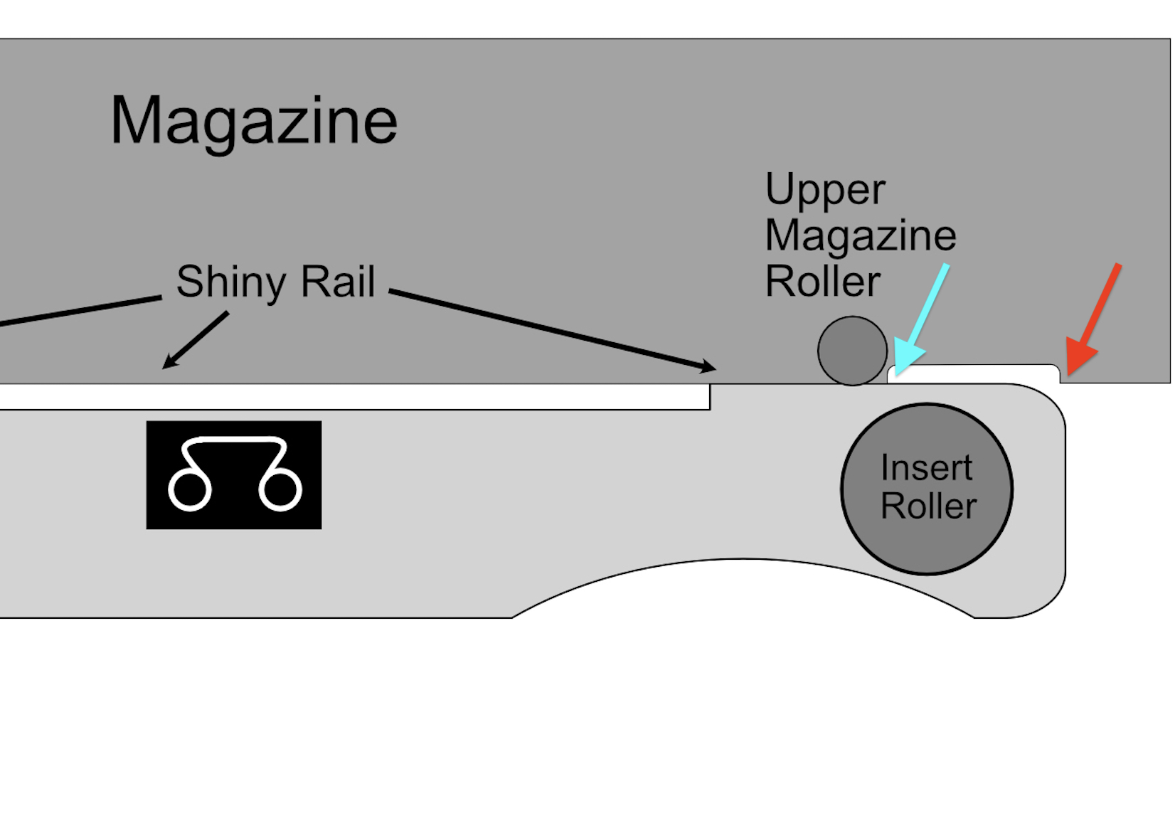

I think my drawing below shows the area you covered with the RED arrow. I did not think the film would touch there, but my drawing is not perfect to scale, and as you suggest, the insert does have some 'wiggle room' to move a little.
I'll give that a try (ie covering that area).
Exactly. We don't suspect damage from geometry that, upon visual inspection, could seemingly never touch the film. I'm still a little skeptical that the scratch is coming from that edge, but I think we're zeroing in on it.
I have to order more film, but my plan is to shrink the taped area down to just the rear edge of the trough and only in the region (maybe 20mm wide) where the scratch is happening. Maybe a little smoothing of that edge is all that will be required as a final answer. Using the Teflon tape was a great idea. Thanks for all your efforts.
