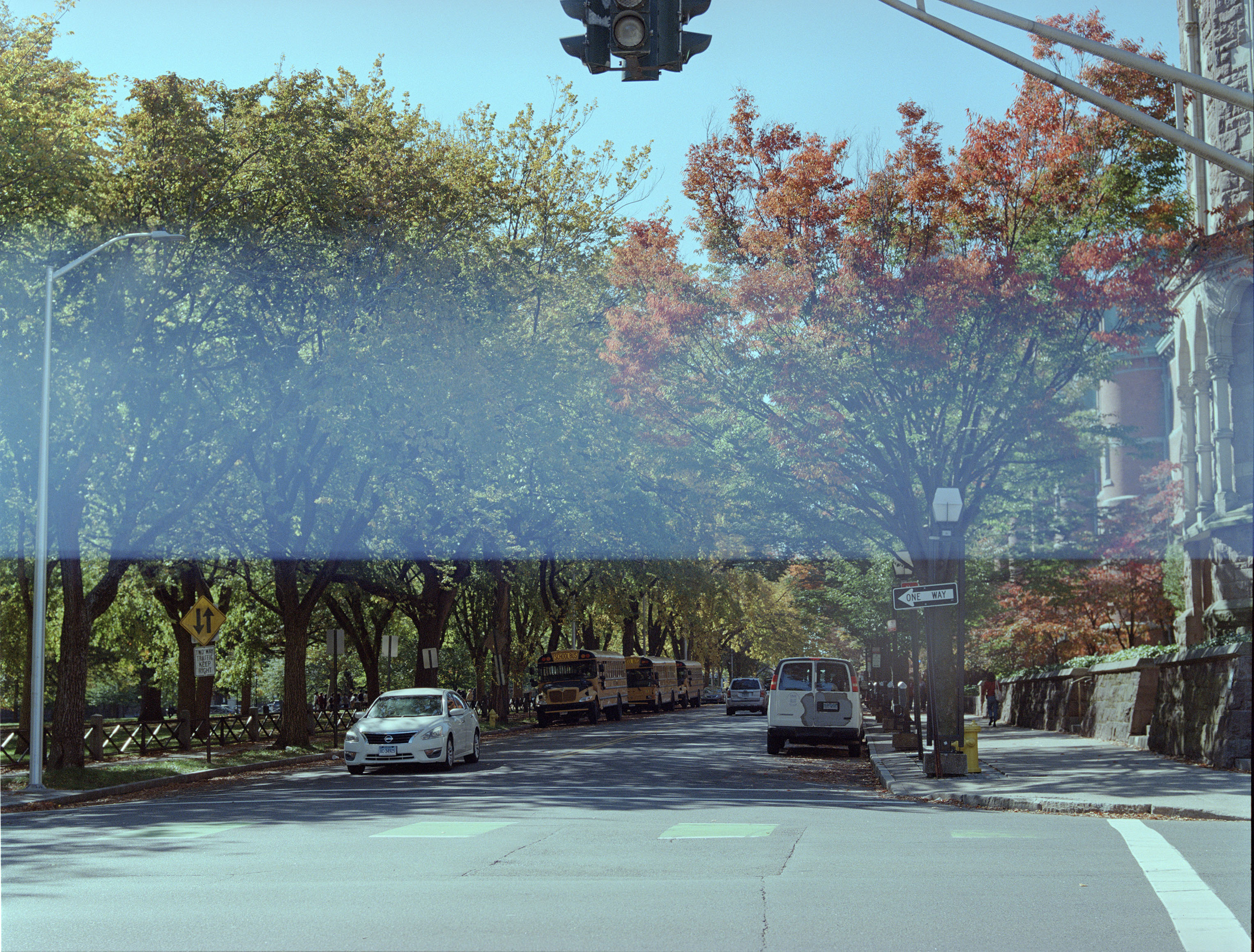

As far as your other issues go, the lens elements not turning sounds like a broken AF ring to me. I have had 2 80mm AFD lenses repaired for that problem. Also, what kind of light leak are you getting from the film back? Since day one, the new back I purchased has been problematic, both with light leaks and frame spacing. The back was returned to the factory for repair (I should have insisted on a new replacement!) but has never performed consistently well. I thought the spacing might be caused by the film inserts--of which I now somehow have 4 and all have been serviced--but I always wonder if a roll will come out as expected or with overlapping frames or light leaks. The camera is a joy when everything works. But unfortunately, I have become hesitant about what I'll get.
The factory in Germany has very few employees and things can take a long time. I prefer to send my Hy6/6008 repair work to Key Camera in Colorado. when he can get parts, he seems to be able to turn around jobs faster than Braunschweig. Still, Dave runs a small shop and things can get hung up there, too.
Thank you for the info. My first 6060 back had a broken gear inside and it took me half a year to get it repaired from Germany (w/ warranty). Then I bought a new 4560... My leak looks like this, which is far more servere than yours. I think the reason might come from the connection between the back and the body... This leakage can be seen on both 4560 and 6060 backs. But I'm not sure what's the reason. I don't know how to veryfy the problem either. The light leakage is in stripe-shape and sometimes it occurs especially when I'm keeping the slide open for a long time, shooting under bright sunlight, and changing the direction of the film back (most of the time its not significant). I always kept the slide of the back open even when I'm not using the camera... I'm wondering is that the reason? Early in this year I tried to finished one roll in 2 hours when I tried to close the slide immediately after exposure. No leakage was observed that time. Another thing to notice is if I'm shooting with AFD180 (which I always kept it capped after shooting), the leakage is somehow alleviated.
