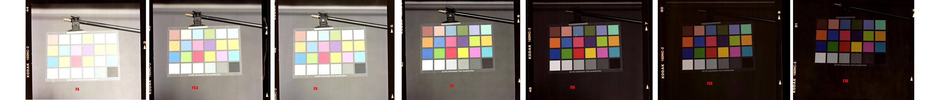

aged and used chem testing on Kodak portra 160NC
Here is a teststrip i did today for testing the long time stability og working solution of my Rolle Digibase C41-chemistry. The one litre of working solution had previously done 15 120 films and been stored in half filled bottles for almost two months now in room-temperature. Strip is done in my studio ona the spot-on reading for this exposure was 1/125 and F11,5 The whole strip is done at 17125 and you can see the aperture on each frame. Developed at standard times from the instructionsheet in a JOBOCPE2.

kompressor. An interesting test. Based on background colour(grey?) it looks as if the spot reading used was correct and yet while the background goes very dark at f16 the colours on the chart look better to me. The f11 shot makes the colours look a little washed out.
I take it that your conclusion here was the developer was still working correctly despite being 2 months old,having done 15 films, keep at room temp and in half filled bottles.
