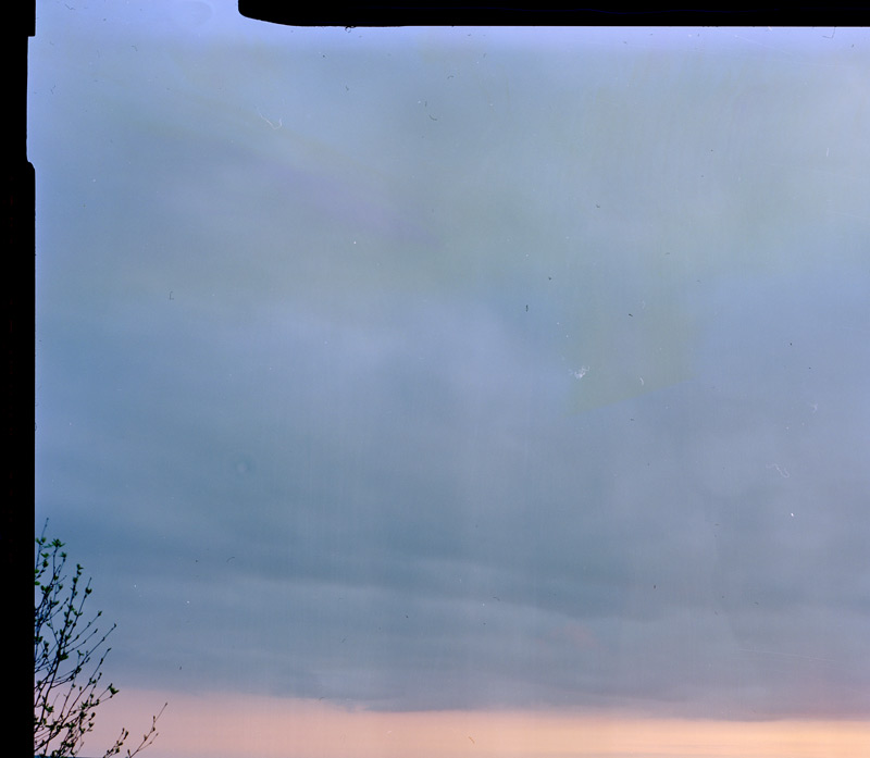

Hi.
I've developed hundreds of 5x4 sheets with the Fuji kit and my CPE processor and I finally decided to give the Rolli Maxi kit a try because chemicals can be bought individually which should be more economical.
I've never had any issues with the Fuji chemicals except one cross contamination issue long ago, results are very consistent. I followed the Rolli instructions to the letter and the negs have come out so bad that the 12 sheets I developed are pretty much unusable. Most have streaks/markings and even some colour variances in those marks.
I'm trying to figure out where I have gone wrong. Processing was extremely quick because they seem to omit washes in the instructions. So on my next attempt I'll add them back in. I've also read here to let the negs sit in the stabilizer rather than have the processor agitating. I've attached an (unspotted!) scan of the markings very visible in the sky - anyone any suggestions?
Thanks

Hi.
I'm trying to figure out where I have gone wrong. Processing was extremely quick because they seem to omit washes in the instructions. So on my next attempt I'll add them back in. I've also read here to let the negs sit in the stabilizer rather than have the processor agitating. I've attached a scan of the markings very visible in the sky - anyone any suggestions?
Thanks
I can't say for the yellow staining, but you are correct in adding washes and the stabilizer. Also, one more thing. Bleach and Fix for 6:30 each. This also helps on making sure there are no artifacts on the negs.
This kit is great IMHO in that of its longevity. I mixed my chemicals back in early September and used them today and got beautiful negs. I can't wait to see enlargements....good luck.
Also, to try and fix the problem on the neg you posted, go back and re-wash. That will help a little. I'm not sure about the staining, but any artifacts or "bubbles" from the stabilizer should disappear.

They STILL come with the erroneous instructions? This problem is as old as the kit itself and has been discussed to death. Rollei must be aware of it. It seems they have no intention to fix any of their problems, as the bottles are still leaking, too.
Add the wash between bleach and fix that is omitted in faulty instructions. Several water changes are needed in rotary processing. I simply use four washes 0:30 each.
Final wash before stab/FR must be sufficient, too. I use seven or more washes 0:30 each.

Thanks, I'll have a second attempt with full length bleach, fix and washes as per Fuji instructions - but I'll perhaps try with a blank sheet just in case. Anyone know if these chemicals can be interchanged with the fuji chemicals? I have a spare Fuji Bleach, Fix and stabalizer due to using developer one shot - can these be used with the Rolli developer?

As has been posted, the Rollei instructions are wrong... washes are important esp between the bleach / fix. I basically just stuck with the process I used with the Fuji kit and it has worked perfectly with the Rollei kit: 2x30 sec pre-washes at temp, 3:15 color dev, 6:30 bleach, 4x30 sec washes, 6:30 fix, 4x30 sec + 2x1 min washes, then final rinse / stabilizer for 1 min. (in a Jobo CPE2+).

After processing with Fuji instructions I now have 12 sheets of 5x4 film beautifully processed. I think I may well stick with the Fuji kits though, other than perhaps some Rollie individual chemicals should they be needed. Providing incorrect instructions is appalling and I dont get why they dont provide enough stabalizer - I assume you are meant to re-use it rather than mix it fresh each time with the Rollie kit.
