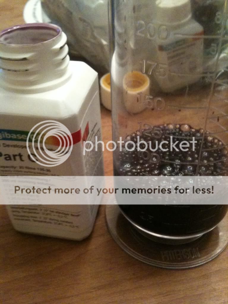

Quick sanity check question: what color should the "Part C" concentrate look like when it is poured from the bottle into the measuring cylinder? Mine is pretty darn opaque / purple, and I am afraid that it has gone bad, but I want to confirm first before assuming the worst. I mainly use this stuff one-shot when developing 120 film in a Jobo tank, and I have to say I have not had good results at all (and I'm comparing against the true Fuji 3 bath kit that one can get from macodirect, which gave me superb results throughout its 5L lifetime). My most recent run of three films (in a 3 reel tank @ 330ml of working solution) produced horrible contrasty images, bordering on overexposed. I want to try and narrow down the culprit, and I believe it is either the Part C or possibly I didn't measure temp precisely enough before starting. Everything else in my process I know I hit spot on as before.
Thanks for the help in advance,
Guy

As far as what color Dev Part C should look like, mine looks like Merlot wine. I have had my kit about a month, mixed half as working solution, you see below the other half, that I have not mixed.

Rollei-Film
Jul 24, 2009
14
Hamburg
127 Format
Statement from Maco Hamburg/Germany:
Rollei Digibase C-41 Kits contain 3 color developer (Part A, Part B, Part C).
Only Part C is sensetive to oxygen.
The original color of Part C is yellow.
After partial use the remaining liquid needs to be protected from oxygen either by adding protective gas or by transferring the liquid to smaller bottles.
When turning from yellow to red this particular developer part is no longer applicable.
These instructions are part of the product specification provided by MACO:
"The very high life period of the original concentrates is min. 3 years.
(Retention samples, produced 5 years ago, are still working well)
The only exception is color developer Part C.
The life period of color developer Part C is 2 - 3 years, depending on the storage temperatures.
Information:
The coloring of the Part C concentrate has to be yellow.
If the coloring changes into red, the concentrate does not work anymore.
In this case, you can buy single replacements for Part C:
#RDC05FC 100ml concentrate
#RDC01FC 1000ml concentrate."
With kind regards,
Sebastian Junghans
