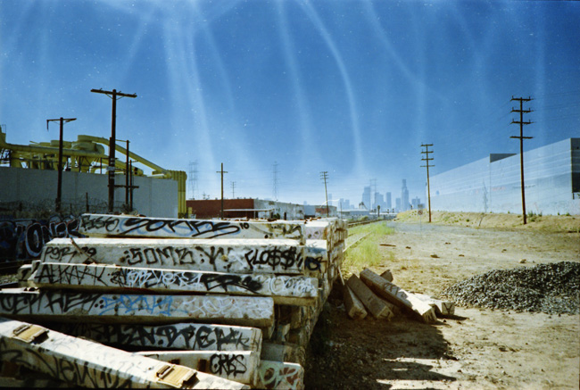

Hi everyone,
Great info and people. First of all please forgive me for my ignorance. Last night I developed for the first time without any previous experience my first roll of 35mm color film using the digibase C41 mini kit. I used as teachers You Tube, you guys, and some books. Overall I am happy that for my first time developing most of it was a success, based on my level of experience. One thing that happened is that some pictures have a whitish streaks around the sky and I want to know if I photographed ghosts or aliens :tongue: or if I made a mistake during developing...
Here is a sample:
All the help is greatly appreciated.
Raul

Yes other photos show the same streak milky lines in the sky area....

Those look like streaks arising from something like liquid rivulets running down the surface of the film prior to it being immersed in developer.

Thanks Matt. What will make this happened? I only did a pre-wash before the developer...
