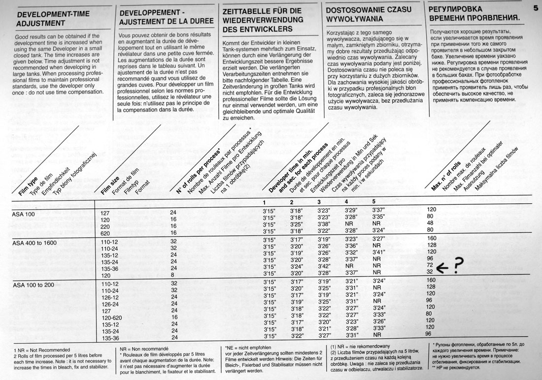

I'm going to mix the first 500ml batch from my 2.5 liter Digibase kit today.
The instructions don't say and I didn't find any info from this thread either: is it necessary to compensate the chemical exhaustion in CD, bleach and fixer times? Should I do the same as with Tetenal C-41 kit: additional 15 seconds in CD time after every 2 rolls of film, additional 2 minutes in bleach time after every 2 rolls of film?
hrst
May 10, 2007
1,293
Finland
I think PE has posted the compensation table (scan from an older Kodak instruction) many times, they are for Kodak chemistry but they should work in the same way. Tetenal should also be same.
Bleach and fix do not need extra time. At least this is the instruction in Fuji Hunt kit. Maybe if you overuse the chemistry, which is not recommended, then extra time can be good then. Tetenal's different because it's a blix kit.
Fuji gives 9 extra seconds after 24 rolls in 5 liter (2.4 rolls in 500 ml), and 18 seconds after the next batch. I attached the FujiHunt instruction. But please ignore the "120" row, it has some error (this kind of phenomenon of 120 film being much different from 135-36 is not described anywhere else).

perminna
Jun 15, 2010
33
Finland
Thanks for the attachement. It didn't catch my eye when I browsed the thread through.
I developed 4 films on Monday. Two 135 films at once according to Rollei's instructions, and then two 120 rolls separately by adding 15 seconds to CD time. I got okay results but I'll look into the chart for the next dev round.
