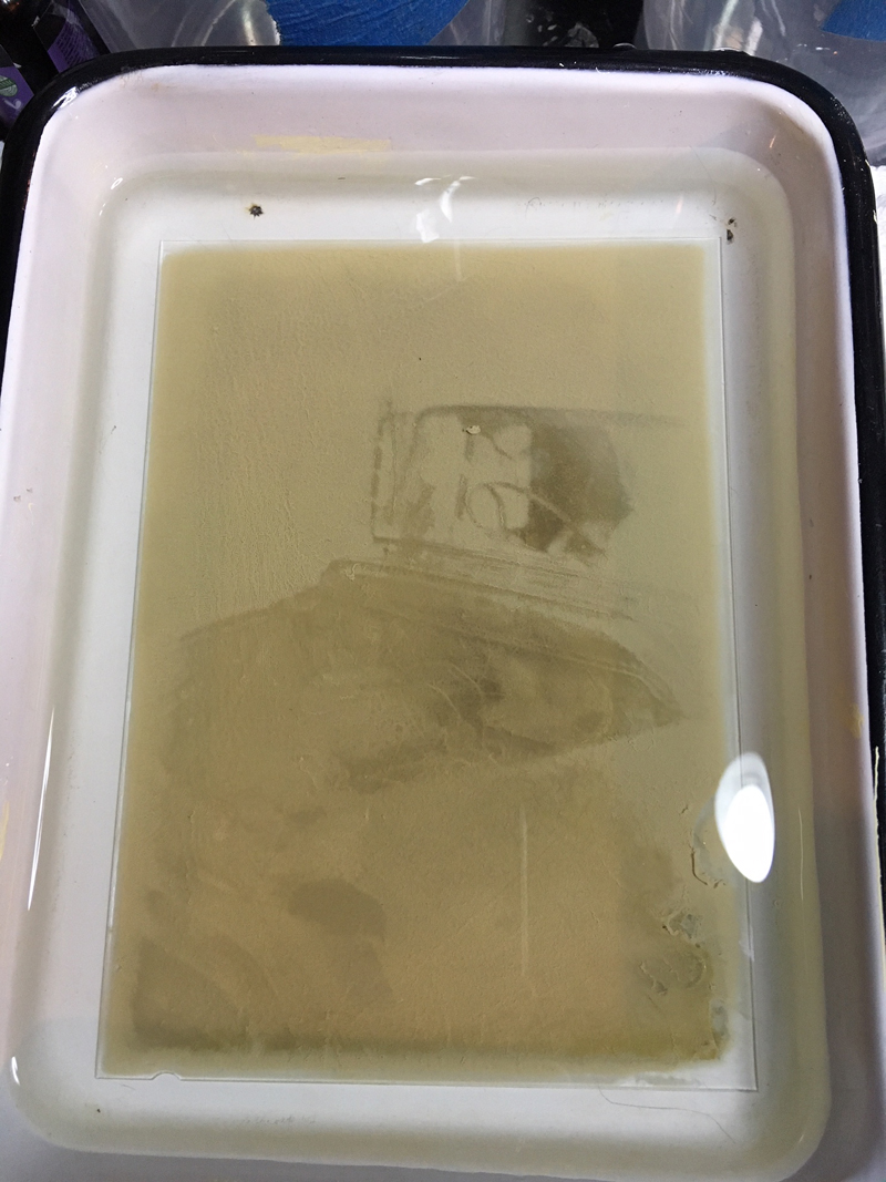

I must be doing something wrong. I followed your recipe, but all I get when I try to develop it is a tan-colored piece of glass. I ordered the chems from ArtCraft, and mixed it up to your specs. I also tried it with a dry plate made by jason lane, and got the same thing. A very faint visible image but other than that, just a blank. If I develop the same plate in a 1:31 L-110, I get a nice negative, but I can't seem to get the positive developer to do anything. It does smell like ammonia though!
After final mixing in of the thiocyanate solution, it should sit 12 hours or so to "season" (per Rockland). I have only used it for tintypes on blackened metal plates, never on glass. If your're attempting ambrotypes on glass with gelatin AGPlus emulsion, I would think it would work, but have not tried this. I mixed up a batch a few weeks back and it worked fine, though. It seems to keep a few weeks in a filled and tightly stoppered bottle in the dark.
hi markfitzgerald
if you put your glass plate infront of something BLACK you might see your postive image.
what happens with the silver gelatin tintype on metal or glass or paper ( black ) is the following
the image develops and fogs, and the thiocyaniate bleach lightens the blacks to be lighter as
the whites ( clear ) show the black of the plate. so ... if you are doing your exposures on clear glass
or something that isn't black you won't really get the same effect.
i've been meaning to do don's recipe too, but life has gotten in the way ..
I agree! The plate should appear as a normal negative against a light background (with less density) and a positive when front lit with a black background. I read that the thiocyanate alters the development process such that very fine reflective particles of silver are formed rather than the dark-appearing tangled threads of silver as in a negative. Dunno’,but it does work...
and looks wonderful when the stars align and work in your favor.

I did let it sit over night before use. I've used the "real" rockland kit before and had some limited success, but this isn't a reversal issue where it needs to be on a black background. it just never clears. It looks like a spudgy mess. Here's a sample of a Jason Lane Dry Plate (pre coated gelatin). After nothing came up after about 10 minutes, I poured some working strength l-110 over it and left it for a couple of minutes while I cleaned up the rest of the trays
. So there is/was definitely something exposed on the plate. I was doubting myself for a bit thinking maybe I didn't expose it. Maybe I'll start over with another batch. I do still have some of the Ammonium Thiocyanate stock solution so I should have three more attempts at it.
I did let it sit over night before use. I've used the "real" rockland kit before and had some limited success, but this isn't a reversal issue where it needs to be on a black background. it just never clears. It looks like a spudgy mess. Here's a sample of a Jason Lane Dry Plate (pre coated gelatin). After nothing came up after about 10 minutes, I poured some working strength l-110 over it and left it for a couple of minutes while I cleaned up the rest of the traysView attachment 196091 . So there is/was definitely something exposed on the plate. I was doubting myself for a bit thinking maybe I didn't expose it. Maybe I'll start over with another batch. I do still have some of the Ammonium Thiocyanate stock solution so I should have three more attempts at it.
I wonder if the issue is that I’m trying to use liquid light? I am getting nothing. The stuff just stays tan in the developer. I did overheat the bottle a bit when I was transferring to smalller containers. I’m sure that didn’t help...
are you using regular liquid light or vc or the ag+ or are you still using jason's plates ?
if you are using liquid light doulbe coat your glass, that is the advice i was given by the
guy who founded the company, the ag+ has more silver in it so it gives a stronger image
he suggested double coating would be better for non ag+ emulsions.
if you suspect your emulsion is bad, coat a scrap of paper and put a penny on it and turn the lights on
and put it in regular developer ( dektol type developer )and see if the image is white and black
liquid emulsion is pretty slow ... i've used some that was like 15 years old and gotten it to produce images it needed
more light and stronger developer ( and fixer wtih hardener ! )
you can make a test strip with a regular piece of paper to ID your exposure time too ... just like under an enlarger..
maybe you are under exposing / over exposing your image ..
