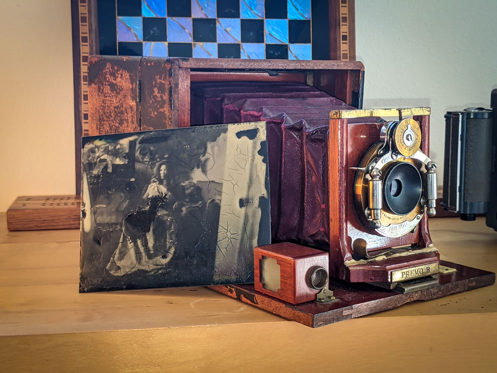

I just used the Rockland Tintype kit and shot on my 130 year old Premo B camera ... and ... well ... it worked. Really fun process, but you definitely work for it, and I think their development times listed in the instructions are nuts... anyway, did a write up and video https://cineclast.com/2021/02/04/using-a-130-year-old-camera-to-make-a-tintype-photograph/
