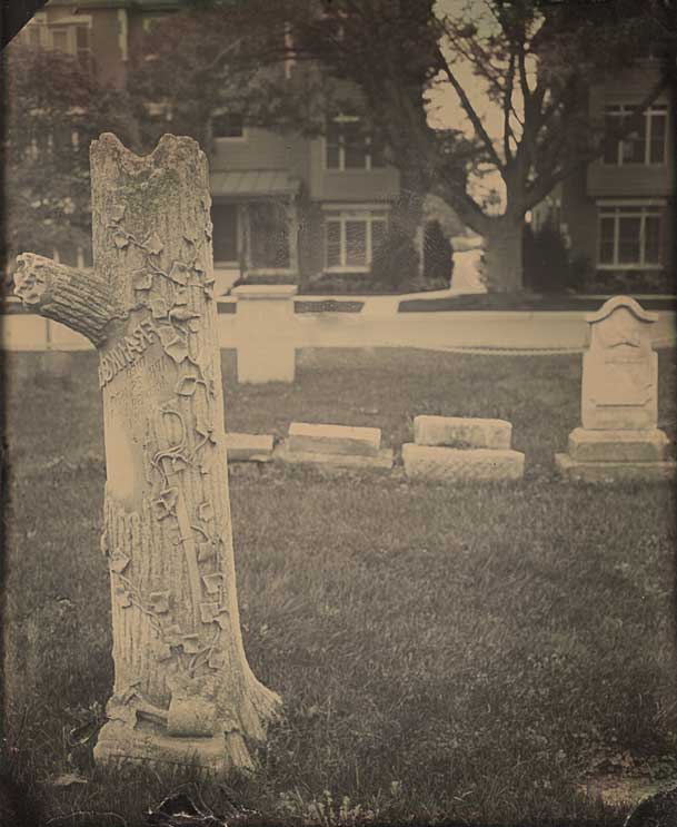

Here are a couple from Friday of my son and daughter, plus a nostalgia shot...

My daughter and I switched back to the Rockland AGPlus emulsion tintypes after 8 months of shooting collodion. Not bad for our first efforts in a while!

We are definitely not done with wet plate, but wanted to hit the field in the nice weather with a newly-acquired Graflex Super Graphic 4x5 camera, and were not up to putting together a mobile darkroom!
The old developer from last year was the color of black ink, so we mixed up some fresh reversal developer from dry ingredients on-hand and broke out the unused bottle of AGPlus in the fridge.
I discovered a red safelight can be used at pretty high levels without fogging the emulsion! I use a 25watt "party" red LED bulb from Lowes, pointed upward at the ceiling. Before we were using a dark amber light that gave about as much light as a match. What a differences, both in plate prep and processing!
The added speed of the gelatin emulsion is nice, as it has some latitude for greater depth of field. We also tried it for the first time with our 4800ws and three Speedotron Black Line flash heads. We needed to go to f/16 with those, where we would be shooting at f/4.5 with collodion. That was fun.
There is also a different "look" of the finished plate with the gelatin. Reticulation is still a bit of an issue.
Almost all the plates we shot last year that I had sprayed with an oil-based polyurethane varnish cracked/separated from the plate! This time I used a water-based acrylic artist's archival-quality varnish, which is poured on and the excess dripped off of a corner, then laid flat to dry. We use that on wet plate instead of the traditional sandarac varnish with great results. It seems to work well on the gelatin emulsion so far.

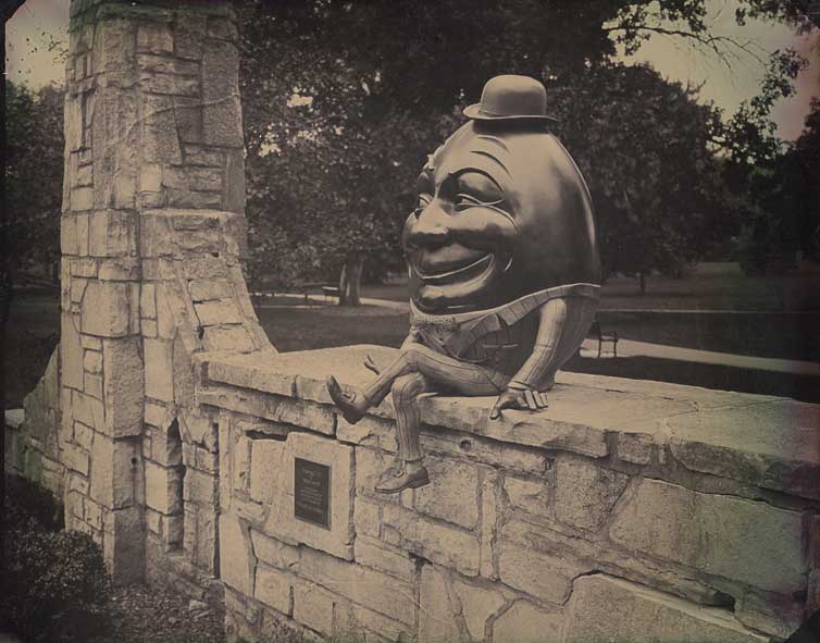

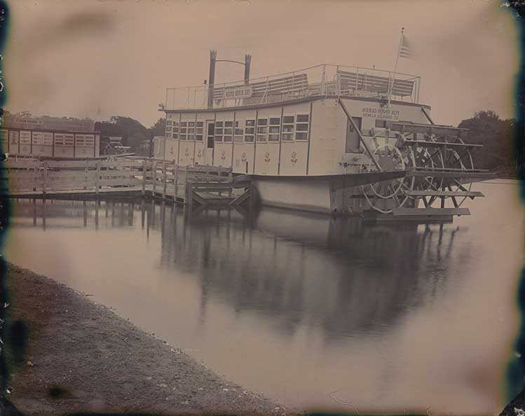

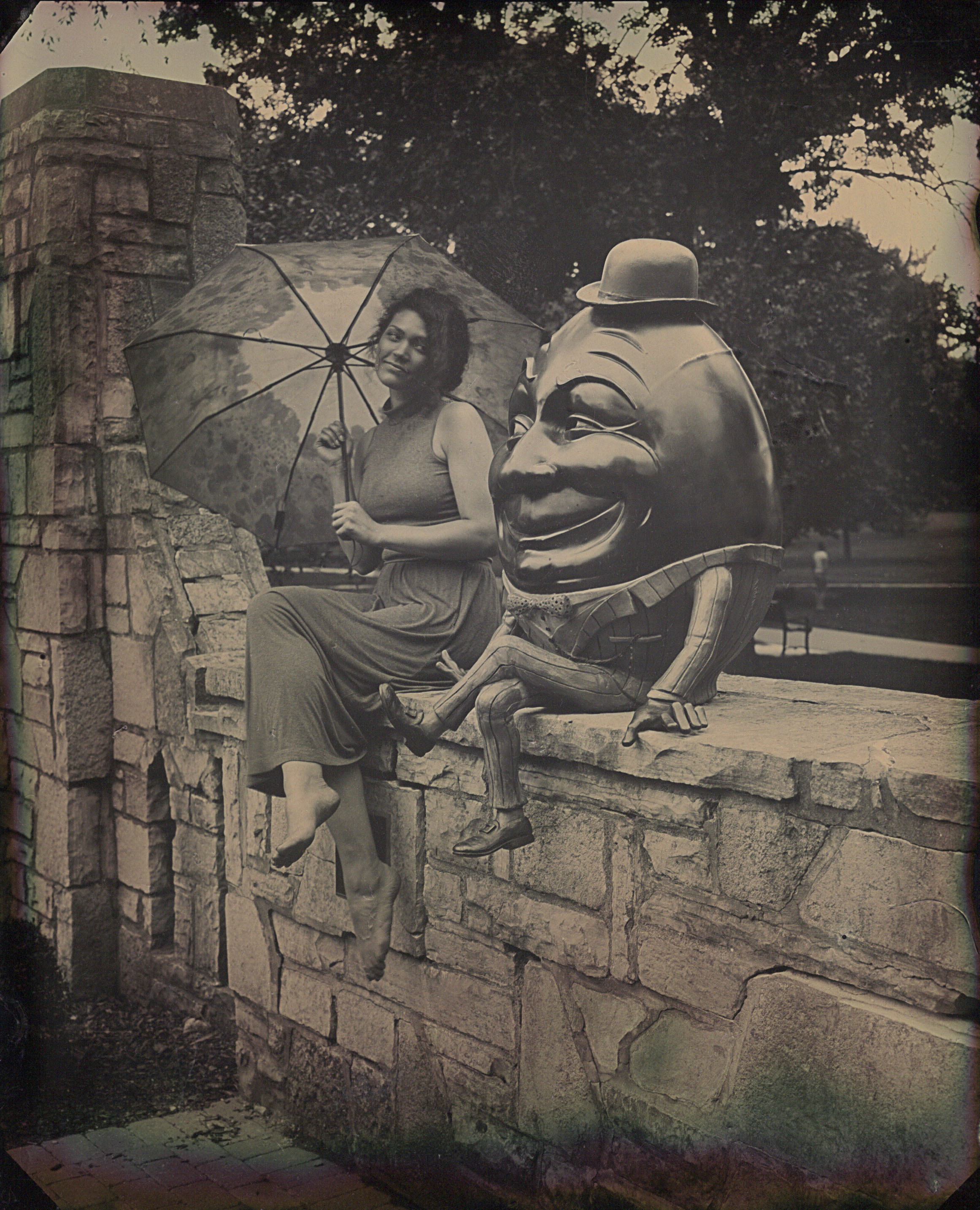

Just a few more recent shots. Getting the hang of exposure-setting. Tricky and little room for error.
