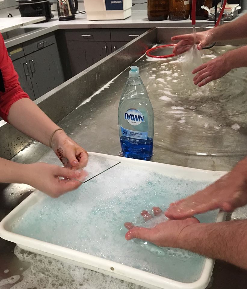

Now, I know that the main thrust of this thread is coating on metal, but I thought I might stress again how simple this can be.
Mark Osterman and Nick Brandreth teach their students that washing in plain water with Dawn detergent, then rinsing and drying in plain tap water will do the trick. No hardener is used in the coating and the negatives are just fine. It is not a complex problem requiring undercoats, special treatment and other aids. Just wash, dry and coat.
Thanks to Mark for this photo. See more on his Facebook page.

That said, maybe Don can reiterate for us what issues he was having in the beginning that led him down this path. He's getting good results in any case.
PE
The issues I had with the tintype plate surface began when I switched from the anodized plates supplied by Rockland Colloid to the shiny enameled plates as supplied by Main Trophy Supply. After the switch, I began to have significant issues with the edges of the emulsion loosening during processing. I also had increased reticulation and a very uneven surface to the emulsion after drying.
The anodized plates have more of a matte finish that seemed to supply some "tooth" to which the emulsion could adhere. The glossy Main Trophy Supply plates have an almost mirror finish. These are likely great as is for making collodion plates.
I found lightly dry sanding the plates with 1200 grit wet/dry sandpaper solved the adhesion problem without any additional subbing or surface prep being necessary, other than scrubbing the plates thoroughly with a finger and some powdered washing soda a few times after sanding, rinsing thoroughly, then drying. I omitted the Photoflo rinse after washing, as I seemed to get poorer results with the residual Photoflo on the plate. Dawn would probably work as well or better than the washing soda, as it is an excellent degreaser.
I still have slight reticulation issues with the prepped plates, but a post-processing coat of crystal clear spray varnish (3 coats) fills in the minor irregularities and results in a nice smooth finish on most plates.
