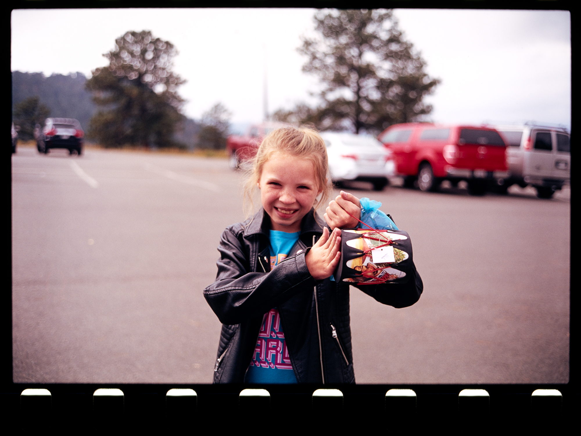

I tried this with a new type of paper I haven't seen mentioned, well, really anywhere. Mitsubishi RA-4 paper. It's available super cheap from Ultrafineonline, but it is definitely expired and will not produce pure whites (slight yellowing) in normal RA-4. Haven't seen any obvious problems in RA-4 reversal though, but I mean this process is pretty experimental anyway so who knows.
(copy from a reddit post about it)
Made with Mitsubishi Color Paper. Process (all room temp in open trays, ~21C)
  • Dektol 1+3, 800ml total with 5g of bromide to "pre-age" it -- 2 minutes in darkness, constant agitation
  • Citric acid stop bath
  • Re-expose and rinse (I found no difference between waiting 5 minutes for re-exposure and dunking it into color developer immediately after rinsing)
  • Kodak RA-4 color developer -- 1.5 minutes
  • Kodak RA-4 Bleach-fix -- 1.5 minutes
  • Rinse
Exposed at an 8x10 from Provia 400X. Exposure time of 22s, filtration: 110Y, 55M. Some dodging in the middle flower. Overall results are pretty impressive. I've not seen non-terrible prints from RA-4 reversal previously. Compared to Fuji CA this paper responds with significantly lower contrast (though still pretty high), and most importantly, with very small amounts of visible mottling which resembles film grain, rather than ugly blotches. Mottling that I'm still not sure isn't just my crappy grainy positives.
I also exposed a C-41 film positive for fun. The filtration on this surprisingly was thicker than the non-orange based E-6 film. I believe it was around 130Y and 90M. This may have just been due to the C-41 film having a lot of blue cast though. Contrast was not a problem at all with the C-41 film positive though, since C-41 film is naturally much lower contrast than E-6.
Here is an example print from the C-41 film (notice that some of the crappy color and color crossing are due to the C-41 film and not "missing" on the paper)

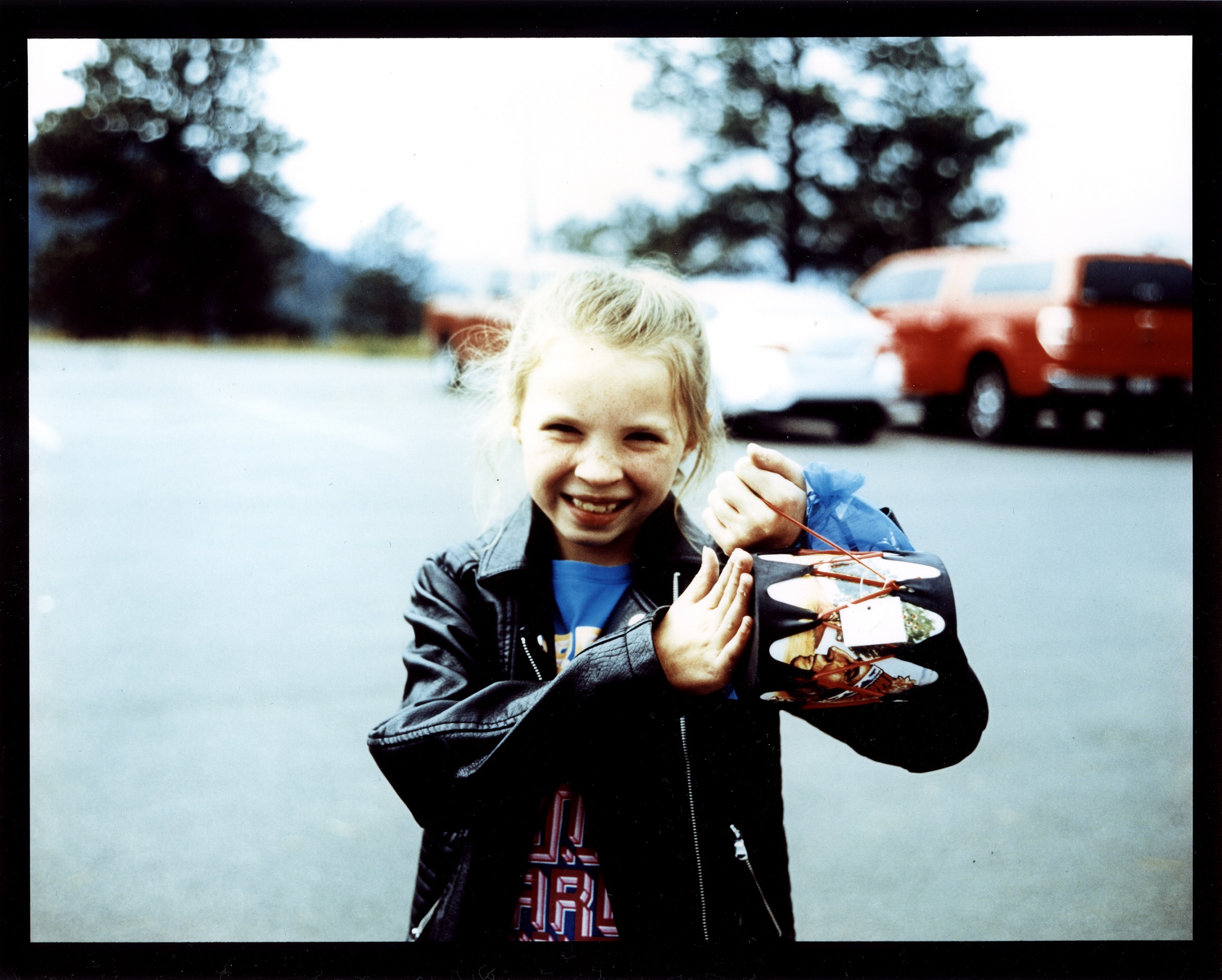

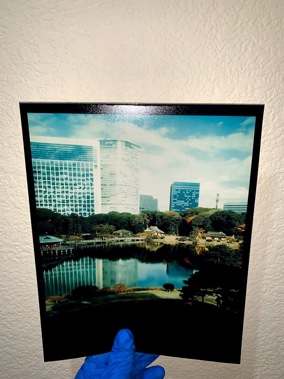

Another test run with RA-4 reversal, this time with fine grain medium format, so that film grain is not a question. Lets get down to it
Process:
* All in trays, room lights on after first stop bath
* First dev, 2m, room temp
* Citric acid stop bath
* Water rinse (sink)
* Kodak RA-4 developer, room temp, 1.5m (I think 2m is probably recommended here though for better saturation)
* Citric Acid stop bath
* Kodak bleach-fix, room temp, 1m
I did a ton of prints using a filter stack of Y90, M20, f/11, 10s, slightly smaller than 8x10 print. Basically I just modified the first developer each run to try to get a handle on the effects of each without more variables. Each print came out with some blue cast and slight over exposure but I didn't want to mess with the consistency of the tests so I left the exposure and filters the same. Order of tests:
* Dektol 1+3, 800ml (unmodified) -- Very high contrast, seemingly faster paper speed though without much more shadow detail than later runs with the same exposure
* +10ml 1% potassium iodide - This came out as a surprise, it seemed to fog the emulsion. Everything came out red including blacks, and highlights were significantly more blown than the unmodified version
* Remixed the developer to remove iodine
* +9.2g of bromide -- Significantly reduced contrast (but still high), significantly less blown highlights, slightly less shadow detail
* +400ml water (convert to Dektol 1+5) -- Very slightly more highlight detail, orange splotch on specific highlight area
* +4.6g bromide -- Same as the 400ml water addition, but orange splotch grew bigger
* +1m of dev time -- Orangle splotch went away, and print looked identical to the step for +9.2g of bromide
* 10g bromide (with +1m of dev time) -- All whites had a yellow tinge, though there was not a noticeable orange splotch. Overall detail looked the same though
My final print that got the best results was by remixing the developer and starting almost from scratch:
* f/11, 9s, Y120, M30
* Dektol 1+3, 150ml to make 600ml, added 7.5g bromide
* RA-4 dev for 2 minutes
Best result:

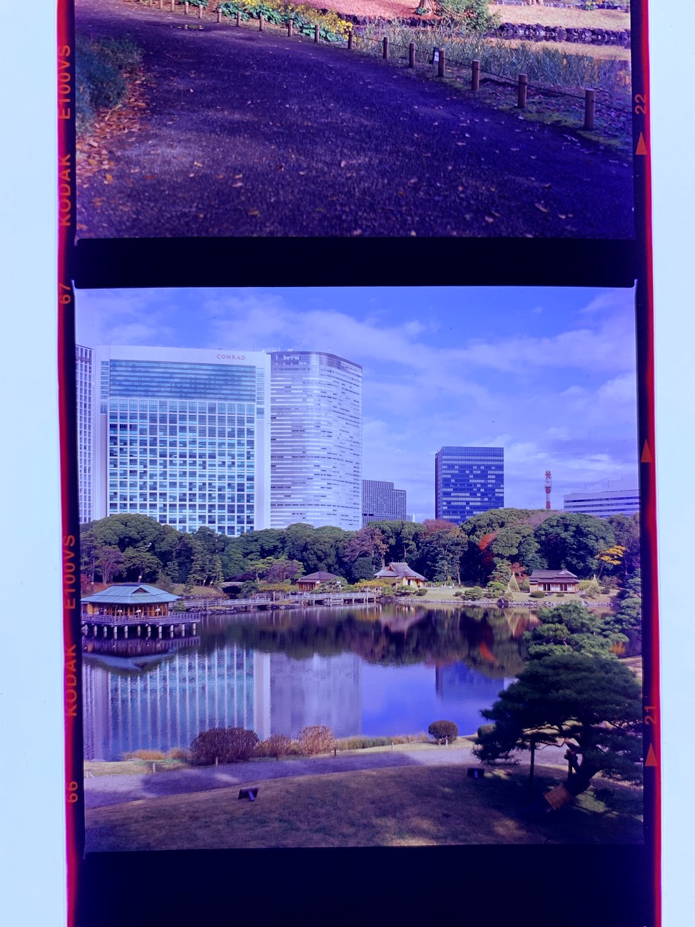

Image of raw slide (expired E100 VS so had some purple cast, unsure if that worked against me or not)
Crap cellphone pictures, so white balance is kinda screwy, but they each about match what it really looks like
Conclusion:
Mitsubishi RA-4 paper seems to be the only suitable paper with minimal artifacts. Even in the solid color areas in this print, there is no perceptible grain or mottle. There is a slight decrease in sharpness that may be due to the luster finish.. and of course, there is quite a bit of color crossing that can be hard to tame, as well as a very narrow exposure latitude and high contrast that makes highlight detail especially difficult. If I really cared about this print, I probably could've dodged and burned my way to having something close to what I wanted, these are all just straight prints and I'm lazy though.
I've discovered in previous tests that adding sulfite to the RA-4 developer can help to reduce contrast, but does so by attacking blacks, so I don't really consider it a good solution. Have not tried that with this paper yet though. If using Dektol as the first developer, significant dilution is not the answer to reducing contrast. It only really increases development time and too short of development times will result in orange/yellow whites. Bromide does seem to have a real effect on taming the contrast with Dektol, but it seems to top out at a point. Afterwards adding more bromide only slows development and will not reduce contrast further, nor adjust color balance. Adding bromide also reduces the amount of blue in the print, helping to cut down on the amount of yellow filtration needed, though a lot is still needed typically.
The response of the paper to exposure changes is extremely sensitive. At 10s the print looked somewhat overexposed, and at 8s the print looked somewhat underexposed. The adjusted time of 9s was perceptively different and looked about right, though still with some missing highlight and shadow detail compared to the slide. On B/W paper a 1s difference would be barely perceptible, but with this process it really requires a lot of testing and it seems like f-stop based exposure adjustments will not work here

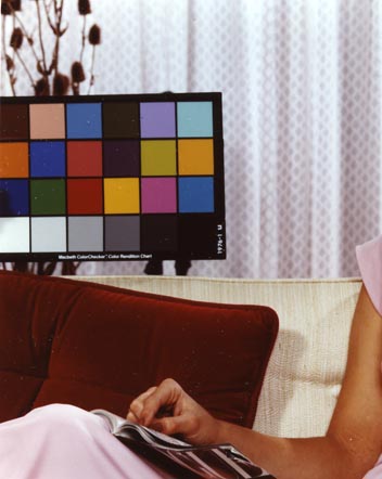

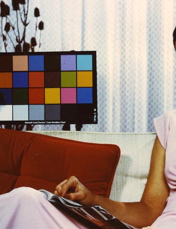

Well, here is one of my results. One is cross processed from an Ektachrome original, and the other is an RA4 print from a hand made Internegative. I have the scan of the transparency as well and the same thing done as an Portra original around here somewhere.
PE
