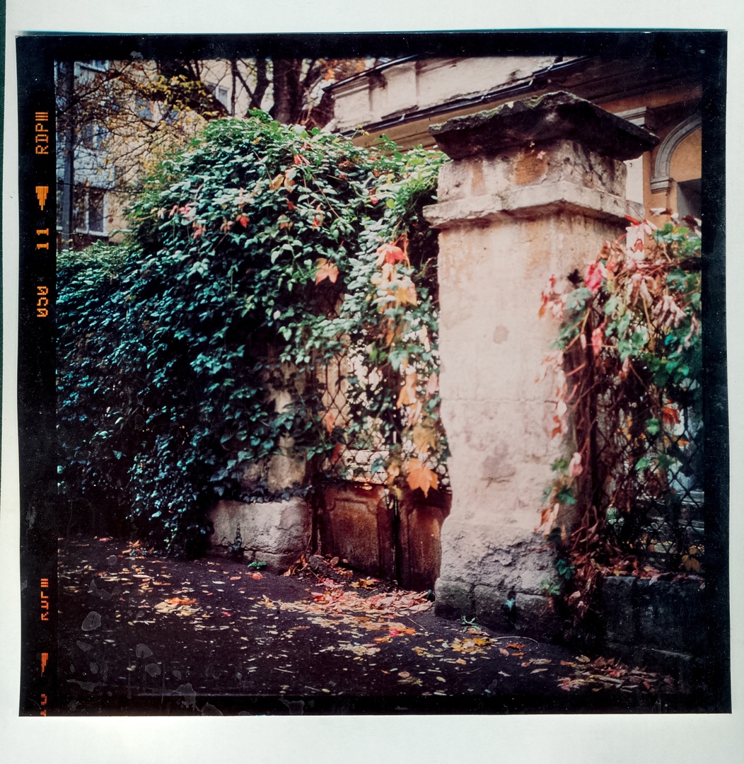

I've decided to continue my experiments with RA-4 reversal. And finally... I can actually say, I was able to get some photographs which look close enough to the original slides. Besides that... I've even found a way to print portrait photos without a too strong contrast. The whites are clear, the shadow details aren't really bad,
That's the original slide. As you can see, all of the shadows detail are still there. The prints shows some kind of posterisation in the sky area, but it's possibly because of uneven masking. The colors are VERY saturared. The color balance is a bit different, but it's actually fixable during printing.

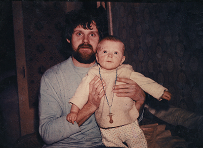

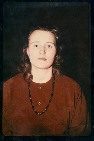

I've also decided to try printing some photos, using my family's old ORWO slides. Those are pretty much low in contrast and it worked very well.
The colors are as close to the original slide as possible. The skintone is very nice.
This one is a bit less saturated than the original slide, but it's fixable anyway.

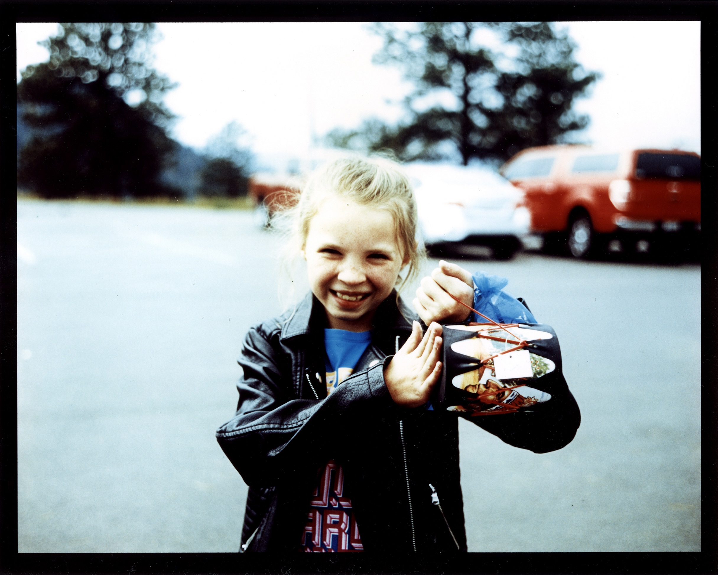

I made my own first developer for RA-4 reversal, and the results are quite improved in terms of color balance and consistency, but I think I've pretty much hit my limits on reducing contrast with this paper.
Lets call the developer.. uhh, "RFD-1"
* 800ml of hot water
* sodium sulfite - 15g
* potassium carbonate - 15g
* HQ - 2g
* phenidone - 0.4g
* thiocyanate - 1g
* pot bromide - 1.7g
* iodide 1% - 1.4ml (1.5ml should be safe)
* fill with water to 1L
Usage: undiluted, room temperature (~22C), 3m development time with constant agitation. 2m will give slightly less contrast but also will have slightly warm grey whites and more green color crossing in shadows
The developer was designed to be a fairly alkaline developer for how much developing agent was actually in it (rather than resembling just a diluted developer). It was inspired by a combo of a homemade E-6 first developer recipe and a low contrast print developer. The amount of iodide and bromide was hand adjusted after mixing. I basically wanted something that would be low contrast, but also develop a good dmax (in negative). I also wanted something a bit more friendly than metol so I used phenidone. The amount of HQ is purposefully "inadequate" just so that it would behave mostly like a phenidone only developer, but with more stability and longevity, and also to further help dmax. The thiocyanate is another addition for improving dmax helping the whites "run away" a bit. The amount of bromide was initially 1g, but increased to 1.7g to slightly reduce tendency for highlights to clip at the 3m developing time.
The results were pretty surprising. It effectively makes the paper about 3/4 stops faster than D-72 with bromide/iodine and/or Dektol. It also requires a very different filter stack than I was using with Dektol/D-72, a lot less yellow and magenta filtration needed. With this, you will get some yellow looking stains around the edges of the print after the first developer. This appears to have no actual effect after color processing though.
The main benefits of this first developer is that it still pretty much minimizes as much contrast as possible from the high contrast RA-4 paper, but will also give very deep blacks, and brilliant whites. Color balance, and especially reproduction of the color green also seems to be a bit better compared to D-72/Dektol, though still not particularly great.
One other discovery. Color balance does not work the way one would expect. Removing yellow filtration will increase the amount of green. Decreasing magenta will increase the amount of blue. It can be really difficult to judge what the true results of a filtration change will be. Also, exposure latitude is still very narrow and even a minor filtration change like adding 5Y may require adjusting the exposure time.
Best print of the night processing:
* f/8, 8s
* 35M, 90Y
* 3m first developer, constant agitation
* 2m in color developer
* 2m in bleach-fix
Scanned print (edited the scan a bit to match the look of the print)

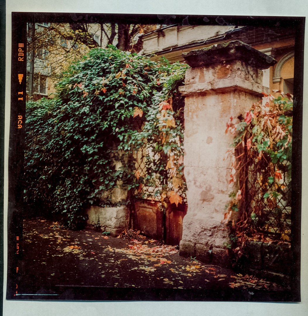

So, it took 4 years to master the process. I tried a lot of papers and first developers, read a lot of old books and articles about processing slide films. And here I am, after all.
The first developer gives you an opportunity to make a whole bunch of prints without any noticable changes. It can also be replenished. I'm not going to post the formula, because it's now too good to talk about it. It gives zero fog, clean whites, zero color crossing and there isn't any kind of mottling (at least with the paper I use). I've tested it with only Fuji CA papers so far, but it works just great.
But ofc, it doesn't change the high contrast problem of the process. I mean, at all. You either use some old-contrast slides or use contrast reducing masks.
So, here we are, this picture is a scan of the original slide:
And these pictures are two prints from the slide, but with two different color corrections. You can also notice that the brightness and colors look a bit different from the original slide, it's caused by using an orthochromatic lith film for masking, using a panchromatic film will give me a result, which matches the original perfectly.
I hope I've inspired you to continue working with that process, because it isn't just some kind of lomography, it's actually a real way to print your color slides in a darkroom!

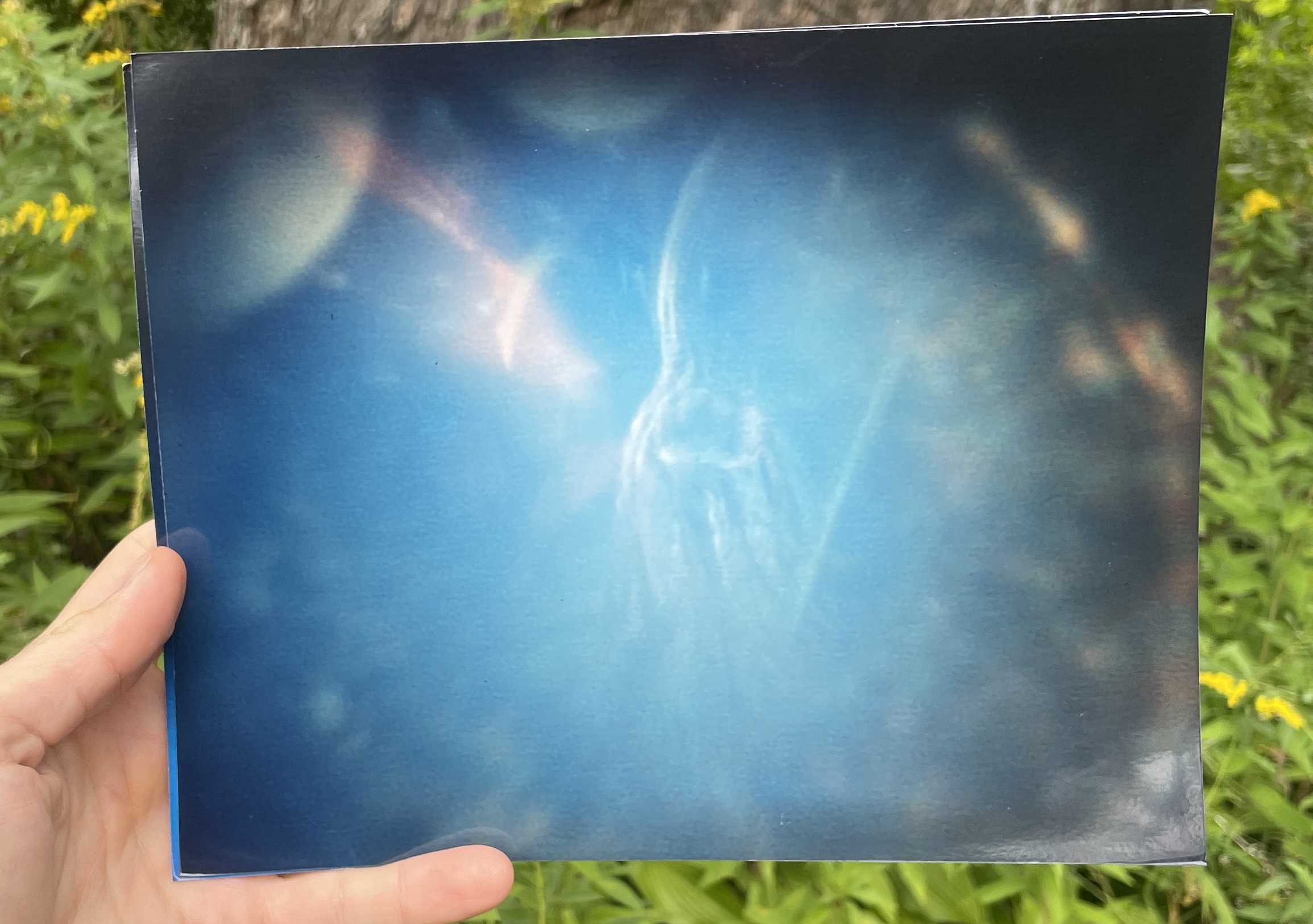

I've been experimenting with ra4 reversal and just shot a 7h45m exposure with a pinhole camera of some small subjects.
Despite my filters the print turned out blue (after many experiments). The ra4 developer appeared pinkish by this time, 48 hours after I had mixed it (i know, i know, not great). I put it through blix and wash etc...
I am wondering if it is possible that the some of the blueness is due to the developer being spent? I am wondering if I put it through the developer-> blix -> wash again when I next make chemicals if it might color correct a bit, or if this ship is sailed once it touches the blix.
maybe a stupid question, but open to any thoughts. It was shot with a bunch of red and yellow filters, based on the previous exposure (processed 24h earlier) I believe the filtration was correct or at least close!
thanks in advance

Expired developer will indeed show up initially as the blacks in the print not developing beyond a rich blue tone. So if you're talking about areas in your print that are blue but they should be black, then yes, the developer is the first place to look.
If you can upload an example, I can comment more specifically.
No, you cannot re-develop an already blixed print.

thanks so much for taking the time to respond! is it possible that it's so blue due to the developer being spent? I think it was spent. But your description is the opposite of what happened, the print didn't really develop blacks. Any thoughts very welcome
