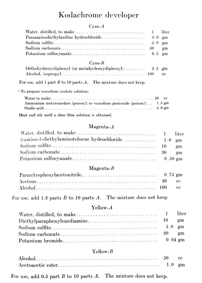

The pink elephant in the room, to my mind, is the coupler chemistry used. So far there's been no mention of it by Stephen, though much more curiously, no one has asked.
Is this something you'd be willing to share?
I've noticed many times in the past that Mssr. Frizza will achieve things that just blow people away here, and he's always quick to point out that none of it's magic; it's a result of actual work, understanding the process and simply doing it. I greatly respect this, and it's model behavior in an internet community that's all too content with typing thoughts instead of doing actions. (*guilty as charged*) That's probably why we don't see him so often either.
With that in mind I wouldn't expect to have the whole process divulged just for asking, but I do think that if there is no incentive to keep it "proprietary" (and perhaps there is) then the details might be useful to someone who actually wishes to give this a go at some point.
On the other hand, I can understand how sharing it might cheapen your hard work. Hell, at least Daguerre got a life-time pension for giving away his process...
p.s. On "(there was a url link here which no longer exists)", starting around post #3010 there is a discussion of color developers.
I havent gone into extensive detail simply because anything i write will pale in relation to the wealth of information already available online about every aspect of the kodachrome process. The extensive information on the chemistry, the processing and the film can be found in public domain by kodak. For interest this patent which is wonderfully half the work of Photo Engineer is here....

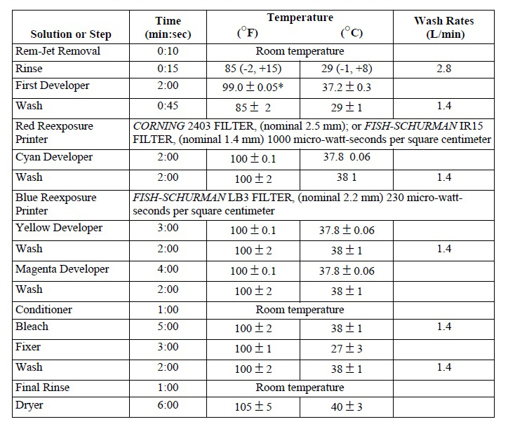

alternatively something more primitive you can try is....
If you want to know some info about the processing steps....
Processing Steps as per kodaks direction....

THATS A BASIC OVERIEW OF THE PROCESS AS DESCRIBED BY KODAK.
and here is a chart outlining the times and temps etc of each processing step...... (when hand processing certain times like the rem jet removal and wash time will need to be adjusted)
And any other detail under the sun about kodachrome from the way the film is made to the way a K-lab machine works can be found online in the Z-50 tech pubs, there is also the Klab user manuals etc...kodak have openly available everything and anything you want to know. I'm not going to re write the ins and outs of publications that in common knowledge already exist.

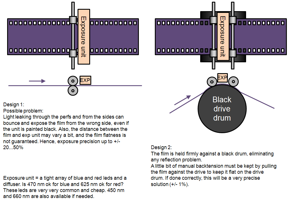

Magnificent! Any chance of copy-pasting everything posted on Facebook here? In things like these, reviving dying information etc., I believe in "open source".
Hey, it would be simple to build a very small re-exposure device. It would include a small stepper motor to advance the film strips at a constant, adjustable speed, and selectable red/blue LED light source very close to the point where the film is driven from. This way, the exposure can be controlled to very high precision with very small lab space requirements and easy&quick operation, with no limit for film length whatsoever. I bet there are many electronic/mechanical tinkerers like me at APUG who could do this.
Here, to elaborate on the re-exp device mechanical design.
Either one would probably work.
Remember that the top two layers are not red sensitive and so the top two layers would not be very sensitive to leakage. Then again, the bottom two layers cannot see blue light but are sensitive to it so that might be a consideration there.
PE
