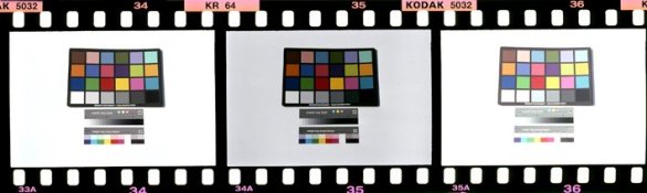

Hello Apugers
I have been very quiet on APUG lately and have been busy in my lab doing some experiments and tests. As it seems this Kodachrome one ended up online here as a result of me posting it on my personal Facebook Page.
There are some things I should mention about this test....
1stly : I have absolutely no intention of offering it as a service. The Cost, The limited amount of chemistry I have for this process and the fact no new film stock is being produced means this just wont happen.
2nd : While the thread states HOME processing people should be aware that I am working in a fully equip professional photographic lab which without I could not have done this process.
3rdly: While Kodachrome is process K-14 I did not strictly process this in k-14 chemistry. It was processed using an butchered version of this process and other improvised adaptations which can yield a result but the chemistry does not keep nor can I guarantee the archival properties of the final product. Its a one shot process.
Thanks for the interest in one of my personal tests .
-Frizza
