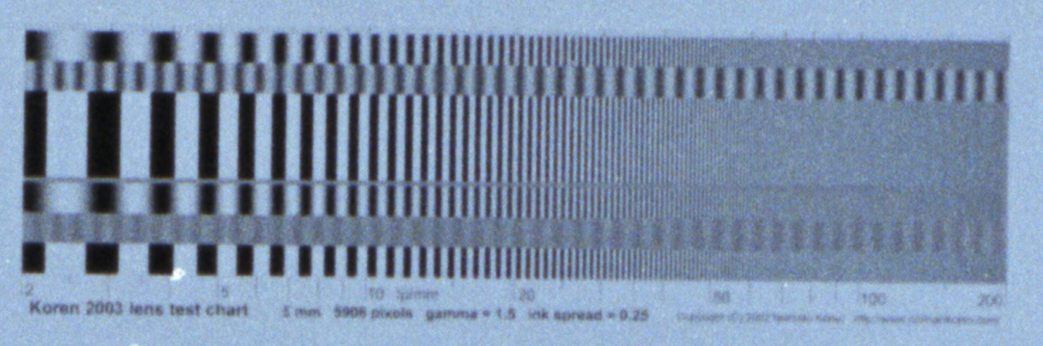

Well, it's taken me a while, ok, a very very long time, but here is the scan of Portra 160 at 7200 ppi on the reflecta RPS. I think it resolves to about 60 lp/mm...
