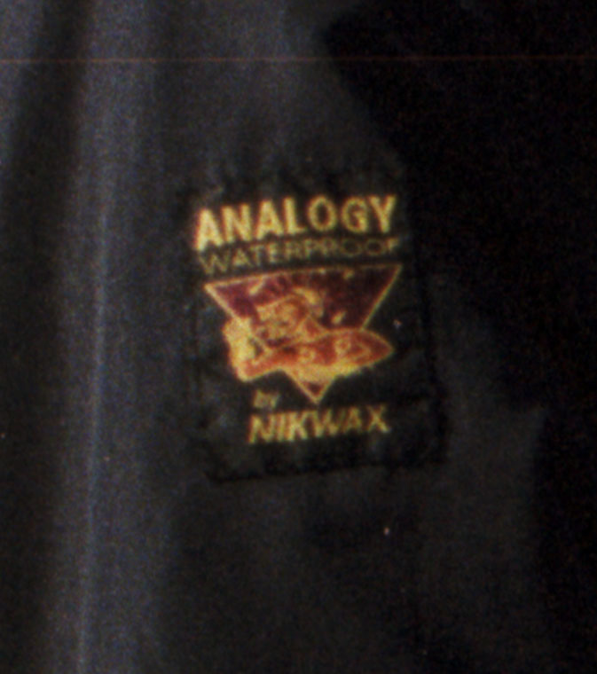

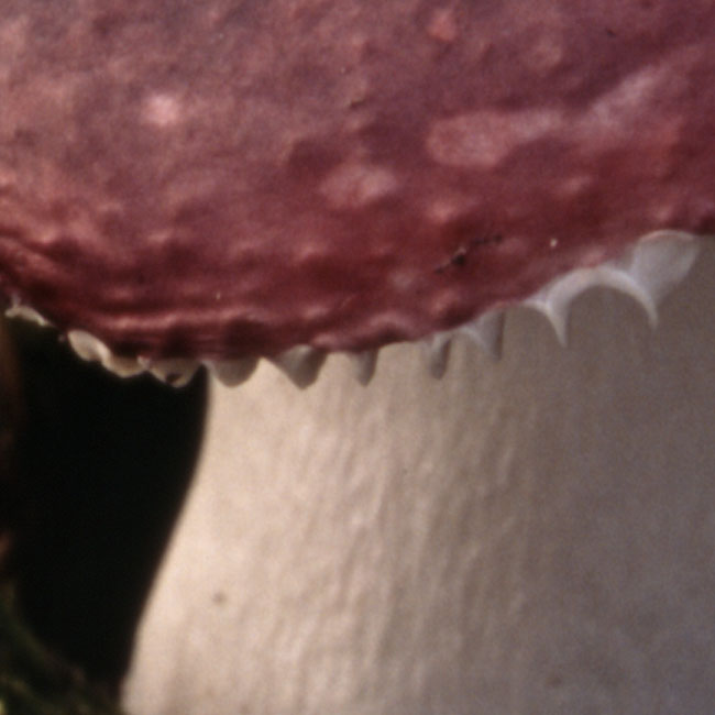

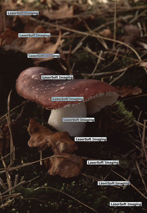

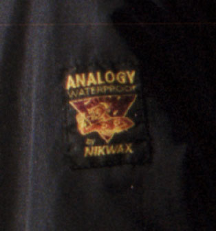

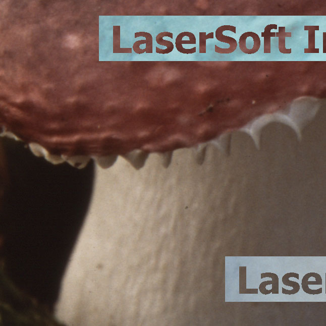

OK, new scans. Both Epson V700 and Reflecta RPS7200. Image is from Provia, tripod mounted camera (Nikon F4, 105mm macro), probably a tad underexposed. Scans are at 3600 dpi, within the maximum of both units. I chose that value as it's half the maximum theoretical resolution of the Refelcta, and also it's plenty big enough! Scans are done via Silverfast (licensed copy for the Espon, trial for the Reflecta, hence the watermark). No manipulation was done other than a very slight adjustment to the histogram. Here are the full images, resized for here. First the Epson then the Reflecta.

And now detail taken from the original .tiff file, again first the Epson, then the Reflecta.

My view of this, after looking at the full size .tiff files at 100% is that there is a tiny bit more resolution coming out of the Reflecta rather than the Epson. Hardly noticeable, but it is there, just. Superficially, the Epsons look better scans, more contrasty, punchier colours, but the Reflecta scans are easier to post-process. They sharpen better, and you have more scope for contrast adjustment. This means you do have to spend more time sorting them out, but I guess you could put most of it into a batch process, I do that in Capture NX2. The bottom line is that you have a ÂŁ500 Epson scanner that does 35mm, MF and bigger, and also reflected scans, vs ÂŁ500 for a scanner that does 35mm only (plus the cash for Silverfast/Vuescan). The Reflecta is no doubt easier and faster to use, you just load the film in, and away it goes. The Epson has fiddly holders and is a nightmare for dust, and on that note, the Refelcta is much better. I've spent a lot of time setting up the Epson to squeeze the most out of a transparency, I'm not there yet with the Reflecta. It's certainly no magic bullet, but it means that I can happily carry on using film and getting it onto digital medium. Having compared my scanned slides with images from my Nikon D700, the D700 wins in terms of resolution, no contest. But to be honest, it's dull, no fun to use. I like my F4, I like being slow, I like taking only a few images of each subject and thinking about it more. Given that a 3600 dpi scan, and a Nikon D700 will print to 12"x16" easily, how much bigger would I ever need to print?

PS: I'd need a bigger sample of the image to see any difference. Perhaps its "just" there .. perhaps you just wanted to see it? I saw something but can't be sure its extra details. I've rescanned the same image on scanners (ls-4k and ls-40 nikons, various Epsons) and had slightly different results each time. Could easily be that you need to scan the image at least twice on each scanner and compare averages.
which (to me) means that if you are going to that level of examination you could call it a tie.
