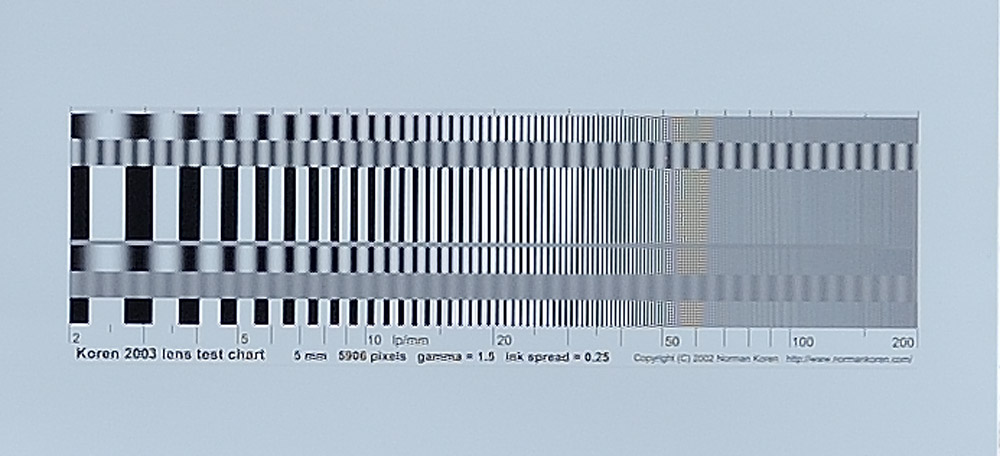

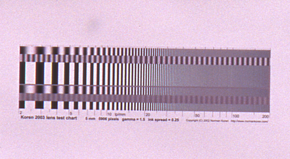

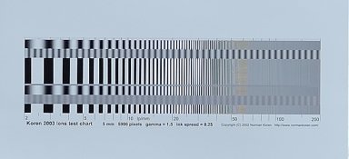

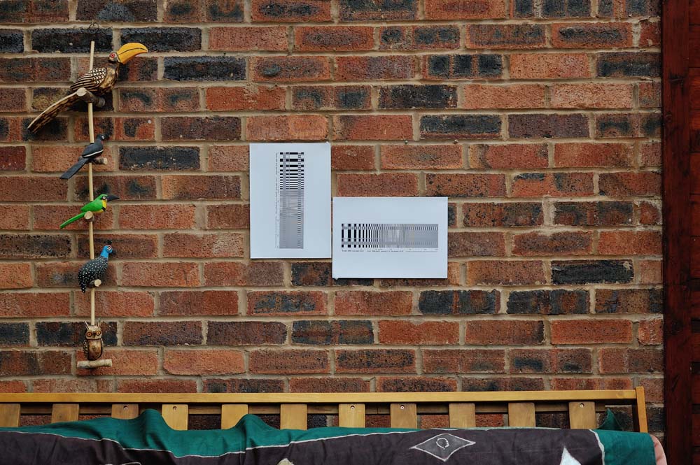

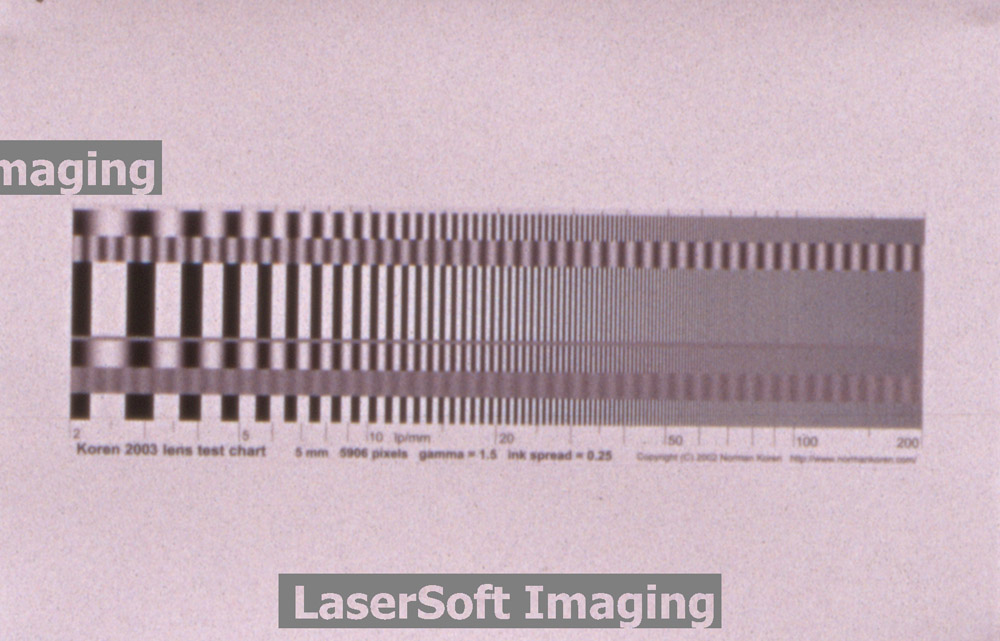

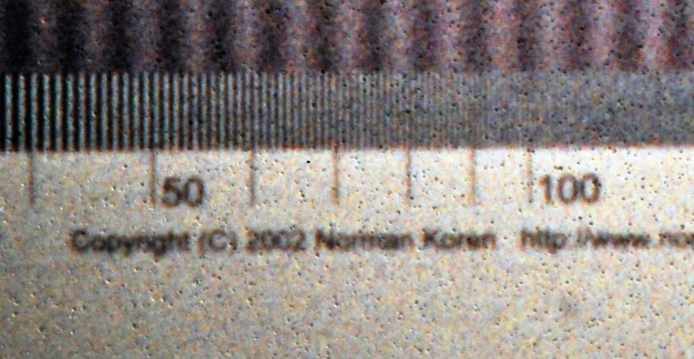

Right, the results are in (mostly). What I did was this: I took the Koren test charts at the appropriate distance (3.120m) from the film plane of cameras with a 60mm micro nikkor. I used a Nikon D700 set to ISO200 and RAW, a Nikon F4 loaded with Velvia and a Nikon F100 loaded with Portra 160. In all cases, cameras were mounted on a sturdy Gitzo tripod, and mirror lock-up (not F100) and used a cable release. All apertures were F8, and the shutter speed was varied to take into account the differences in film speed/sensitivity. The Portra results are not back from the lab yet, I'll do those later.
I had the Velvia processed and then scanned it at 7200 dpi (max optical resolution) on a Reflecta RPS and also at 6400 dpi on an Epson V700, both in Silverfast. There was a small amount of sharpening applied but this didn't affect the readings at all. I then look a close-up of the Velvia using the D700 on an Olympus bellows set with a Zuiko 20mm macro lens, giving about 12x magnification. The readings in line pairs per mm should be about right for this test chart and distance. Even if not, they allow comparison of like for like.
Here are the images. First, the test chart set-up in my conservatory. Then the D700, Then the close-up of the transparency at 12x, then the Epson V700 scan and finally the Reflecta RPS scan.

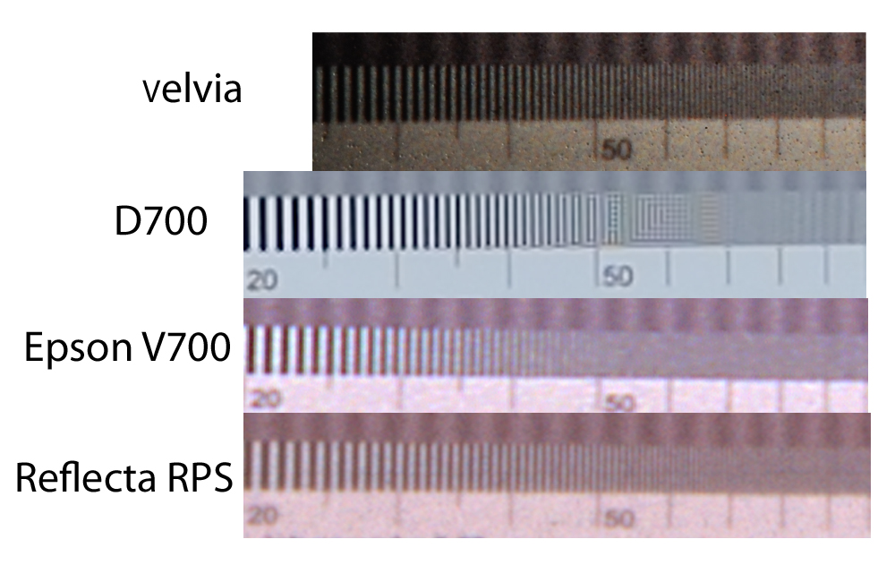

To be honest, it's not easy seeing the resolution limits from those jpg files, so here is what I see from the full files:
1. Velvia down a microscope (Olympus). I can see easily down to 90 lp/mm. You can just about see this on the full close-up taken down the bellows - don't worry about the spots here, it was on a piece of Perspex that had a funny texture. I think this is not too far from the theoretical resolution of Velvia. At a push I'd say you can see up to 95 lp/mm on the transparency.
2. Nikon D700. I can see to 60 lp/mm tops. Really, the theoretical limit out to be the horizontal number of pixels/2 for the 36mm length of the sensor, so (4,256/2)/36 = 59 lp/mm so pretty much on the money.
3. Epson V700 at 6400 dpi. I can get to 48 lp/mm before it turns to mush. This is for the Epson holders optimised for the right height. I know that scans I get can be variable, some good, then some not so good, probably due to the poor holders, so I had a number of goes and this is the best I could get.
4. Reflecta RPS at 7200 dpi. I can easily get to 65 lp/mm and at a push 70 lp/mm.
Conclusions? The Velvia on the Reflecta out-resolves my D700 (wow!) but the D700 files are certainly cleaner. The Reflecta still falls short of the resolution that can be seen on the film by some way. The Epson does a good job, and I'm sure I can do better with it with some adjustment, but the Reflecta does a pretty good job. Of course resolution isn't everything, and I shall explore further....

To make comparisons easier, here are each of the images stacked on top of one another. First the Velvia in close-up taken via a macro set-up, then the D700, then Epson V700 at 6400 dpi, then the Reflecta RPS ay 7200 dpi. I have also run some tests on the reflecta at different resolutions which shows that you're not really getting any more resolution out scanning at 7200 dpi vs 3600 dpi. I'll post those as well.

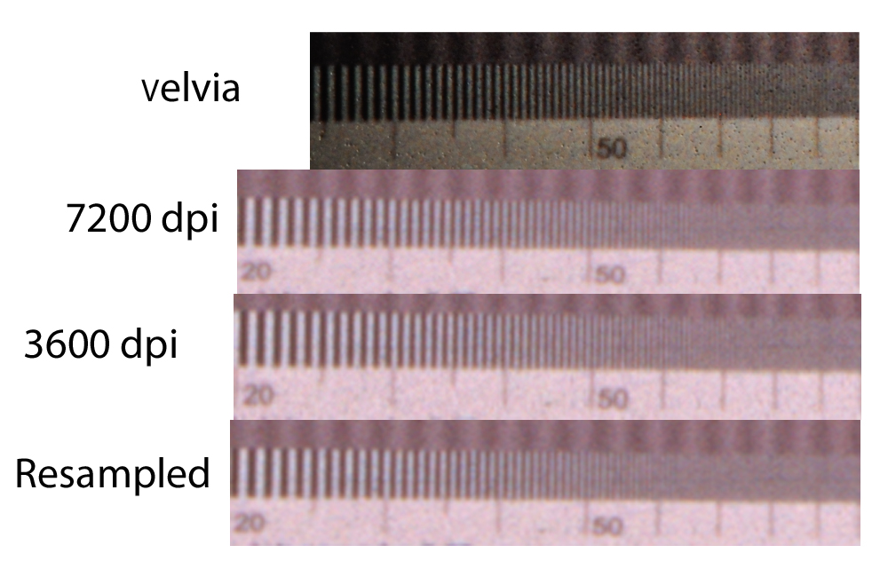

And here is the comparison between scanning resolutions on the RPS 7200. As you can see, there is no point scanning at 7200 dpi as the 3600 dpi scan captures all the detail there is to be had from the machine. Scanning at 7200 dpi and then resampling down to 3600 dpi (bicubic smoothing bottom trace) has no beneficial effect and actually loses a little resolution. Of course I haven't played with sharpening at all so far, perhaps when I get time...

I should point out that the distance on the film/sensor between the 20 and the 50 marks on the images above is around 1mm. So when you look at it like that, all digital images/scans are amazing, though not as amazing as the raw film itself which is quite stunning. On a 12"x16" print (which is about 12x magnification from 35mm) that one millimeter would be stretched out to 12mm. Ok, perhaps a little rough if you're going to press your nose against it, but from a normal viewing distance I should think it would be fine.

That is what I read elsewhere, that the maximum resolution claimed is interpolated (same for the competing Plustek model). Regardless, the Reflecta looks the best in the comparison. Can't wait to see to what degree this resolution chart superiority will manifest in real world images :smile:
I'm not sure that the maximum is interpolated, I just think it's not as good as claimed. I get the same thing from the V700, the 6400 dpi scans are pretty much the same as the 3200 dpi scans and the Epson V700 has an optical resolution of 6400 dpi. I actually doubt that in real world images there will be much of an observable difference between the V700 and the Reflecta RPS in terms of resolution, but i'll post them when the Porta comes back from the lab.
I'm not sure that the maximum is interpolated....
I can't see any other plausible explanation for the fact that you double resolution to the max, and end up with a scan that is not only not better, but slightly worse... Evidently the true optical, and the maximum resolution are not the same. Indeed, I am saying this as matter of fact (commented at length on Rangefinderforums) , and have no intention to antagonise Reflecta owners.

I think something odd must happen above 3600 dpi. If you use Vuescan, then any scan above 3600 comes out very light and unuseable. Ed Hamrick (of Vuescan fame) says that he has no idea why this happens. On the other hand, the scanner test at Film scanner Reflecta RPS 7200 Professional has it resolving at up to 4100 dpi in Silverfast, so it can't be just 3600 interpolated up to 7200 dpi. Who knows. Anyway, it's not unusual to have optical resolutions stated that are way above actual resolutions. I think the best reading I can get for the Reflecta is about 70 lp/mm which equates to about 3550 dpi while there is actually 90 lp/mm (about 4572 dpi) worth of information in the slide.
Frankly, I am extremely sceptical toward reviews by interested parties - either selling the reviewed product; or getting revenues from the manufacturer or a major retailer in the capacity of advertiser. It's the old corrupt practices of the printed press successfully transferred and updated for the virtual domain.
Regardless, Reflecta looks like the best scanner for 35mm still in production. The only thing that held me from getting one was the software: neither SF nor Vuescan worked on my system so I had to remove it from my purchase list.
If Vuescan supported this scanner under Linux I would have bought into that. Sadly it doesn't, but then neither does Silverfast. I have a dual-boot Windows 7/Ubuntu system and I only use Windows for hardware (like scanners and meteorological stations) that Linux doesn't support. At the moment I'm testing a system with Ubuntu 13.04 running Windows 7 as a guest under Virtualbox. I'm hoping to get the scanners running under Silverfast within that. As you can save the guest OS state in Virtualbox it only takes a few seconds to start up within Linux, so it'll be like running the scanners from within Linux itself. So far partial success only.
As for resolution, whatever the maximum, 3600 dpi is enough to print 12"x16" from 35mm (at 250 ppi on the printer), and that's got to be enough for most people.
