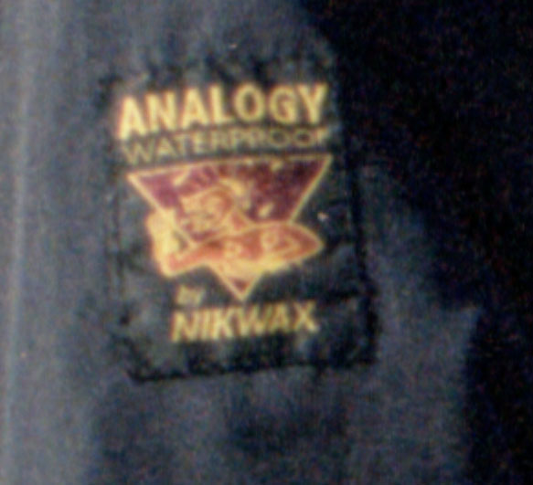

OK, lets see if this works. First the sample image (quick jpeg from an Epson V700). Scanned from Portra, image from a Nikon F100 with a 35mm F2 Nikkor if I remember rightly. Then detail from the sleeve of the logo at 100%, firstly from an Epson V700 at 3600 dpi, then from the Reflecta at 3600 dpi. The Epson was adjusted for the optimal negative height. There is no sharpening or anything else applied.
And this is the same logo taken from a 7200 dpi scan, firstly as it came out of the scanner, then with a bit of unsharp mask applied. If you look at the size of the original section that's been enlarged, I have to say that it is quite impressive! I've yet to run more tests, but my gut feeling is that the V700 does give a really really good scan, it looks sharper out of the scanner, but then it is more contrasty. The Reflecta looks softer, but you have a greater dynamic range to play with and can sharpen it up and play with it a bit more.
