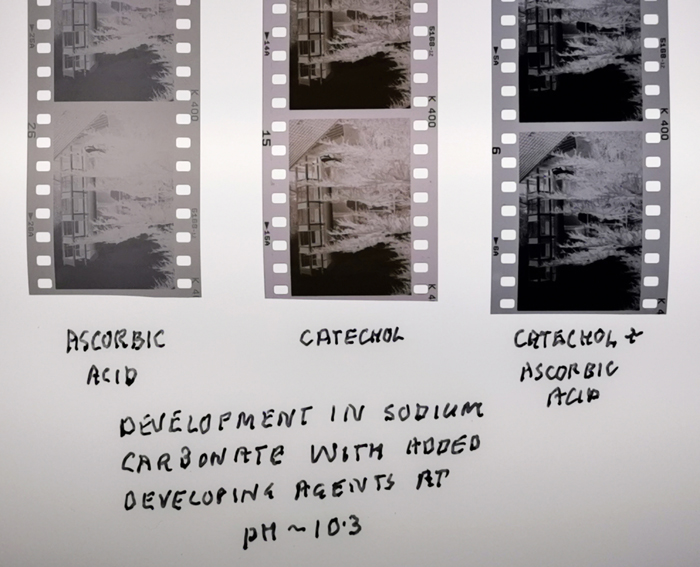

I developed Kentmere Pan 400 film 20min 20C in the Caffenol CM formula leaving out the coffee but with other additives.
The pH of Caffenol CM with coffee was measured as 9.8.
Additives and the resultant pH were Ascorbic acid 16g/L pH 10.3, Catechol 4g/L pH [adjusted with bicarbonate] 10.4, Catechol 4g/L + Ascorbic Acid 16 g/L pH 10.3
pH with additives was about 0.5 units higher than Caffenol CM as no attempt was made to adjust for the acidic missing coffee.
Results are shown in the attachment.
There is weak development and some fog with ascorbic acid additive alone at pH 10.3, somewhat more density with catechol alone [no fog] and a definite increase in density with catechol plus ascorbic acid together.
The results are consistent with catechol being regenerated by ascorbate [superadditivity]

I said results " are consistent with" regeneration of catechol by ascorbate.
To actually prove it would be a postgrad project in an Electrochemistry Lab IMO.

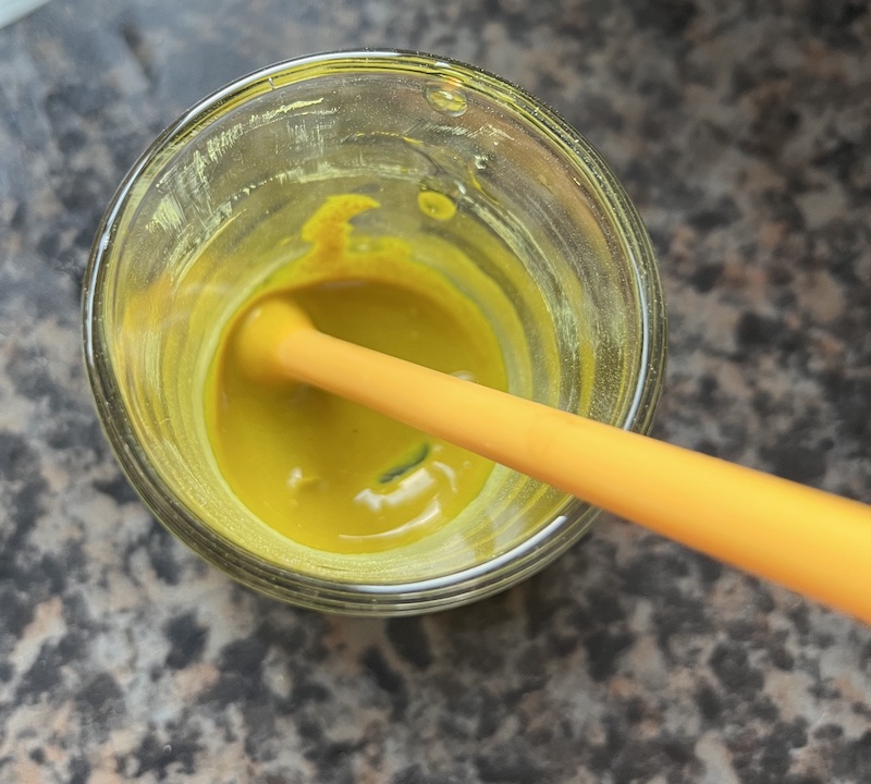

My quercetin tablets arrived today! It being Saturday, after I was done with the domestic agenda in the morning, I had time to try an experiment.
I had two things I wanted to test:
  1. On a hunch, I thought I'd like to see if triethanolamine would improve solubility of quercetin
  2. Can we show any superadditivity between ascorbic acid and quercetin itself?
This is the setup:

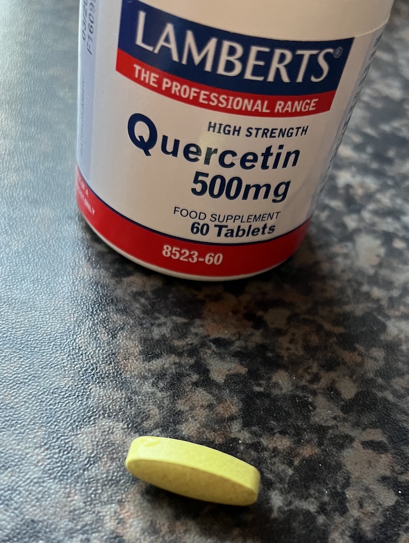

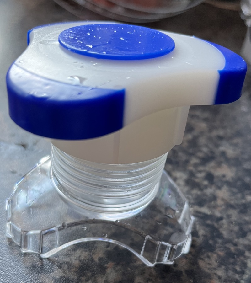

  1. Got 1 500mg quercetin tablet from the jar. This contains a few things that are not quercetin. I will post below.
  2. Crushed it as much as humanly possible with a dedicated pill crusher (these are cheap!)
  3. Mixed it with 2ml of triethanolamine into a British mustard-like consistency and color
  4. Added to 100ml of tap water
  5. Did not filter, just stirred once a minute to keep in suspension
Since I have gotten my new pH meter but not yet calibrated it, I tested pH with paper. Starting pH of the above was high 9s, ~9.7-9.8 guessing from previous experience.
I then ran a few tests for 10 minutes each, at 68F, using snippets of that old Fomapan 400, my perennial test dummy:
  • Quercetin alone
  • Quercetin with 1.6g of ascorbic acid, pH about 8.8
  • Quercetin with 1.6g ascorbic acid, pH matched back to the high 9s with paper (more info below)

That being said, the pill ingredients are:
  • Quercetin dihydrate
  • Calcium carbonate
  • Cellullose
  • Anti-caking agents:
    • Stearic acid
    • Silicon dioxide
    • Magnesium stearate
  • Pill coating:
    • Hydroxypropyl methylcellulose
    • Glycerin

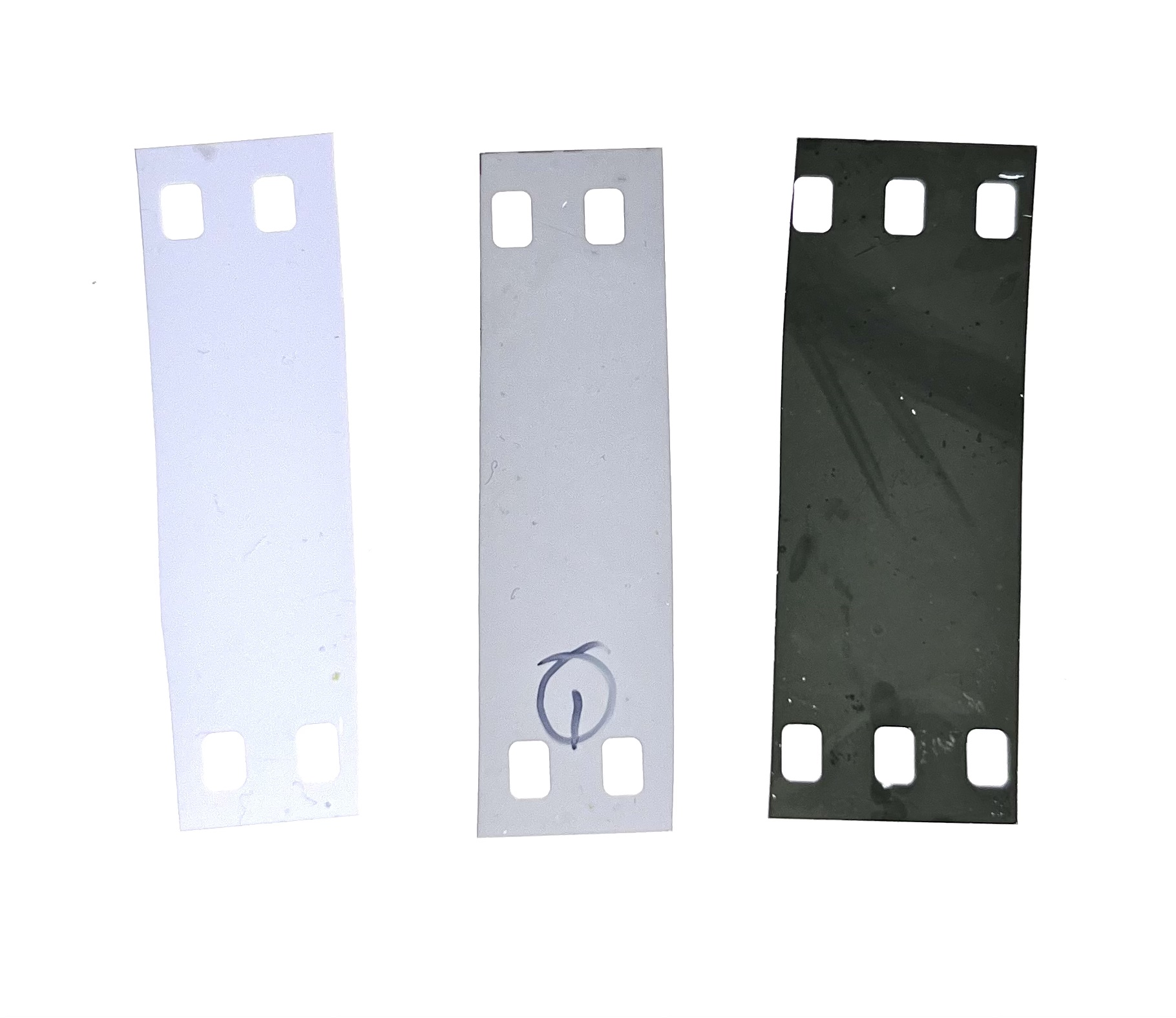

The results:
The quercetin alone does develop film, but not very well. Quercetin and ascorbic acid together appear to be a strong developer. Since I think the only main difference from @Alan Johnson 's earlier testing is that there is more ascorbic acid, I can only presume this is why it works faster. I am not certain if the streaking on the darkest test strip is from sediment settling on it and increasing the concentration, or something that may have happened to this clip of film sitting in my box.
All tests are fixed with Ilford Rapid Fixer, which is acidic and may eliminate stain.
Densities:
  • Fixed Fomapan 400, no development: 0.34
  • Quercetin alone: 0.61
  • Quercetin with 1.6g of ascorbic acid, pH about 8.8: 0.65
  • Quercetin with 1.6g ascorbic acid, pH matched back to the high 9s: 1.25 (!)
I'm attaching some photos of the setup and the results on the light table. Since these are not real photos, it's hard to say anything about fog conditions.
Last photo is Fomapan fixed without any dev, quercetin alone, querceting with 1.6g ascorbic acid and pH matched

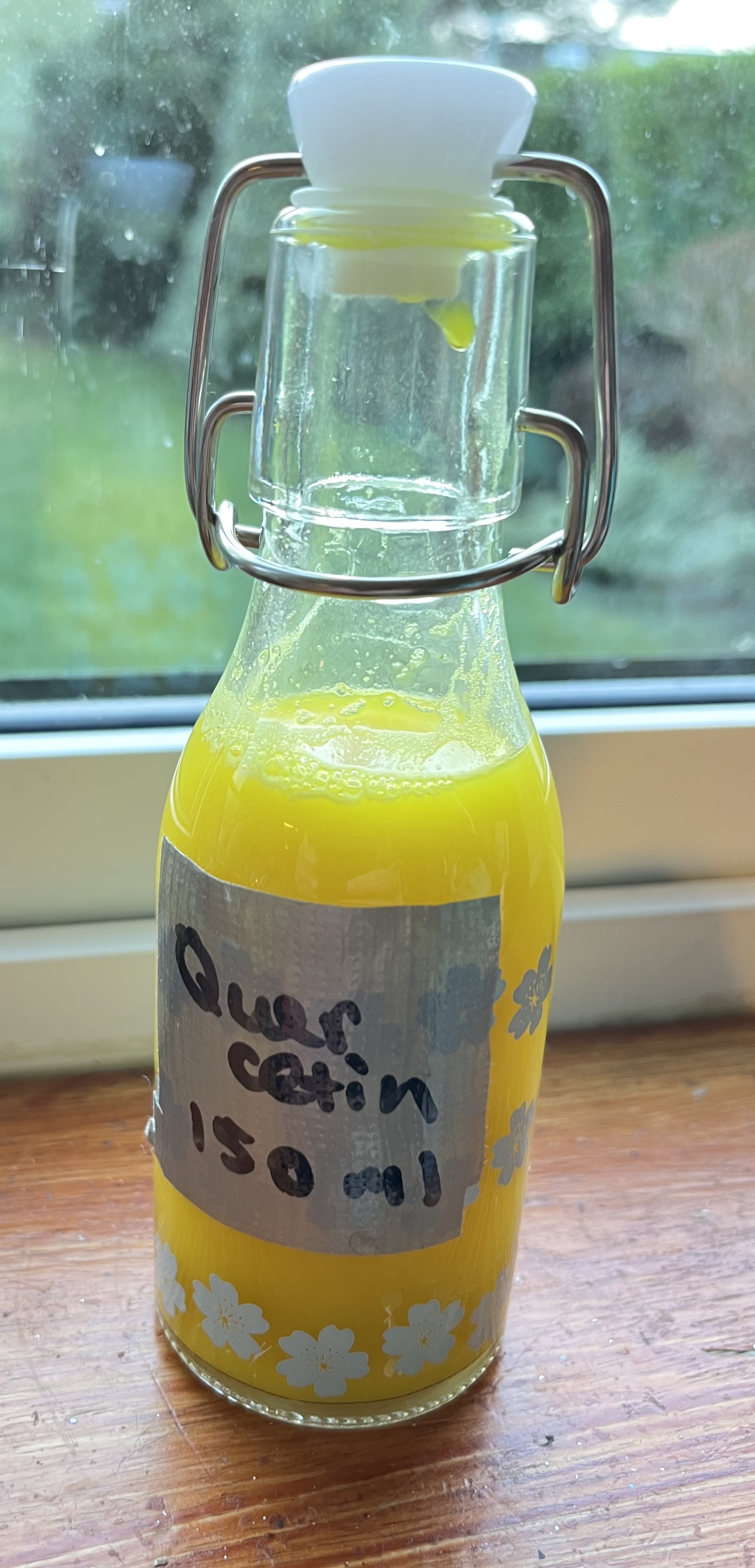

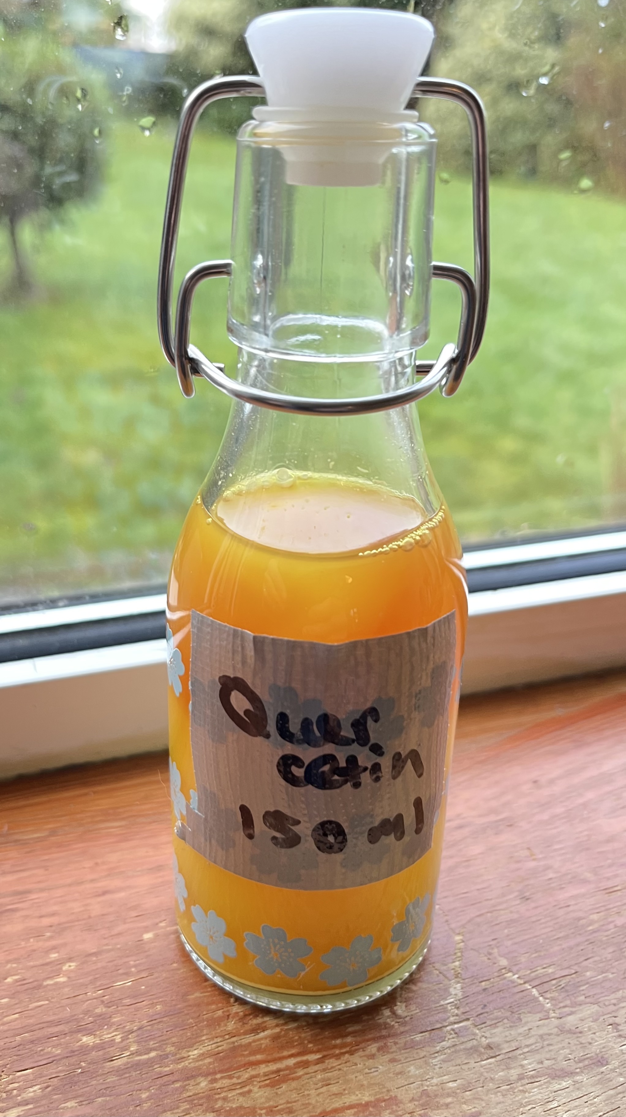

I’ve made up the following solution and will let it sit for a day to see what settles out.
  • 150ml water at 40C
  • 2ml triethanolamine
  • 500mg tablet of quercetin crushed to a very fine powder
I mixed as before, quercetin in 2ml TEA as mustard consistency. Then added to the water. It’s in a little IKEA bottle.
19 hours later it is clearly oxidizing, despite the top of the bottle being filled with canned air.
I found a paper that appears to document the likely oxidation products at this pH at ambient temperatures in aqueous solution. The ultimate product appears to be protocatechuic acid, which retains the catechol moiety. However, the NIST paper on reduction potentials indicates that it is a much worse reducing agent than quercetin.
I will do a test later today and compare to my previous results.

Today I did the following experiment for (A) Quercetin by itself, (B) Quercetin with ascorbic acid, matching process from previous run:
  1. Started 24 hours after I bottled yesterday
  2. Carefully decanted 20ml of the brown liquid from the top of bottle into a shot glass that I use for testing
  3. Developed for 10 mins @20C
In the second round I added slightly over 0.3g of ascorbic acid, targeting the equivalent of 16g/L.
Results
  1. Surprisingly, I did not observe a change in activity. This may be because quercetin is so insoluble that when it converts to protocatechuic acid or one of the other oxidation products, that this allows some of the reservoir on the bottom of the bottle to dissolve along with it.
  2. Densities were as follows on Fomapan 400:
    1. Browned quercetin by itself: 0.53
    2. Browned quercetin + ascorbic acid: 1.28
    3. I did not re-test ascorbic acid alone since we already have values for this
These are darn close to the same values I got from the previous testing with all the sediment in the solution and the solution being completely yellow. The differences I think are probably down to process control (temp especially) being hard on such small samples and without having calibrated and set up my pH meter.

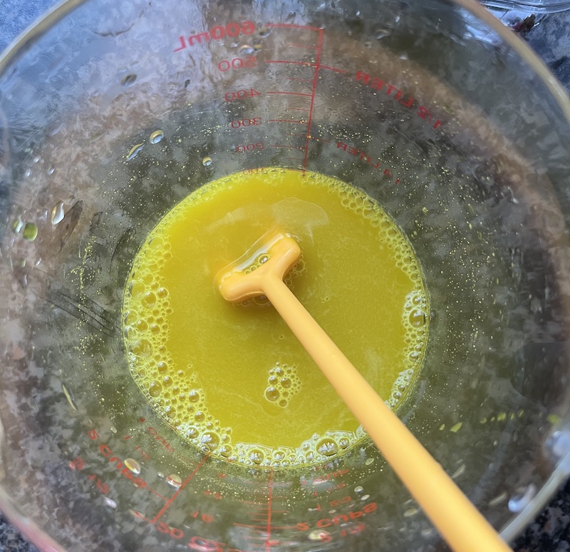

I tested some shots out in a basic quercetin developer to see how it might look. Due to a series of errors, the results are not scientifically useful. But I thought I'd post an image from the test because I think it indicates that it's worth continuing to try to make something useful here (as @Alan Johnson also showed earlier in this thread).
I have no idea why this is so scratched to heck. I think there was something wrong with the film canister or from bulk loading a long time ago, this is not a result of development. The rest of the roll was not like this but this is the best frame for exposure.
Ignore the scratching, it's the grain and gradation that look interesting to me. This is Fomapan 400 in my Yashica Electro 35 GSN. Finer grain that I normally expect from Fomapan 400. It is thin, and that will make grain look better. But I have other negatives from other tests that are this thin and it looks a little better than those.
This was the formula I tested here:
  • 100ml solution from the IKEA bottle
  • 200ml warm water
  • 5.3g ascorbic acid
  • 7g sodium sulfite
  • 6ml TEA
  • Sodium hydroxide to pH 9
  • Temp back to 20C for development
This was dumb, because it ended up with not enough quercetin in solution. You really need to have a saturated solution. The pH is also too low. It should be 9.7-9.8 for best results I think. I also then developed it for too short a time as a result. 16 mins @ 20C. Not even close to long enough for a non-saturated solution. I think it is long enough for a correct concentration and pH, based on earlier testing of strips of film. There is no fog. No fog at all. Base density measures more or less the same as undeveloped/fixed film.
