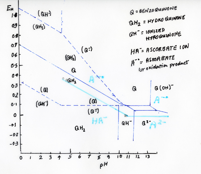

Thanks Rudi, that will be very interesting! Fingers crossed you get time on Wednesday. I suggest that you use 16g/L of ascorbic acid because only the stand development version of caffenol uses less. If that abstract I linked to is applicable, 1.5% or more solutions change the nature of the relationship between catechol-related compounds and ascorbic acid.

The reason I wanted to go easy on the ascorbate/Catechol was pH: with 30 g/l Potassium Carbonate, 5 g/l of whatever won't change pH all that much, but 16 g/l certainly will. What I will probably do is adjust the amount of Ascorbic Acid to match the molar amount of the Catechol version. With some luck I'll haul my pH meter along and do a proper job.
Interesting how much lower the potential is all the way up the pH scale. That makes it clear why it doesn’t work by itself well.
That makes sense.
You may be misreading the chart: lower value means stronger reducing agent. See, how the value drops as pH goes up. In theory Ascorbic Acid should be a powerful developer on the edge to becoming a fogging agent. In practice it is a very weak developer unless you unleash it through some primary development agent. As I said before: there are more aspects to silver halide development than pure reducing power.

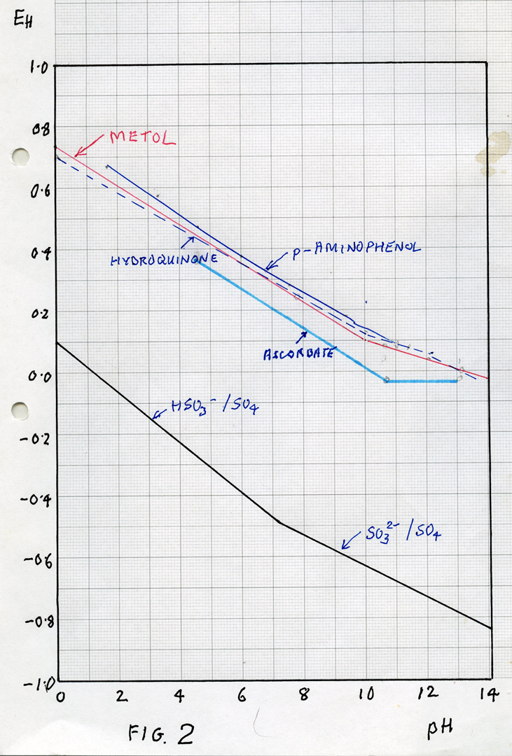

I made a better sketch for potential-pH with hydroquinone [ from Electrochemistry of Quinones , James Chambers 1988] and added ascorbate as before.
At the pH of interest, something over 10, the line for the first oxidation product of ascorbate A-' is lower than those for HQ and all its ions showing that A-' is the most powerful reducer.
Since most of these food extracts seem to get a boost from ascorbate, some at least may contain quinones which are reduced by A-'
Ah OK, thanks for the chart. Now that I better understand how to read these I see what you mean.
Please correct me if I'm wrong, but to summarize what I think you said: I think you are confirming that it appears possible that at this pH level (sodium carbonate solution, so greater than 10), we may see what I quoted from that article happening, to quinones of the right potential, if they are present. We think that some of them are present—maybe quercetin is one, maybe it's not—because we can observe the boost in activity from ascorbate for all of these food-based developers (potatoes, coffee, tea, beer, etc) and this mechanism appears to be a possible route for that to work.
