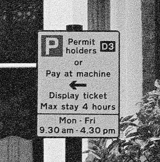

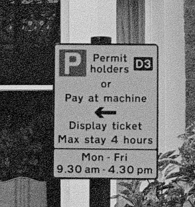

Patented in 1999, Quercetin Chalcone (QuCh) is sold in health supplement capsules.Capsules of Quercetone contain 250mg QuCh and capsules of Quercenase (which I ordered by mistake) contain 250mg QuCh and 100 mg Bromelain.I doubt the Bromelain in the capsules I used had any effect but cannot be sure,Quercetone would have been better.
1st QuCh Staining Developer:
Metol.......................0.2g
Sodium Metaborate.....5g
QuCh.......................2.5g (contents of 10 capsules)
Water to...................1L
The quercenase was hard to dissolve, I dissolved it with stirring in the Metol +Metaborate dissolved in water at 100C.(Care, unknown hazard).
HP5 exposed at EI 200 was developed 30min 20C, agitate 10s/min in 1st QuCh.
A dark brown-yellow stain was produced and there was a relief image in the emulsion.
Attachments show scans of 0.2 in square sections of HP5 developed in 1st QuCh and in Pyrocat HD, equally sharpened.
QuCh costs ~$30 for 15g, Pyrogallol costs ~$20 for 100g.

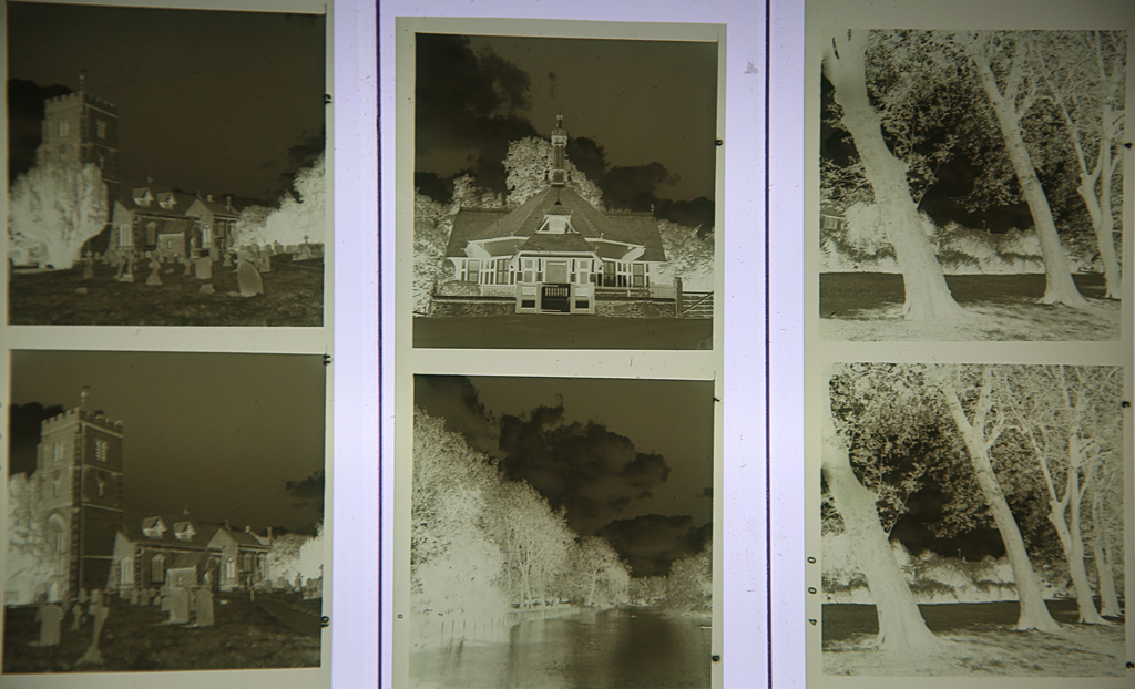

Developer from Quercetin Capsules
I now tried to make a staining developer starting with Quercetin capsules ,not the more soluble Quercetin Chalcone capsules mentioned above.
2.5 g Quercetin poured from capsules was added to 4 g Sodium Hydroxide (Lye) in 100 ml water. This did not all dissolve immediately and was left for 7 days in a 100ml sealed glass bottle with occasional shaking.The level of suspended material in the solution gradually fell but it was not all dissolved after 7 days when the clear orange solution was filtered off through cotton wool.It was made up to 1liter and 0.2g Metol and 15 g sodium bicarbonate (Arm & Hammer baking soda) were added.The pH was 9.8 +/- 0.1.
Pics of Fomapan 400 negatives developed 30min 20C and a positive are attached.
The working solution was:
Metol.........................0.2g
Quercetin ..................2.5g
Sodium Hydroxide.......4.0g
Sodium Bicarbonate...15.0g
Water to.....................1L
Conclusion:
It is possible to make a staining developer from Quercetin capsules but at present:
(1) It is not clear if the development is due to dissolved Quercetin or Quercetin Hydrate formed by reaction with the Lye.
(2) If there is an easier way of making it up, preferably avoiding hazardous sodium hydroxide (see previous posts).
