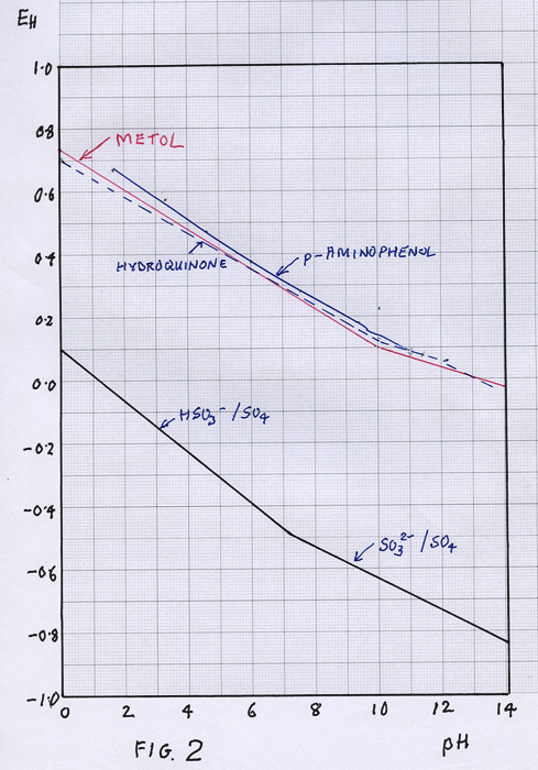

The oxidation/reduction potentials of ascorbate are well below those of HQ on the diagram post 40 [I can add them later].
If the various food derivatives are similar in oxidation/reduction potential to HQ, as was suggested for quercetin above, then in theory they could be regenerated by ascorbate.
Its not clear, IMO, if what is to be regenerated is the free unstable first oxidation product of the food derivative [this is called a semiquinone] or an oxidation product of the food derivative adsorbed on the surface of the grains, or a mixture of the two.
Anyhow it looks like its usually the ascorbate that does the regenerating.
