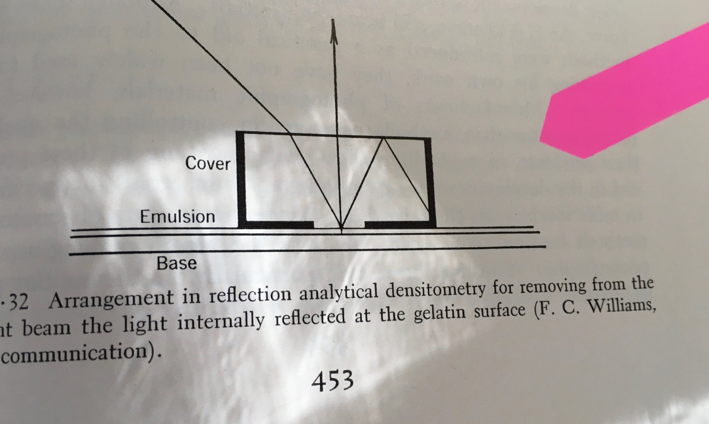

a fast thread scroll says you've probably covered this about reflection densitometers:
from Evans &
Now that you're done with the densitometer, it's time to work on the Printalyzer. The densitometer was your warm-up. 🙂

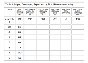

I hope you don't mind me interjecting here. I'm a recent proud owner, from across the pond, of the printalyser densitometer. I currently have an enlarger with a LED bulb and I'm currently using the densitometer to perform a calibration of my RH Designs Zonemaster light meter connected to my RH Designs stop clock pro. I'm really interested in the development of the Dektronics enlarging timer and exposure meter and noticed previous reference in this thread to the hard baked 'spooky numbers' used by RH designs. I recently managed to find a calibration procedure on the RH Designs website that seems to reveal these 'spooky numbers' referred to as 'Meter software constants'
The link to the full calibration procedure document is here: https://rhdesigns.co.uk/wp-content/uploads/2020/03/pluscal.pdf (also attached)
I've just finished my calibration using the densitometer procedure given in the latter half of the calibration document using the meter software constants and calculation table. Not yet tested in the darkroom with real prints, but results look in the right ball park compared to previous calibrations.
Apologies if forum members are already aware of this document, it is undated but still available on RH Designs website. Hopefully it will be of interest.
  • pluscal.pdf
@garyj12 welcome to Photrio and many thanks for this useful addition! I'm sure that even if it's been posted before, it's still good to have it on hand in a place where it certainly is relevant.
