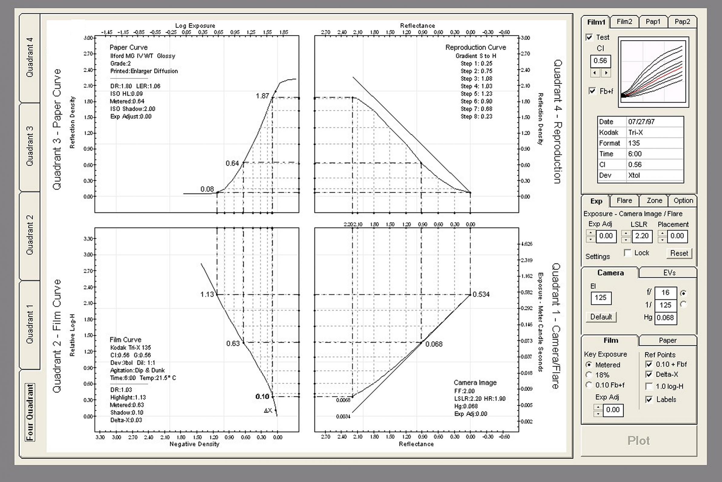

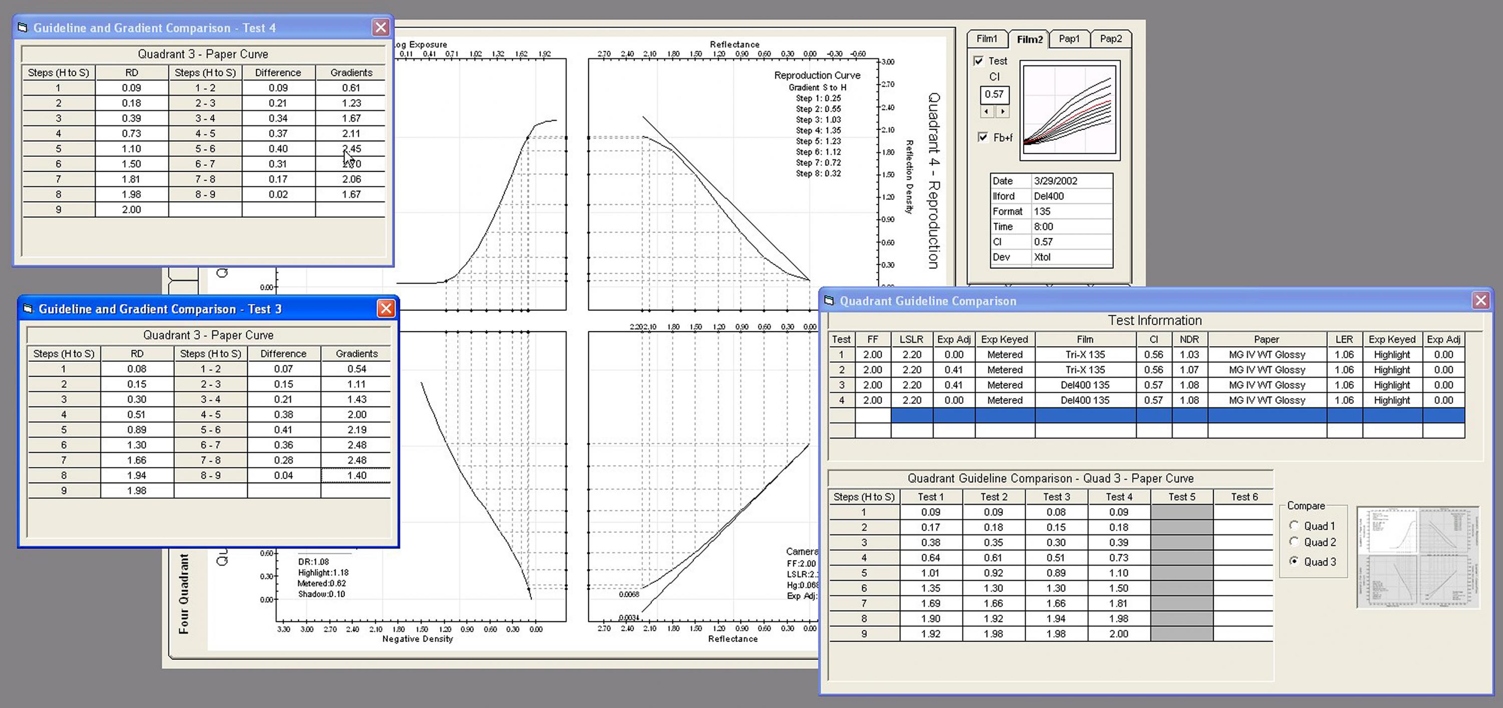

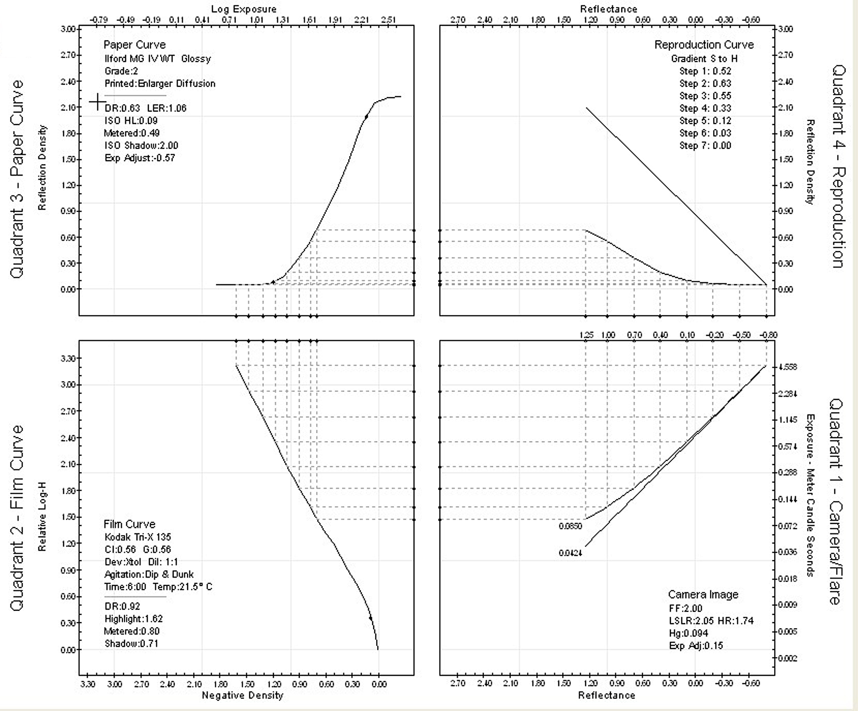

Whenever you have referred to your program I always pictured a series of spreadsheets, not an actual program. Impressive. This could be a powerful teaching tool (if more people were interested in learning about these things).
Visual Basic. Not that impressive.
Here's a screenshot of the main part. Tone Reproduction Screen shot.jpg.

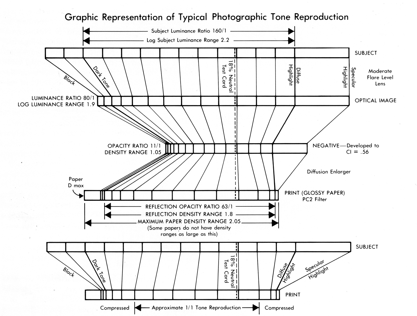

Just found something interesting. In Kodak's publication G-1, Quality Enlarging with Kodak B/W Papers, they have a Dorst type reproduction diagram, but with a few changes from the one found in Kodak Professional Black-and-White Films. This one isn't fudged. It uses the statistically average luminance range. A luminance range of 2.20, not 2.10. Flare is 1 stop and is listed as "Moderate Flare Level Lens." The camera image has a illuminance range of 1.90. In Professional Films, the illuminance range is 1.85 and the flare was a little over 2/3 stop. They needed to do this to have the 2.10 subject luminance range calculate down to the CI 0.56, which both examples use.

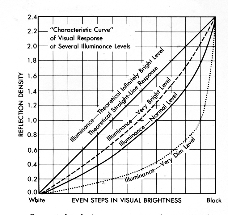

I know this doesn't exactly belong here, but also found this in Quality Enlarging. It appears that I'm not the only one who thinks the visual response to luminance levels is important.

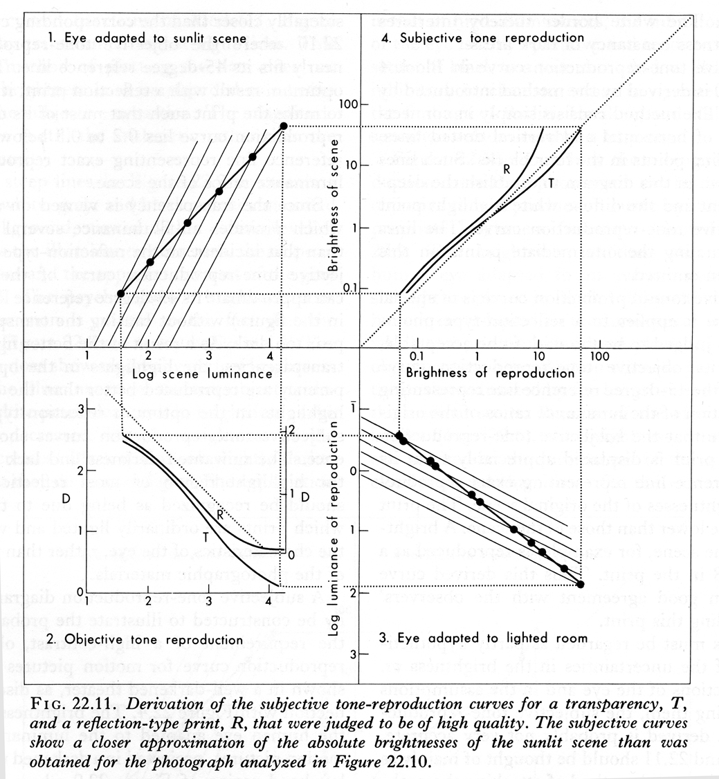

And to finish it off a Subjective Tone Reproduction diagram.

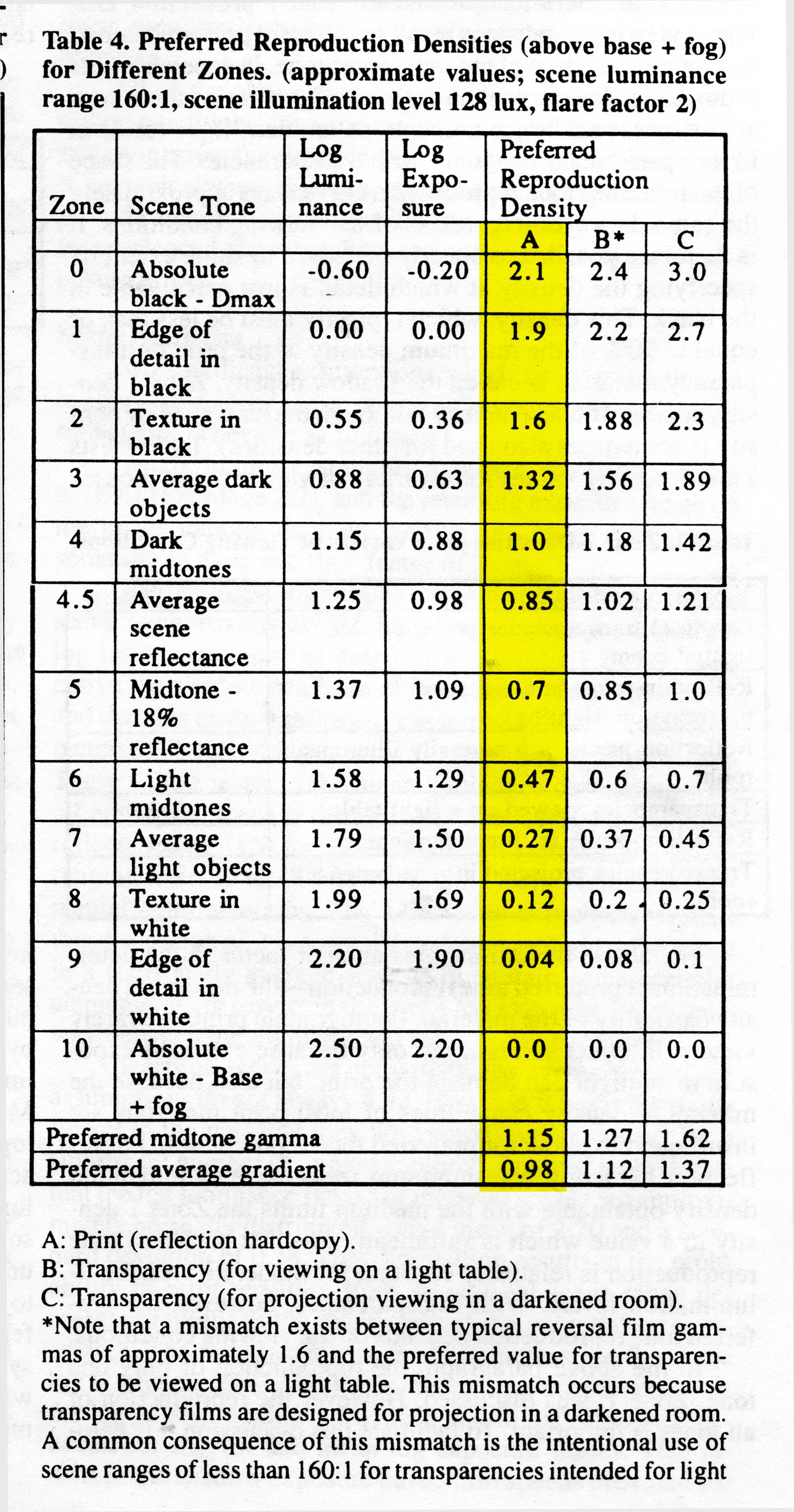

Exactly, Zones are non specific. They are referrences which makes their use in quantifiable testing questionable. There's this line from Doctor Who where he's attempting to describe time travel, "People assume that time is a strict progression of cause to effect, but *actually* from a non-linear, non-subjective viewpoint - it's more like a big ball of wibbly wobbly... timey wimey... stuff." How does one plot an "ish" with any precision?
Seriously, I've always thought the using Munsell values to define the print Zones would be a good idea. Jack Holm has linked zones to he defines as
Preferred Reproduction Density" for a print (reflection hardcopy).
Notice Holm has two different columns for preferred reproduction densities for transparencies. That's because densities are perceived differently under different viewing conditions. The same as with prints. There's that subjective reproduction again.

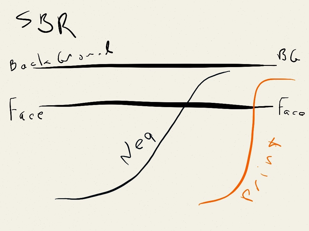

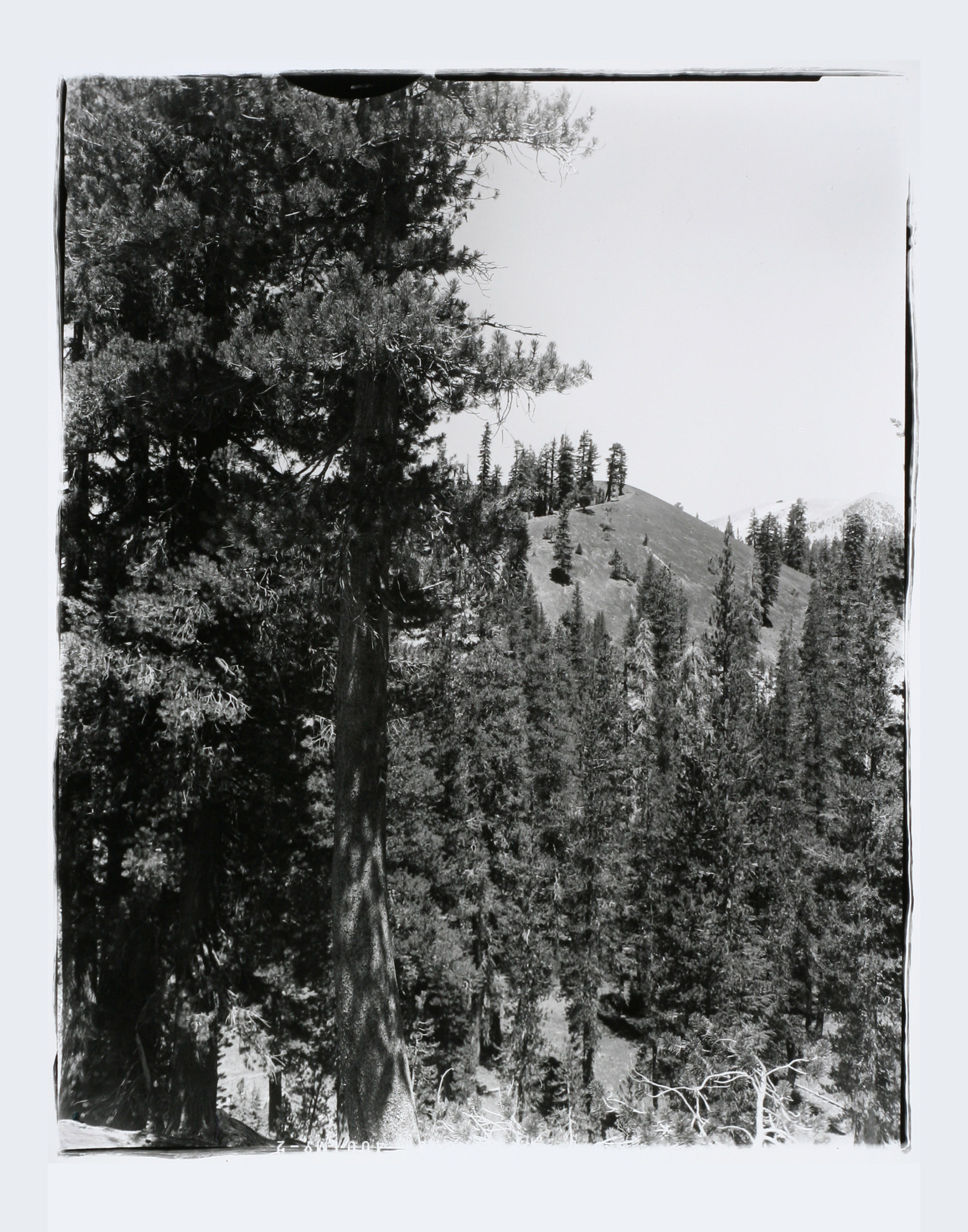

The drawing I started this thread with was meant to illustrate a simple concept & show a conceptual truth not necessarily a mathematically perfect model.
It is an expression of Adams ZS, visualization of print idea, with alternative film exposure options, it is a way for me to visualize how I might or can make a negative to get me from a to b.
Adams basic visualization concept is really strong in an artistic sense and easy for most to grasp, the details and measurements drag it around and beat it up because the more rigidly a system or idea gets defined, the more it becomes a one trick pony. Even Adams falls prey to this because of the subject matter he chose. If Karsh had written those books instead the world's perceptions of ZS principles might be very different.
I try to remember that personally I'm not a machine taking pictures of documents or laboratory cultures, I'm a human taking pictures of humans and of emotions and of ideas

I rated TMY-2 at EI 64 for this exposure, which places the negative well into the "Over" category. Because TMY-2 has a very long straight-line, I am still at least three stops camera exposure below the shoulder on the negative.
By my definition, you are only in the "extra" category; you haven't lost any detail. "Over", IMO, comes only when some of the subject matter/detail you actually visualized to print is truly off the scale and unrecoverable. Your negative though still has 3 stops of latitude you can play with.
Another way to think of this is that "box" might be considered somewhere close to where the first high quality print can be made and the limit of the "extra" category would be where the last high quality print can be made.
There are real reasons to consider these alternate placements.
Exposing for the last HQ print point might eliminate the need for carrying an ND filter.
Exposing extra somewhere between the limits could also give you consistently longer print times, making complicated burn and dodge work more manageable.
An example of the use of truly over is a high-key technique I used in studio, the subject is lit to provide proper placement for easy printing at the desired level. The background is then lit to truly overexpose well beyond where detail could be recovered. Creates a stunning white that leaves the subject beautifully isolated.

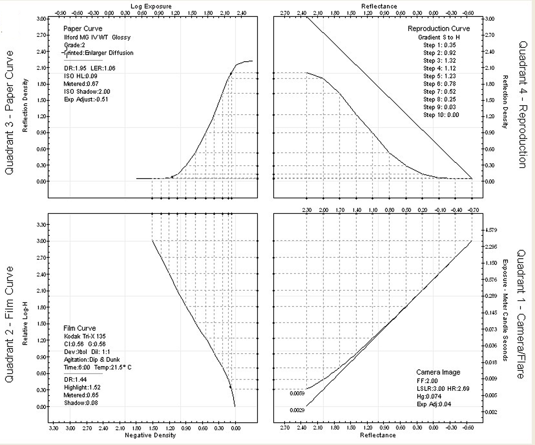

The example below would be how it would look using a single set of curves. This is the maximum Luminance range my program can do and I think pushing everything into the toe of the paper curve has freaked out the tone reproduction reference line.

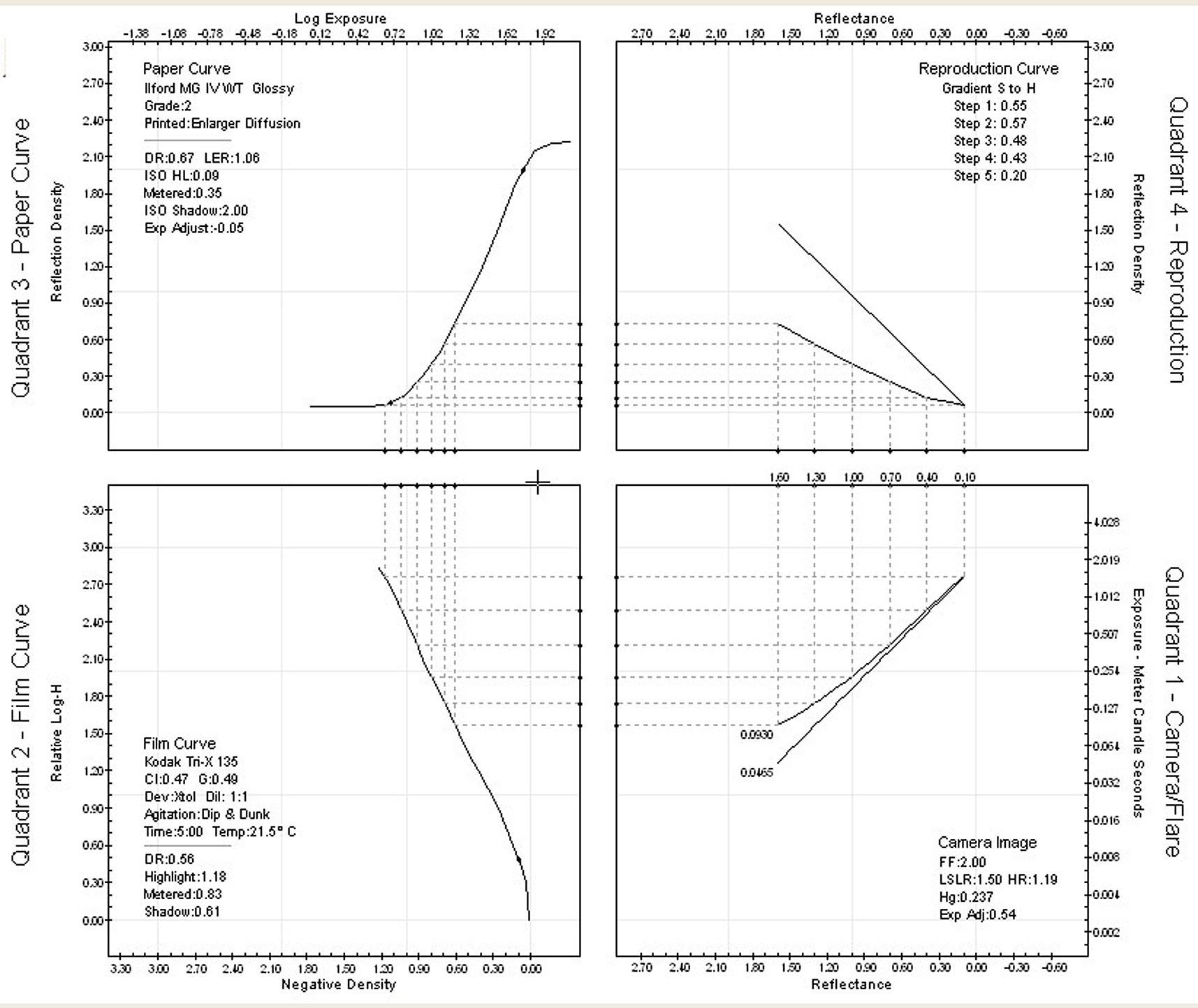

But what you have is one scene with a normal luminance range normally exposed and printed and another scene overexposed and printed for high key like in the next example.
As compared to a typical high key approach. The scene has a slightly shorter than normal luminance range. The main difference here is that it falls under 100% reflectance (the subject is shifted to the left in Quad 1). The exposure is placed higher on the curve. Development is reduced some, and the subject is printed in in the toe of the paper curve.
