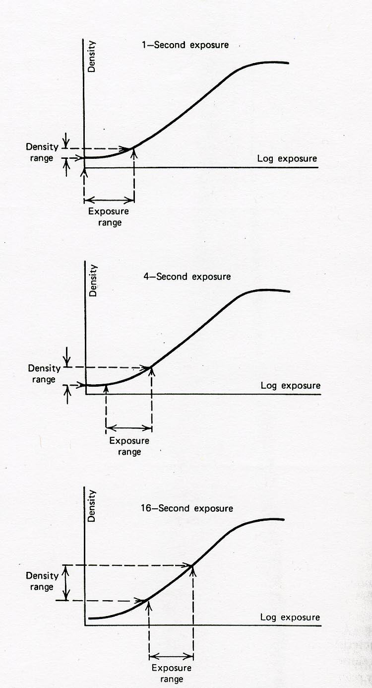

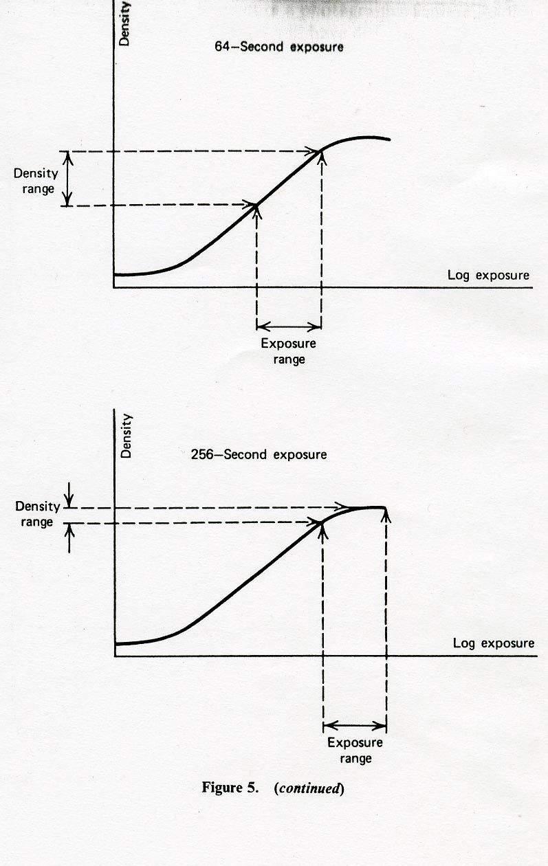

Graphs from Haist
The verbal discussion of this covers several pages in Haist and in Mees as well. I am going to post 2 examples showing latitude of a print vs the position of the exposure on the negative. The Density Range is what will be captured on the print shown in my earlier post.
PE
Thanks PE.

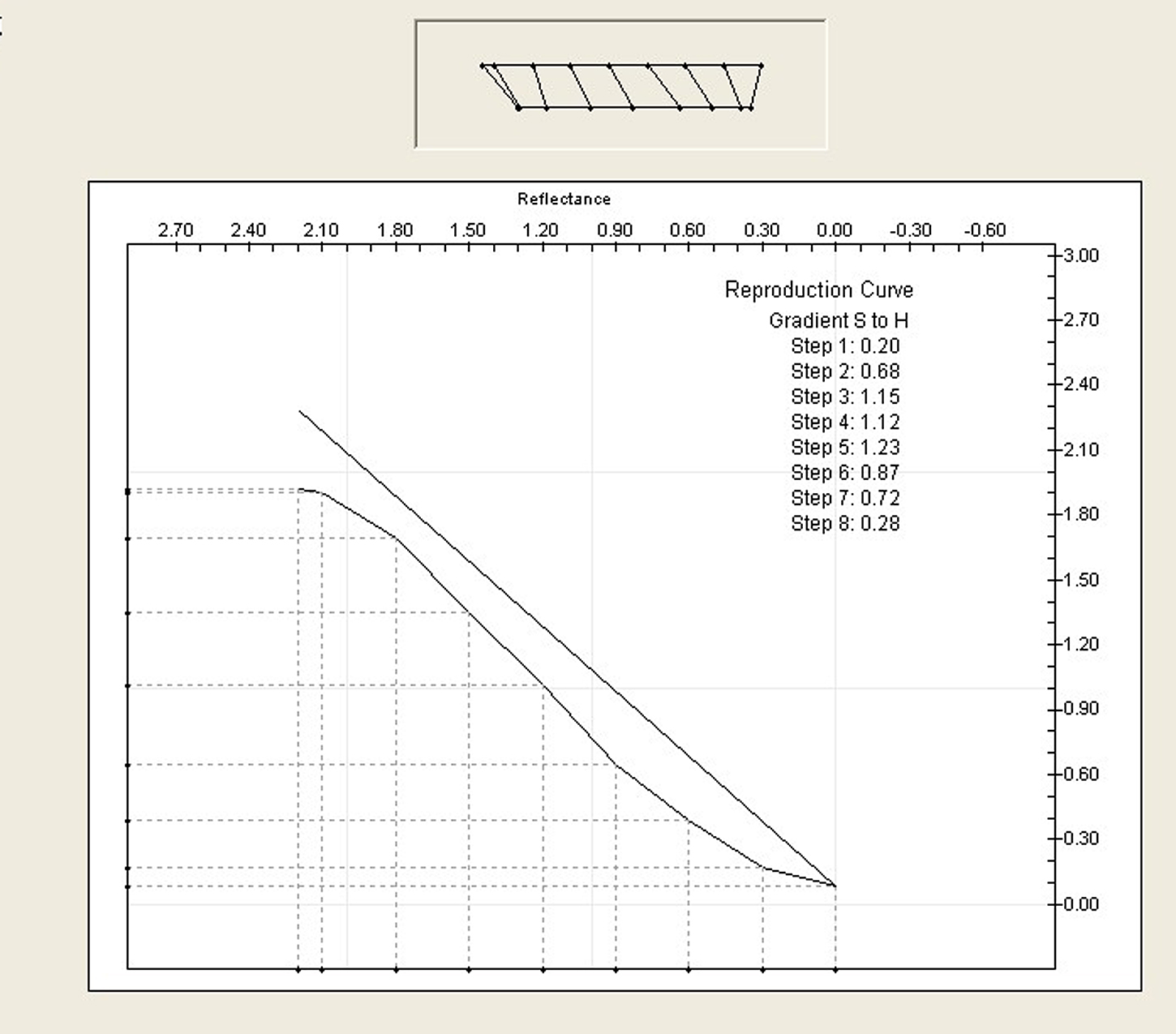

Mark, I'm going to have to wait for more of your idea to come together. Something to keep in mind. Is the perspective derived from any graph worth the effort to graph it? Is it offering a unique insight not obtained by other, easier methods?
On a completely different topic, I started working on having the Kodak tone reproduction scale as part of my program, but when I decided that a tone reproduction program didn't have an audience, I gave up on it. I think it visually conveys tone reproduction effectively, however, it isn't as effective in conveying specific information. I also have something like the Dorst diagram between the quadrants in the Zone System mode that's not quite finished. The example shows the original subject luminance (top) and the print reflection densities (bottom).
