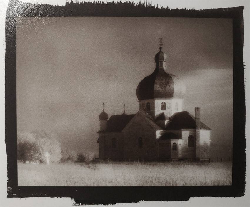

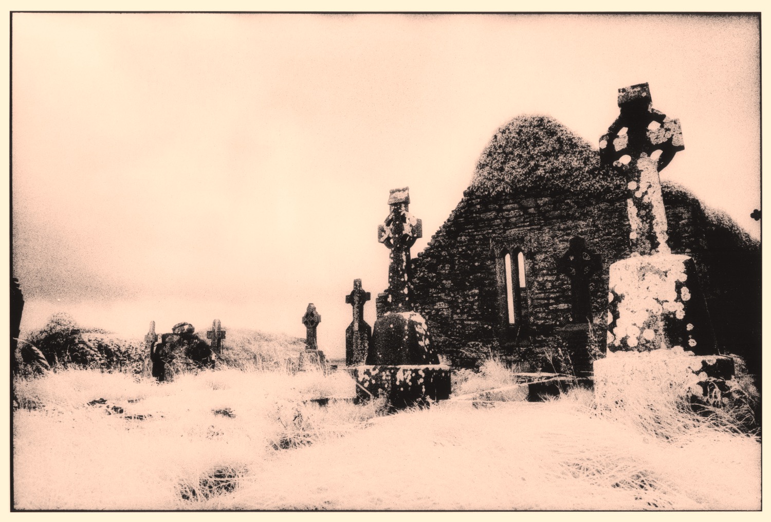

8x10 Efke IR. Wratten 87C.

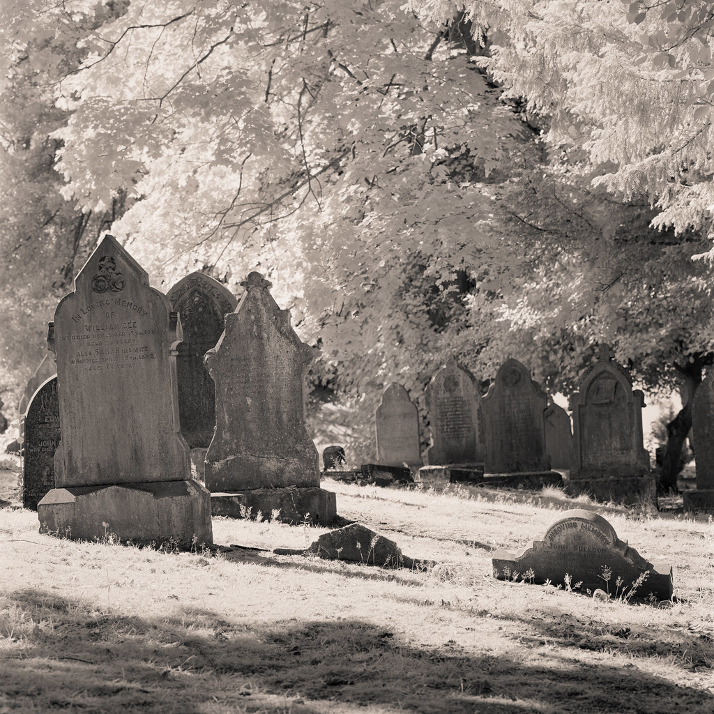

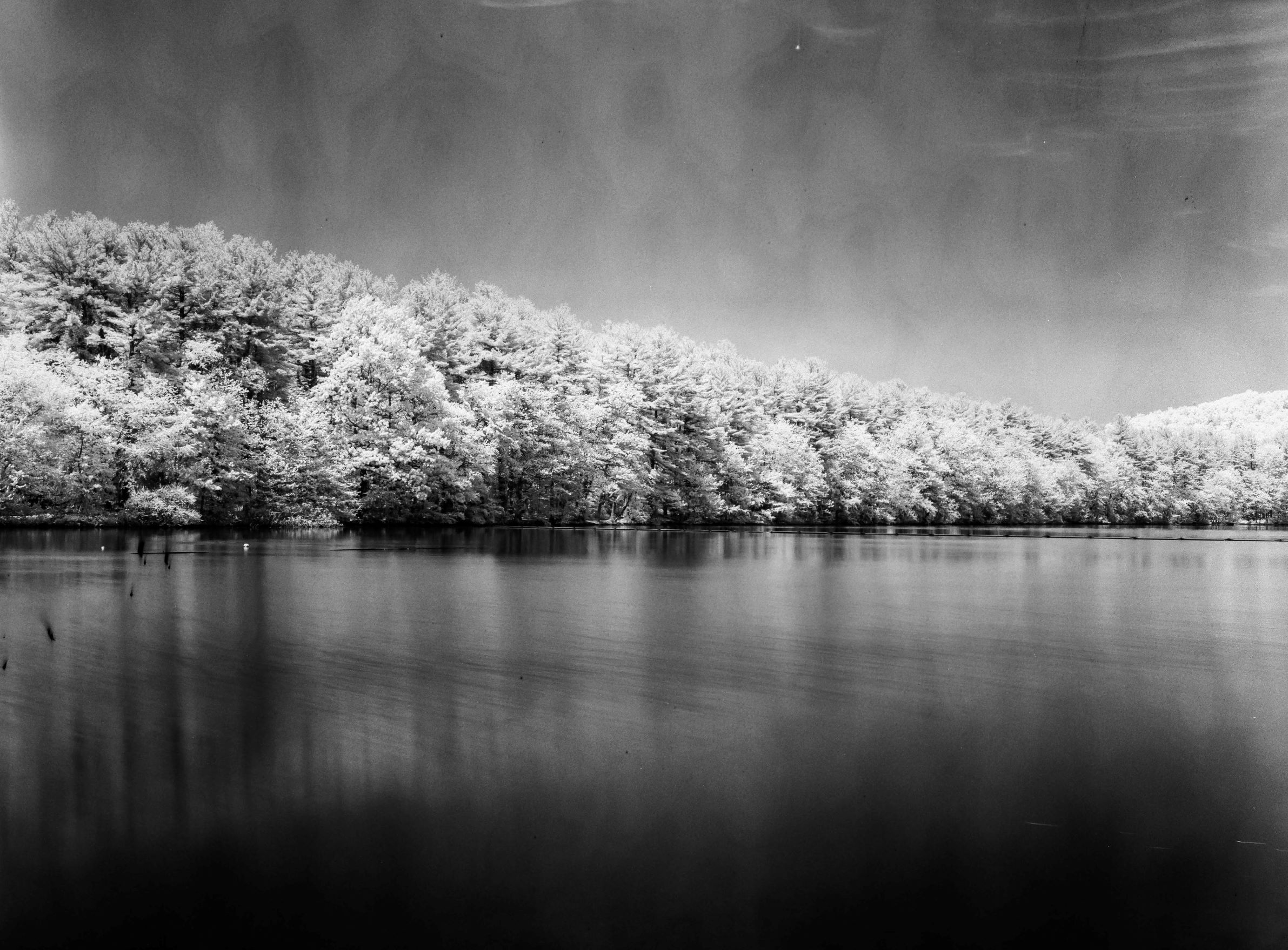

An image from my second time shooting IR. Bronica RF645, 65mm @ f22 on Rollei Infrared 400.
Indeed, but what is going on to the sky?
Some what darkened by the filter, but there is a lot of moisture closer to the surface and that is what causes the lighter tones near the trees.
Uncertain, I think my film lab may have done something wrong in the development process. Other shots had random black spots scattered about.
I agree. The moisture of the scene cannot be the reason in my opinion. Have you asked the lab already?
Unfortunately, I didn't. I do know that they do not handle much IR film. I tend not to ask the owner questions. Next time I have some Rollei 400, I'll bring it to a more experienced shop.

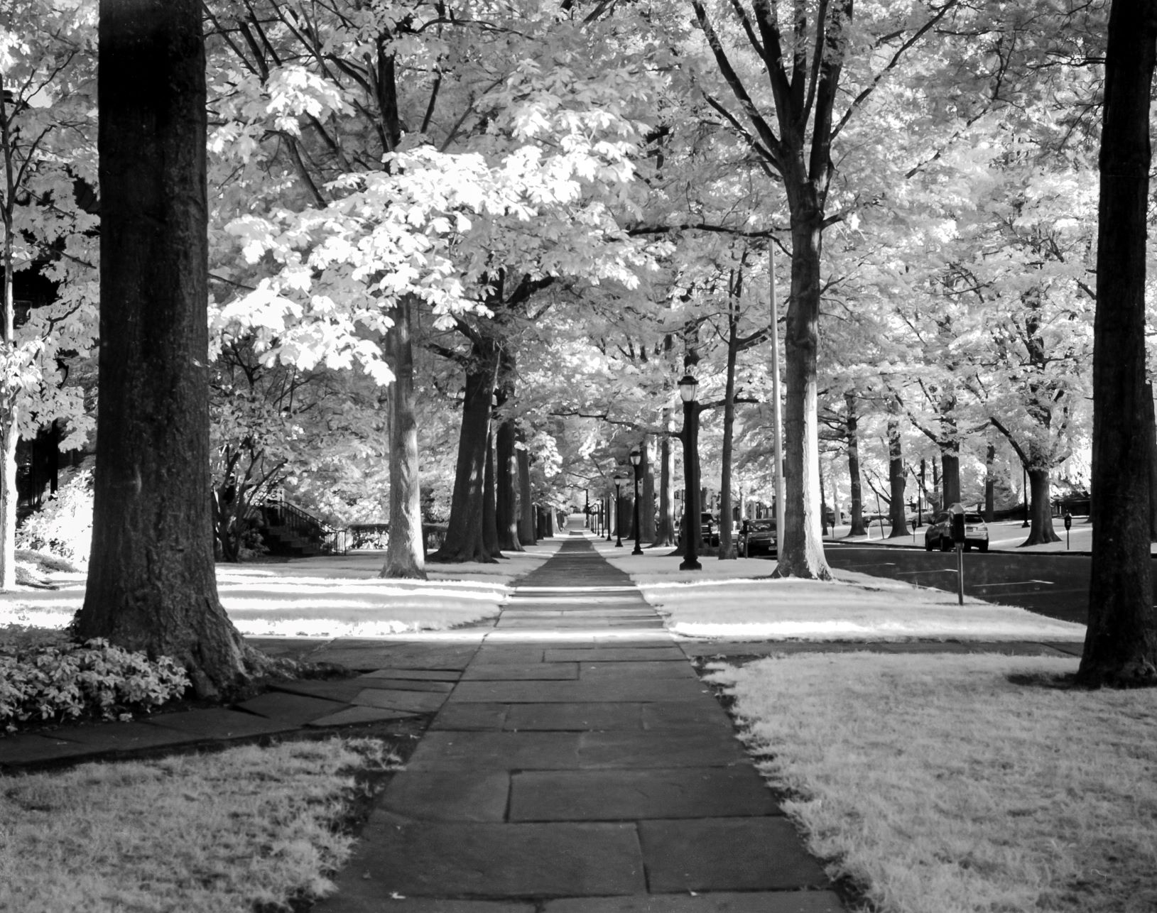

Recently picked up a Chroma Snapshot 4x5. Decided to test it with a sheet of Rollei IR 400.

I'm going through old posts to learn more about IR film, and I find this photo of the street I work on. What are the odds?
Edit: Now I'm starting to doubt myself, but it looks identical. If so, the person on the right is going the wrong way down a one-way street.
