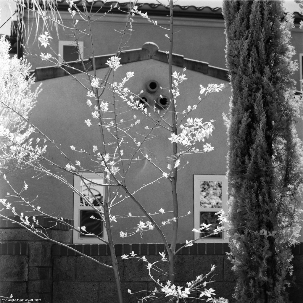

Ok, I was typically f11 @ 1/8th of a second. So maybe stop and a half different. I was going for DOF, but since I am finding focus is not an issue (I did not use any IR focus mark/adjustment, which is not present on the C330f anyway), next time I can open up more.

I have been using an effective ISO of 6 with the 720nm filter on. To Sunny 16, it may be more like ISO 16 (i.e., f11 at 1/8th). So somewhere in that range. What is the filter factor? 20? not sure a filter factor is really accurate (nor is my guessing).

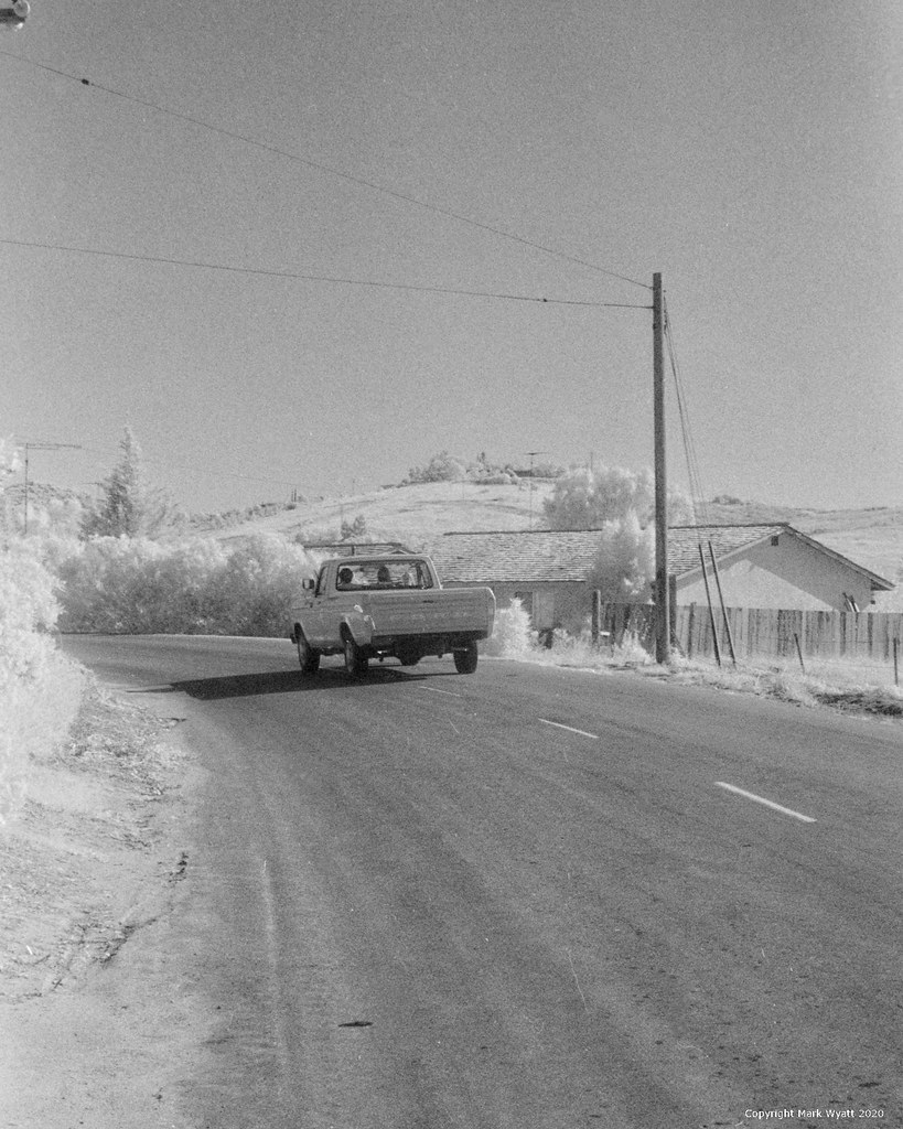

The same scene, on SFX, photographed with my C330 metered at box speed without filter, and with R72 filter and two different exposures - six stops more and nine stops more.
and two more scenes with from the same location, on the same roll, with the R72 filter and appropriate exposure adjustments:

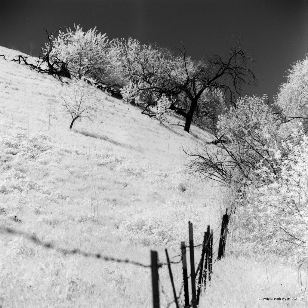

filter factor =5 (25 A = 8 filter factor) or 5 stops = 32 filter factor? What I used is effectively to 6 or 7 stops (or 64-128 filter factor). I am not finding R72 filter factors on Hoya or any websites. I found one unofficial listing of filter factor=20 to 40 .
I did not make this up, but checked to see what worked with other photographers on Photrio and Flickr, and back calculated filter factors as a check. It made sense that the filter factor for R72 should be higher than 25A, I think. I just found it easier to use effective ISO around 6-16 with the filter on. You end up in a very similar place.
In this image, I did lose a little in the highlights, but also in the shadows and the flat black fence (not surprising). The normal parts of the image (i.e., non- vegetative, NIR reflecting) have very normal looking densities. The negatives are not dense (nor thin).
