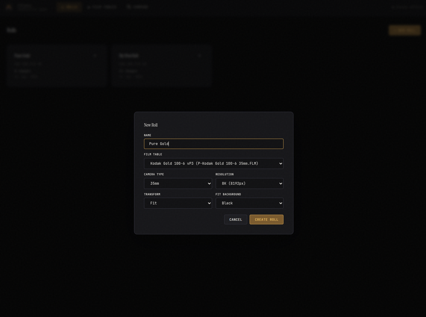

Just working on a small standalone print server that directly attaches to the scsi port of the ProPalette8000.
No more XP, RasterPlus, CFR needed.
Only a web browser required. First test roll is just drying and looks fantastic 🥳

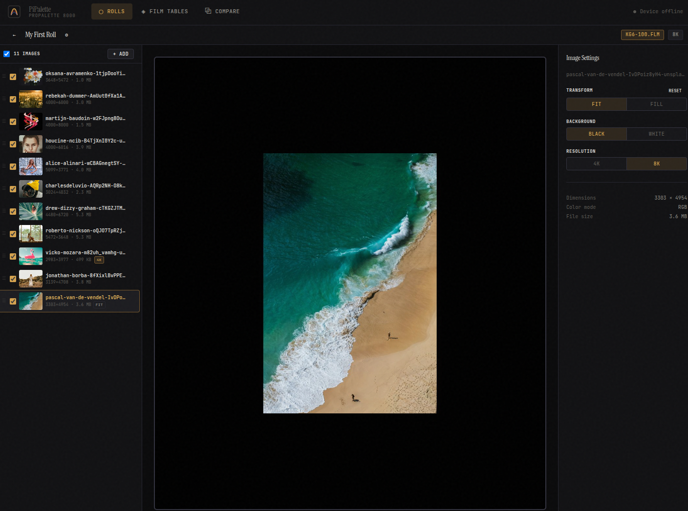

Create multiple film rolls on server side storage...
Arrange, transform, .. the roll and save for later or process directly

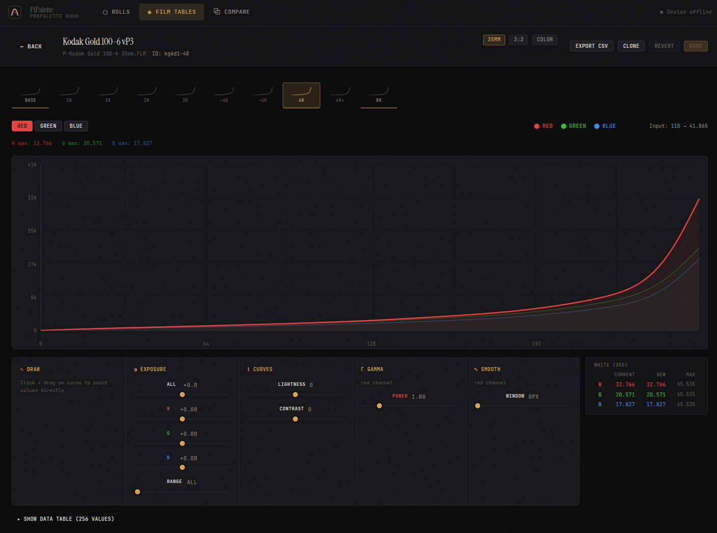

Create, modify custom lookup table ...
That looks amazing! Is the code for this available?
