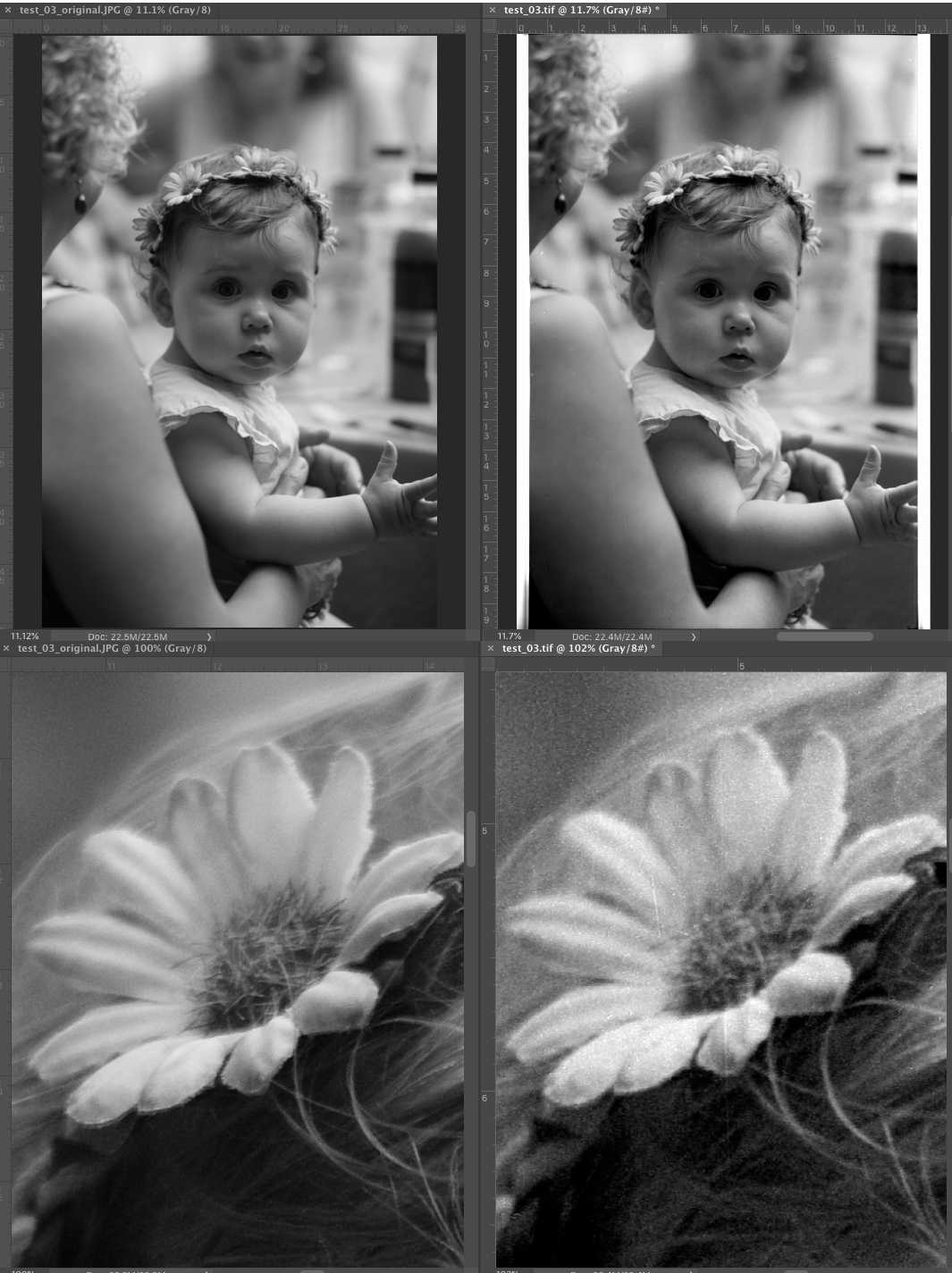

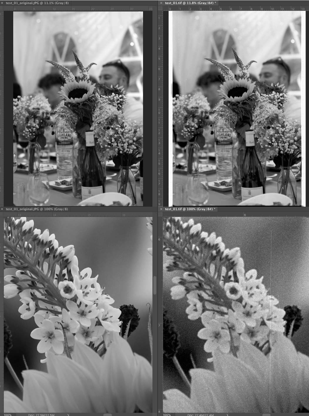

It's still early days for me in terms of testing, and I've only really focussed on B&W images, but here's a couple of test outputs to be going on with.
The original of both images is on the left, including a blown up detail, while the output file and detail are on the right. The original image files are 5976 x 3992 pixels greyscale JPEGs from a Leica M262, which have been output at native resolution using the ProPalette 8000 onto 35mm Ilford XP2+, which has then been lab processed and scanned with a Nikon Coolscan 5000 at 5782 × 3946 and then Levels adjustment applied in Photoshop to match the original JPEG.
Next experiments will be to check the the role played by the contrast of the original file going in, and also the different film types that can be used, including fine grained film like RPX25.
I think that's pretty remarkable - given that this is only 35mm film, so not all that much space to work with, and a machine from the, what, late 1990s?
