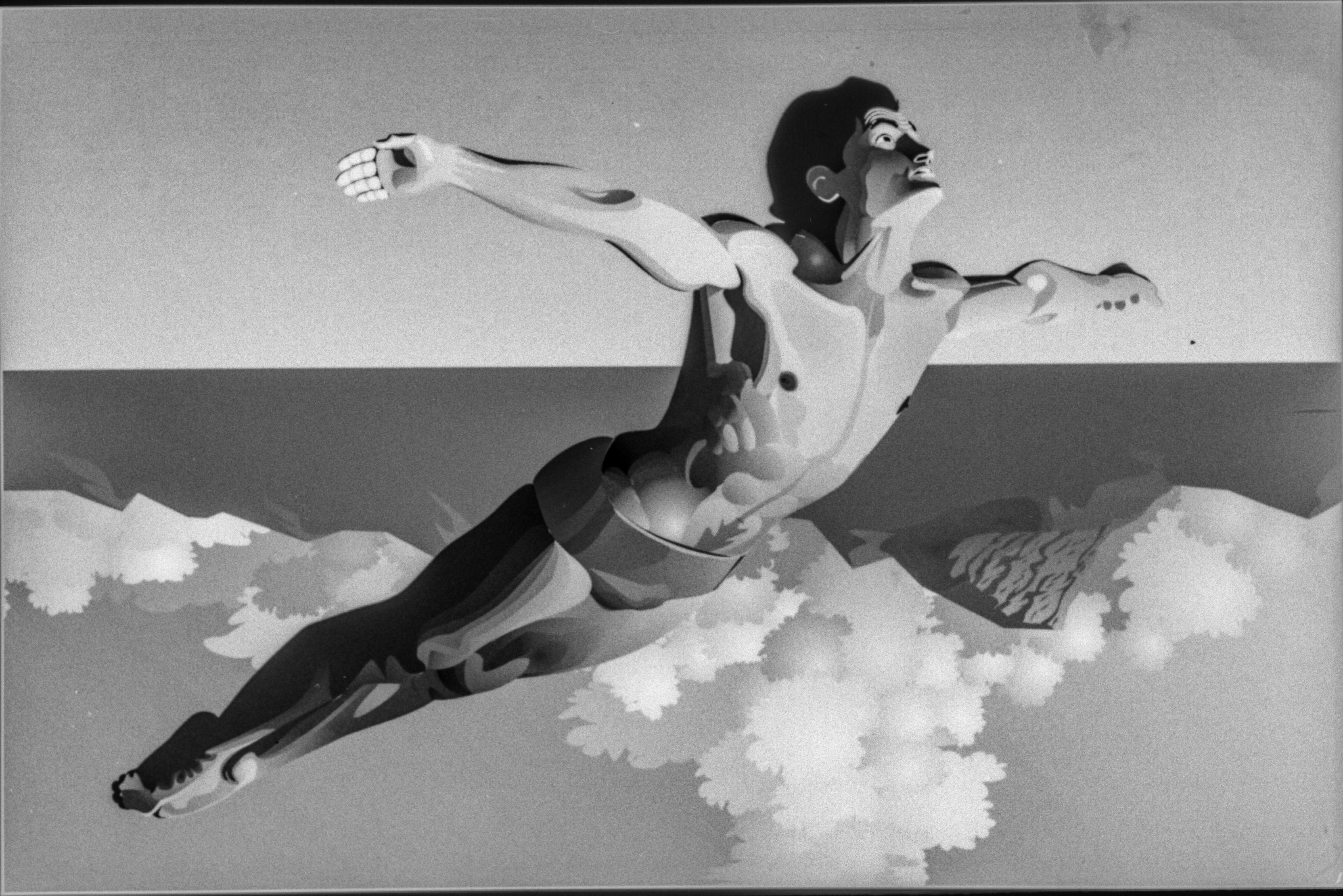

Can anyone with an HR6000 upload some film scans?

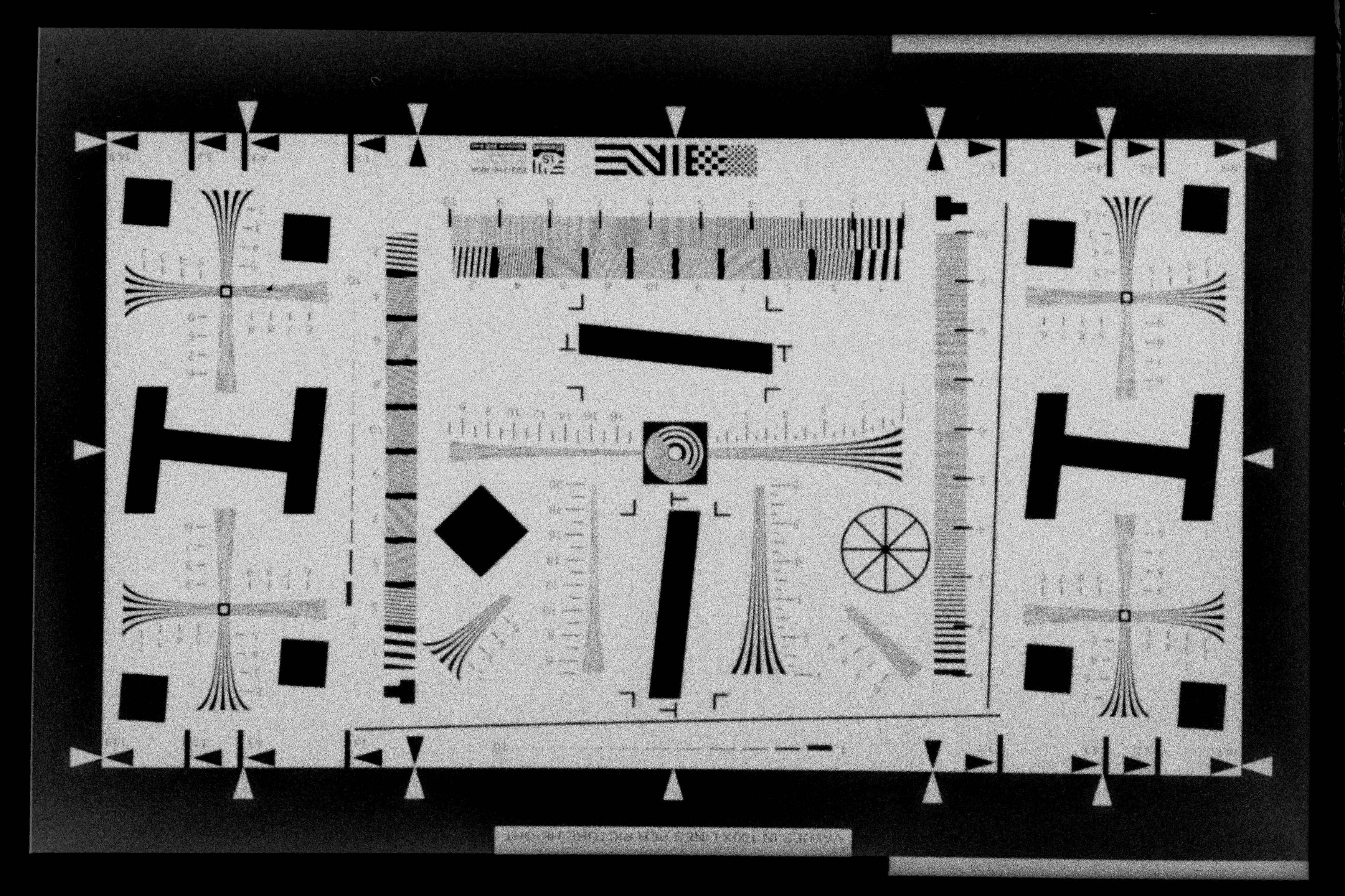

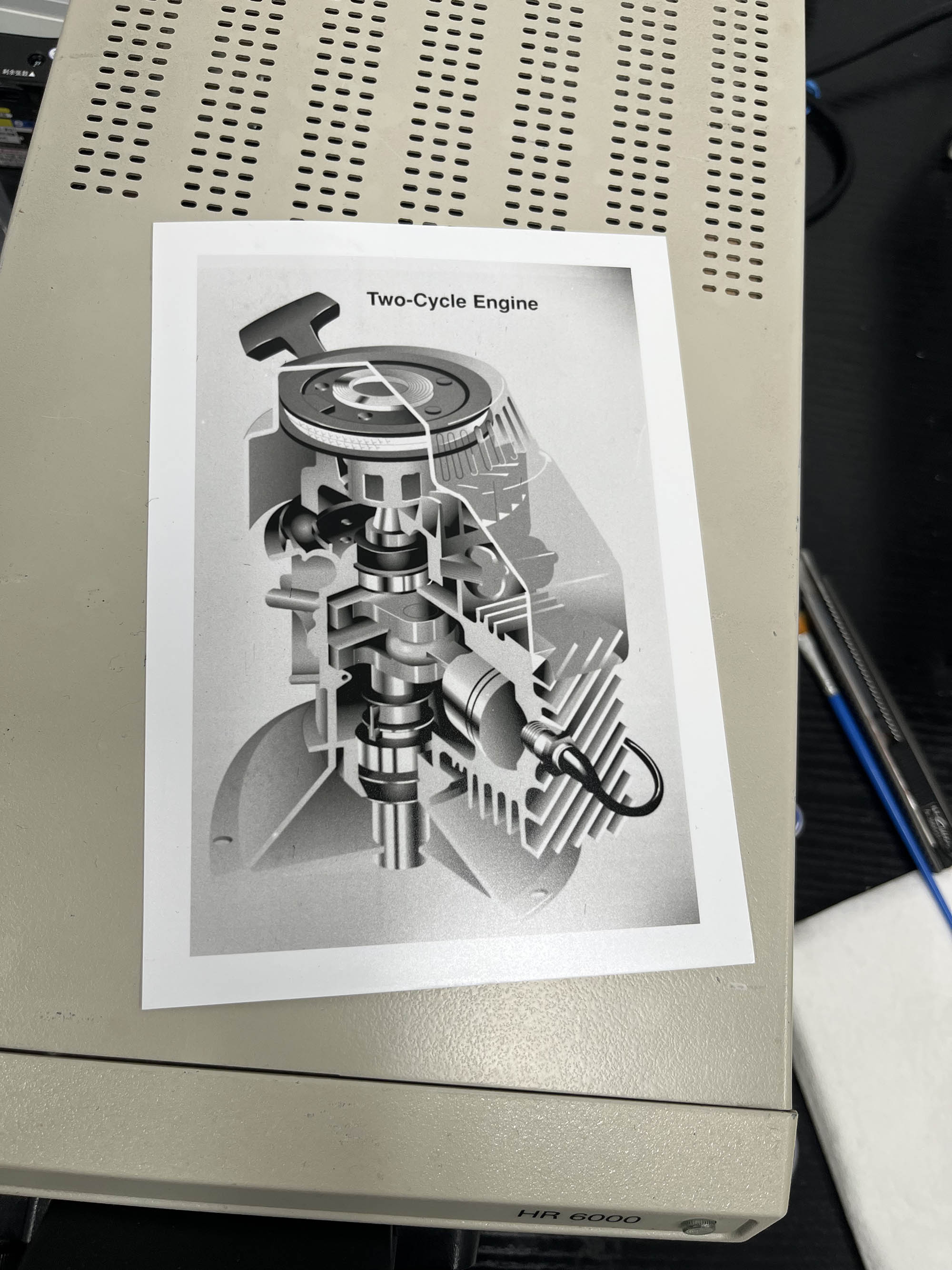

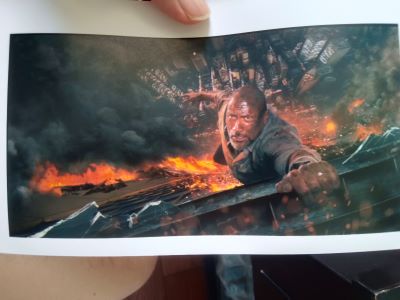

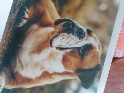

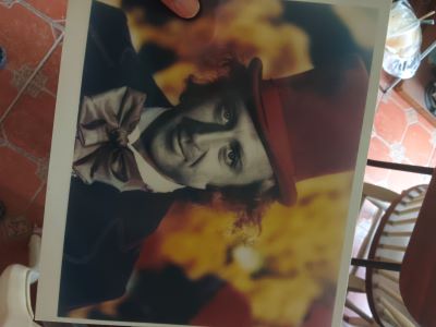

I just bought an HR6000, but I'm a bit skeptical about its sharpness. I printed out a resolution chart and some test images, and the sharpness is poor. I can only accept such negatives enlarged to 5x7 paper.
Is this the performance of the HR6000? Or do I need to calibrate it? (eg optical focus, CRT focus adjustment collimation)

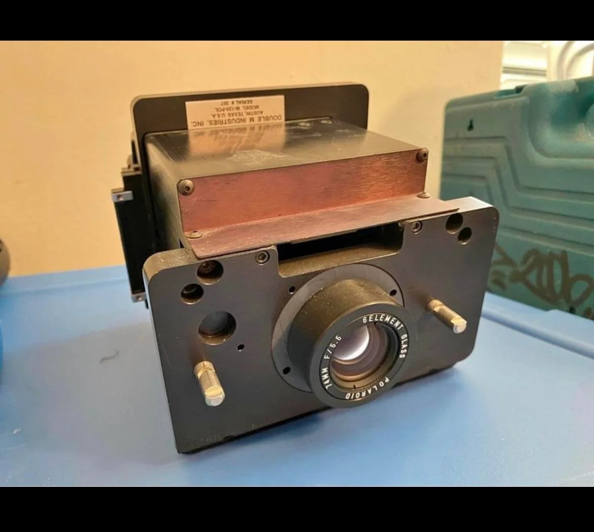

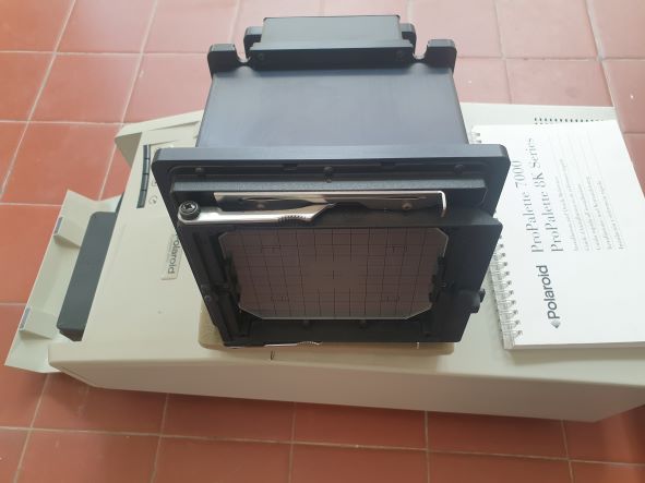

The 4x5" adapter was based upon a standard large format film back that had been adapted and fitted to a interface box for the film recorder, and would generally have been used with standard dark slide cut film holders.

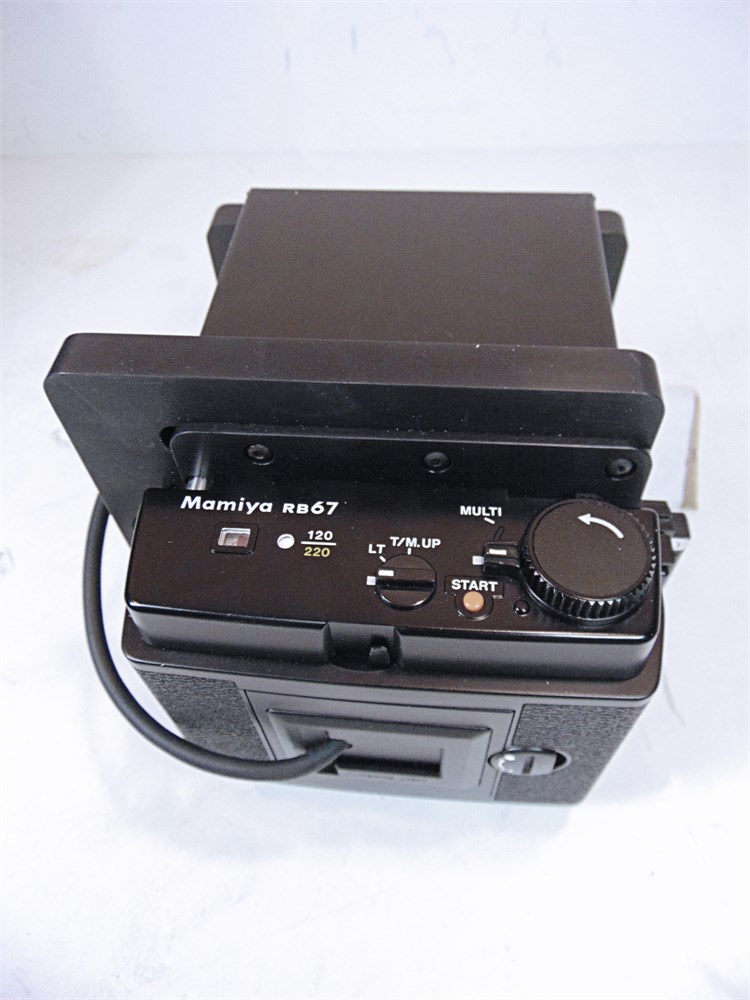

The 6x7cm film back was based on a Mamiya RB67 motorised magazine adapted to take trigger cues from the film recorder.
Both film backs had their own format-specific lenses which imaged the CRT onto the film at the right scale, and they were manufactured for Polaroid by a company called Double M Industries of Texas which closed many years ago. I believe that an alternative 6x8cm adapter was also made by a company in Germany.

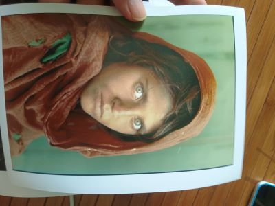

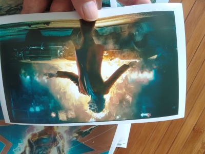

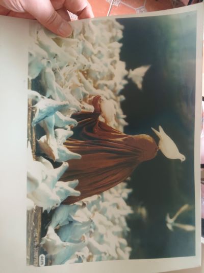

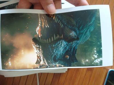

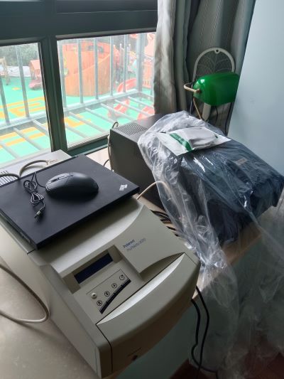

I used this monitor to enlarge color or black and white digital pictures before, but the contrast was not good and the colors were not perfect.
But after I bought the 8000, the color contrast was balanced and the colors became full and bright.

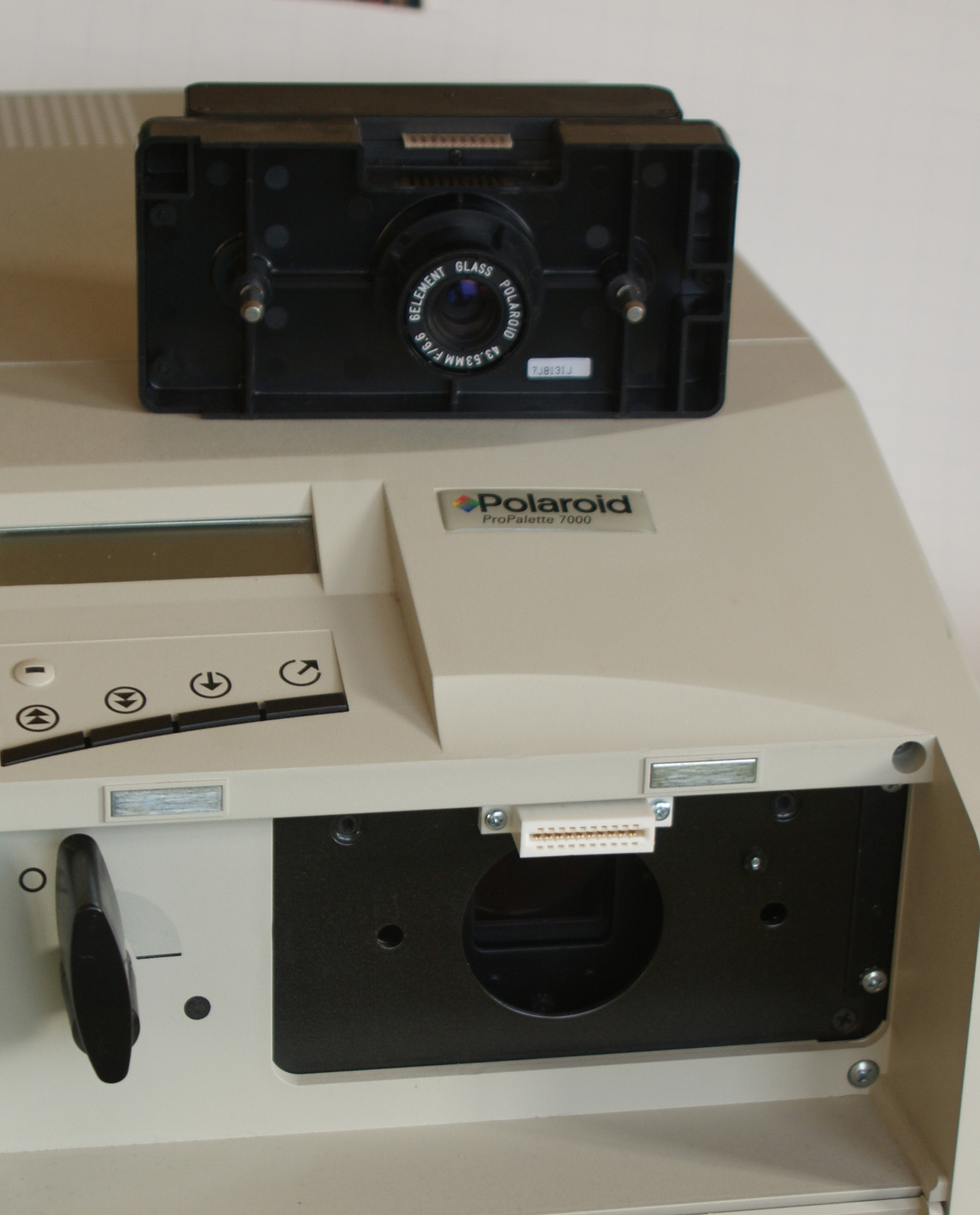

Physically you could probably fabricate a 3D printed enclosure/film holder with suitable locking pins, but I think the main challenges would be the optics and the interface.
The various film backs have lenses with different focal lengths, e.g. the 35mm back has 43.53mm lens, the 6x7 back a 74mm lens, and the 4 x 5 back a 101mm lens, and these need to be set to precisely image the full width of the CRT onto the maximum area of film, meaning that you'd need to find a lens appropriate to the film format which you could adapt.
The other issue would be the connection with the film recorder as the film backs all have a PCB edge plug above the lens that interfaces with a connector on the main unit, and which presumably tells the film recorder what type of back is fitted and allow it to control film advance, etc.
So not impossible, but far from straightorward.

If you've got a 35mm back then you're at least in a position to determine the physical interface, including the connector location and contact spacing. The lens might be something as straightforward as a scanner or enlarger lens - you'd want something with good flat field charateristics. Electronics I don't know - the 4x5 back might be something as straightforward as having a couple of contacts linked back to ground - there's no advance after all.
Of course, I would have preferred it if a 4x5 back had been included with the purchase. Finding that on its own seems difficult...

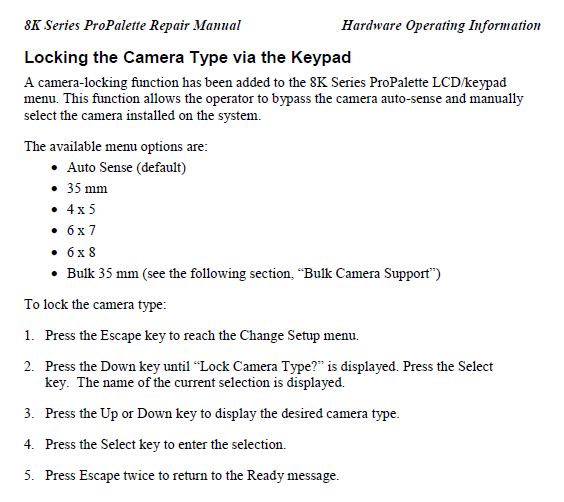

I just had a look in the service documentation I have for the 8K and it looks like you can bypass the auto-sense function and manually set the type of camera / film back installed using the menu system - see below.
That could mean that you'd be able to omit the connector and only address the hardware and optical setup if you wanted to make your own 4x5 camera back.
8K Series ProPalette Repair Manual
Locking the Camera Type via the Keypad
A camera-locking function has been added to the 8K Series ProPalette LCD/keypad menu. This function allows the operator to bypass the camera auto-sense and manually select the camera installed on the system.
The available menu options are:
. Auto Sense (default)
· 35 mm
. 4x 5
. 6x 7
. 6x 8
. Bulk 35 mm (see the following section, "Bulk Camera Support")
To lock the camera type:
1. Press the Escape key to reach the Change Setup menu.
2. Press the Down key until "Lock Camera Type?" is displayed. Press the Select
key. The name of the current selection is displayed.
3. Press the Up or Down key to display the desired camera type.
4. Press the Select key to enter the selection.
5. Press Escape twice to return to the Ready message.

Ok. Thanks. You must do it in Rasterplus or on the device?
Ok. Thank you.

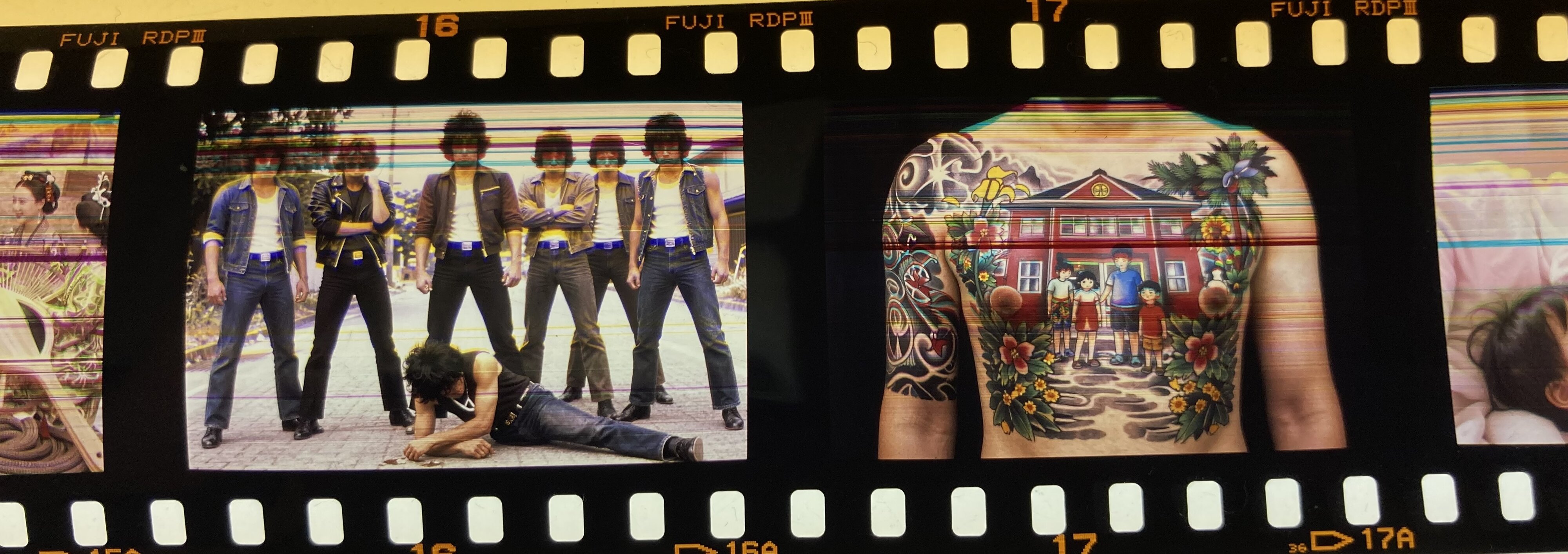

Hello,
I have now managed to find a Polaroid Palette 7000. Unfortunately, it has a few problems. The exposure and sharpness look good. However, it produces coloured stripes and glitches in the images. Does anyone know what could be causing this?

If you google “propalette service manual” the first two links that pop-up (at least for me) are links to the PP7000 and PP8000 Repair Manuals on the Internet Archive, so it would be worth grabbing those anyway. You’ll need both for your 7000 as the manual for that device is an addendum to the 8000 manual.
EDIT - some links to the manuals, first for the 8000 and then the 7000:
These manuals have some diagnostic tables in which may be of help at some point, but my initial instinct would be to check what you can with your software and connections, particularly things like whether you have a defective cables, or whether your SCSI addressing and termination is good. As you’ve noted, the images are sharp and well exposed, excepting the colour glitches, and so it may be some type of data flow error from your computer or software. I believe there are some “pacing” settings that can be varied from the LCD control panel on the front of the machine which might help in this respect.
Also, do you have the same issue with black and white, or have you only tried colour? Have you optimised your file sizes for the machine, and what file format are you using to feed Rasterplus? Also, have you tried it with a Mac instead of a PC, or visa versa? For example, I have my 8000 connected via SCSI to a Mac which has the bare minimum of software on it required to run only the imaging process - no other applications, nothing else running in the background, no network, etc.
Good luck, and keep us informed as to your progress.
