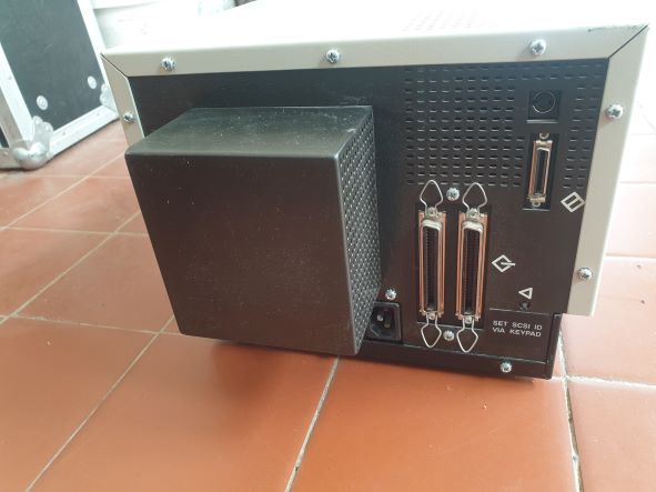

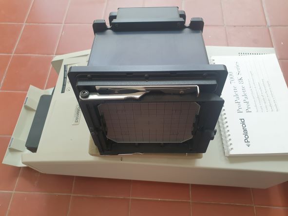

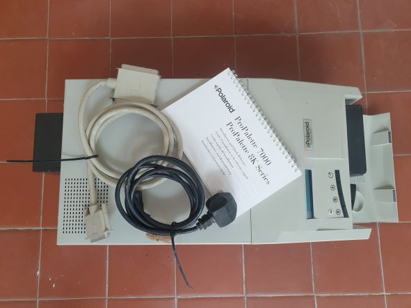

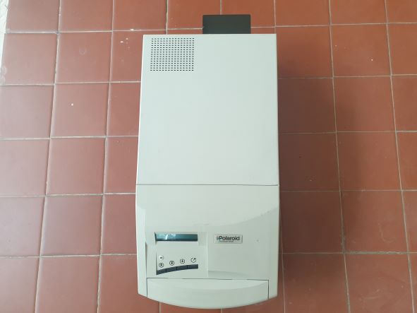

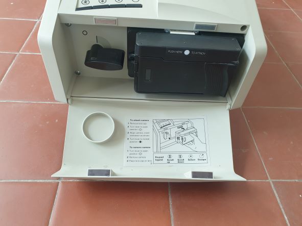

Hi, yes I have one and I am based in west London. I am not near it right now but I will take a look and send you some pics when I can in the next few days 🙂
Hi clift_d, I have dug it out of storage, and it is working fine. I have two cameras that would come with the Propalette - a standard 35mm and a 5x4 camera as I used to make my own 5x4 trannies for projection use. I never used the 35mm camera but I always kept it in position in the unit when not in use. I still have the scsi and power cable in the box also. Here are some pics. Let me know if you are still interested. Thanks Julia
