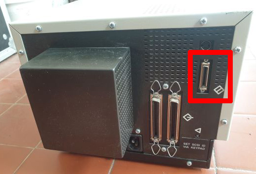

The ProPalette does have a Printer Port (see attached image), which looks like it could be a 36 PIN mini-Centronics connector, although don't hold me to that. If you can only interface with your PC through its LPT1 socket then you will need to find an adaptor cable to go that. You should also be aware that outputting to the PP8K via a Parallel connector is likely to be slower than SCSI, so in the end it might be easier to find either a compatible SCSI card for your 'new' computer, or another old PC with SCSI already fitted.
You're right, my apologies. It's also mentioned in the repair manual:
ProPalette 8000 has four ports (Figure 1-2):
· Centronics parallel
· Synchronization IEEE 1284 style (supporting firmware not available on early units)
· SCSI-1
· RJ-11 serial (available to service personnel only)
